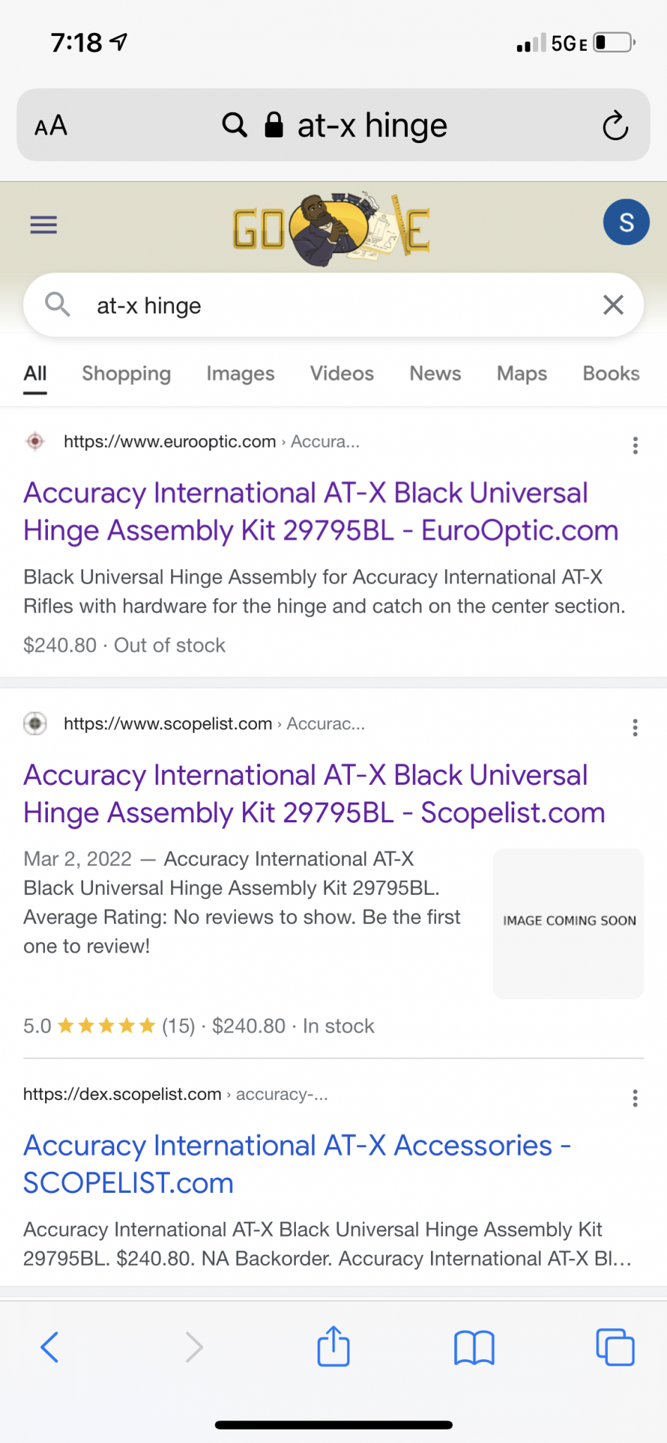

    Hey! Where da hinges at ?
    And can we get torque wrench’s to the factory ?

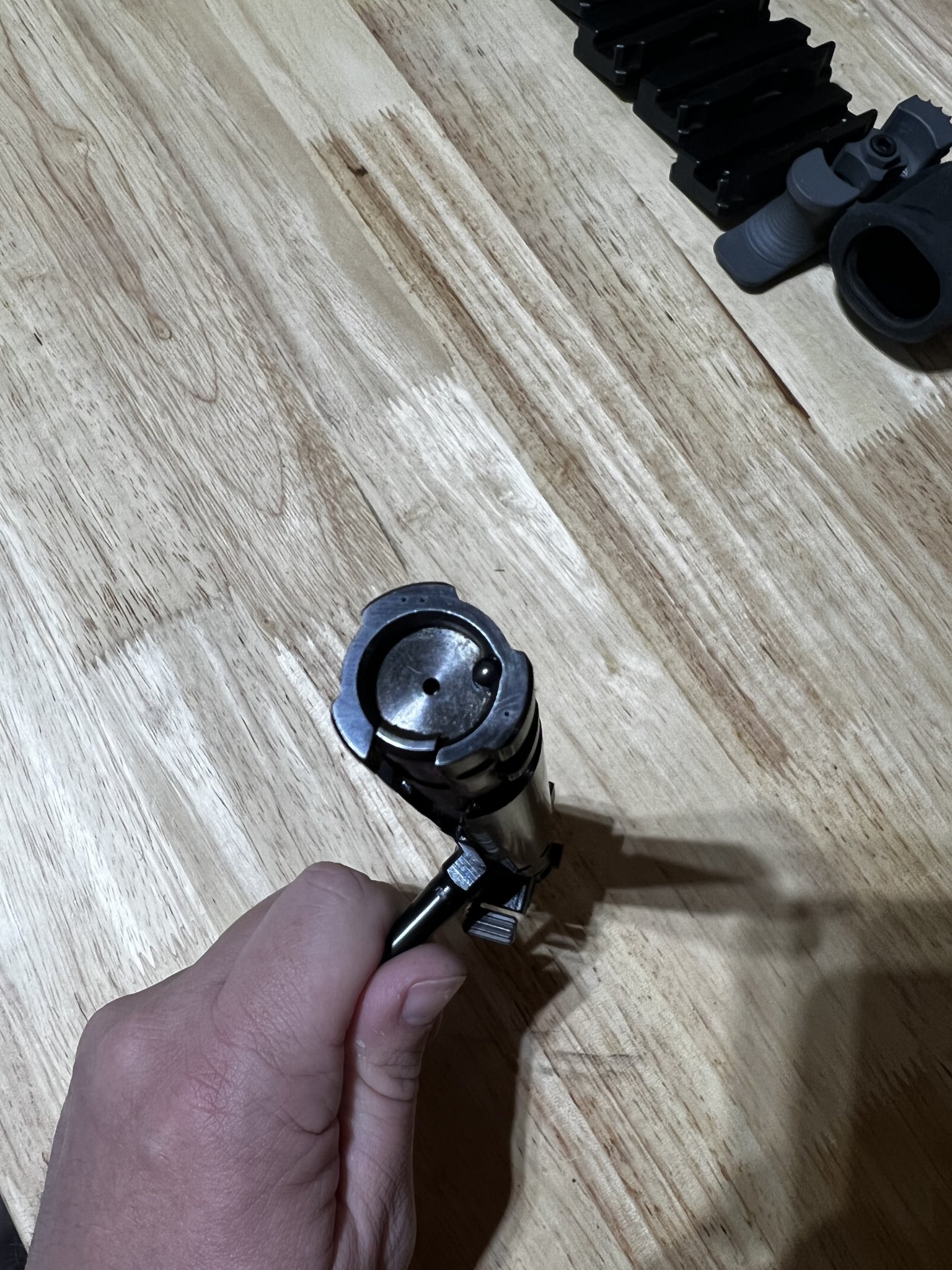

    This is a pic of a 6.5CM in the mag. This is the 1st round of 10 when spring tension pushing up is at its greatest. You can see how little bolt to brass connection there is.
    Thanks Timo, that is exactly what mine looks like. Will be onto the dealer tomorrow. After waiting nine months for the rifle and now dealing with this, I'm really angry. I hope someone from Accuracy International is reading this. Producing shit like this when folks have put down big money and waited long lead times is beyond unacceptable.

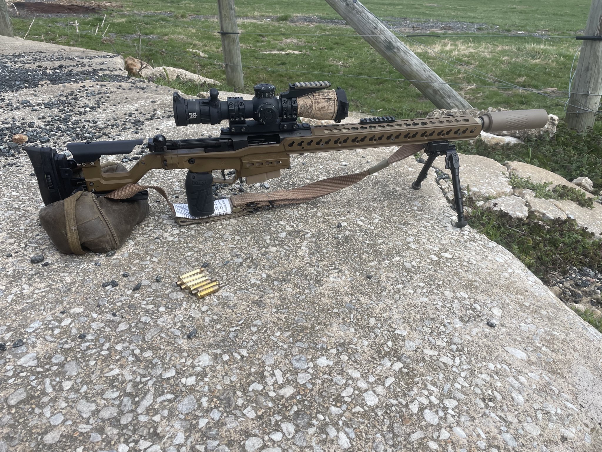

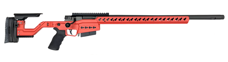

    My blue and red.

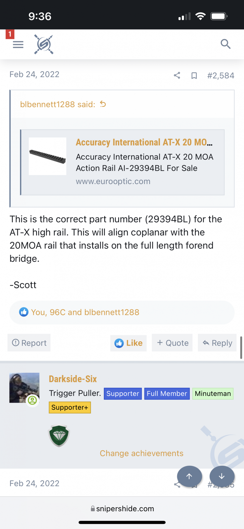

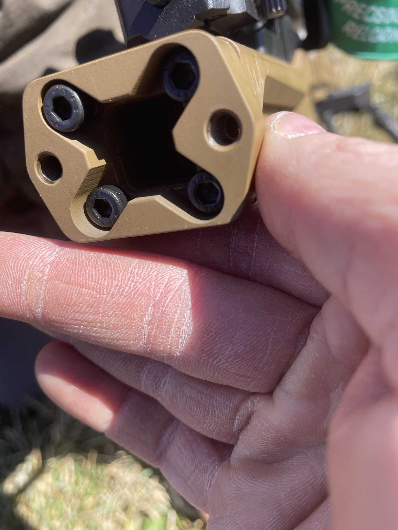

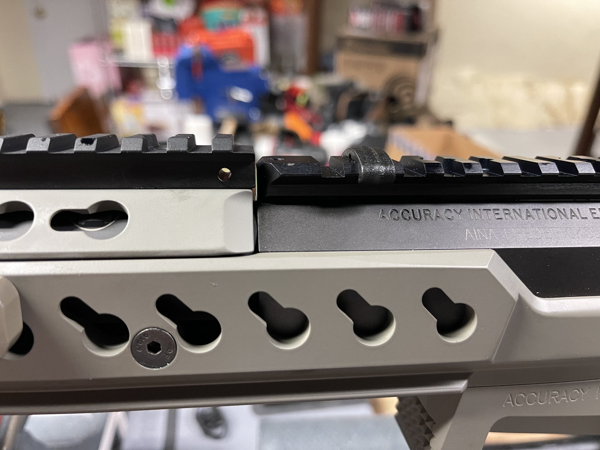

    Ok guys, just put the forend rail on mine. What have I done wrong here? Do I need part number AI29394 for the action rail?
    And anyone know the torque specs on these parts?
