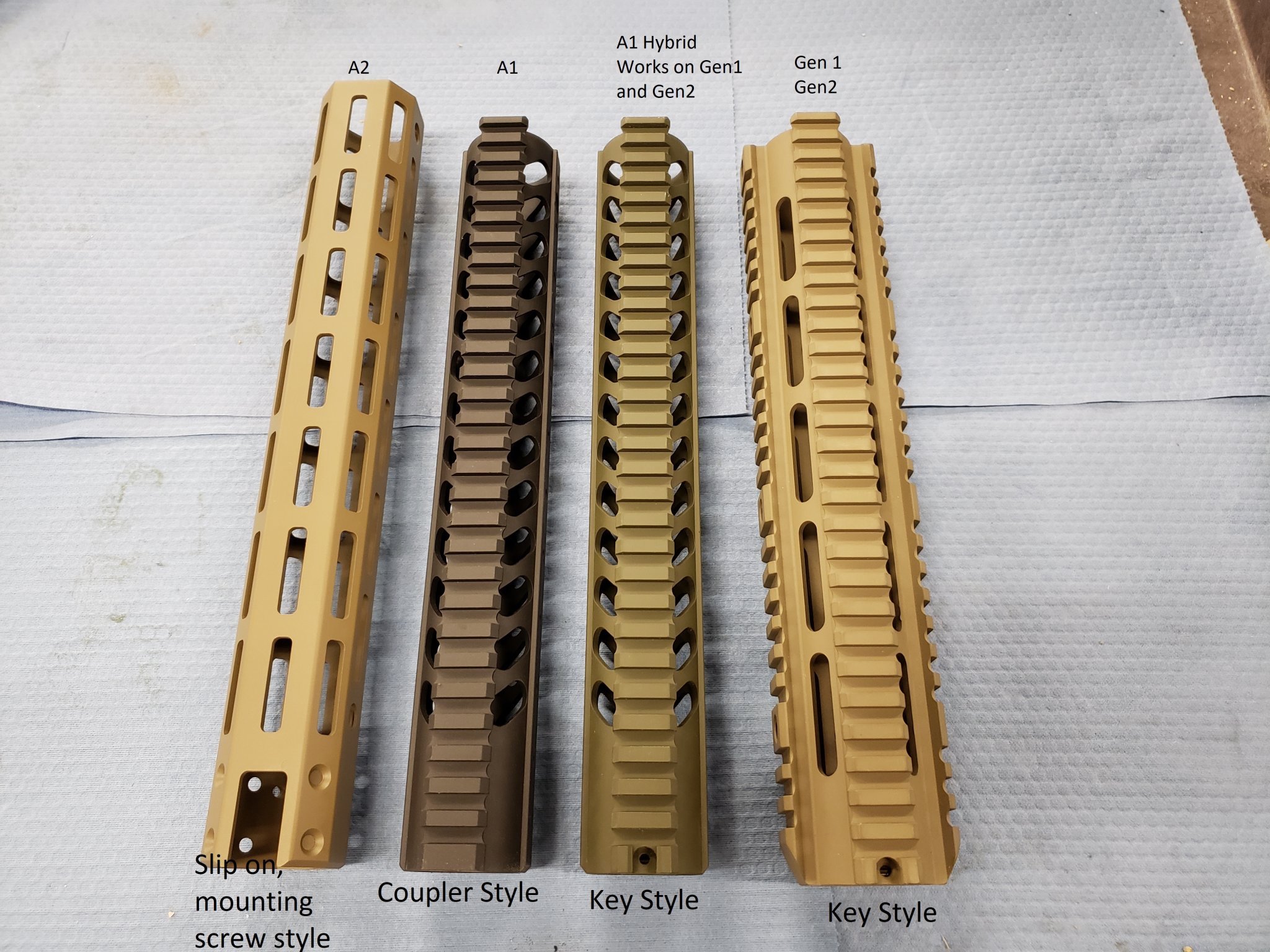

Hey guys still getting a few questions on what key style means, how to identify, etc. Hopefully this photo can clear up any remaining questions you folks may have.
I'm changing out the handguard, and the instructions don't say anything about the use of any grease on the coupler - I am under the impression anytime there is friction between 2 different types of metal, gauling can occur. How is the setup any different that a barrel nut on an ar?
Look up Galling on google. (Gauling is going to france.) You'll find lots of info on what is actually happening. Aluminum is a metal that does tend to gall and if the anodizing is removed through breakage, friction or anything it will expose nice clean fresh aluminum which is a candidate for galling. Threads are prone to all sort of issues because of how they work. An anti-seize compound is a good idea. I prefer nickel over copper because it is less likely to cause corrosion in the joint. Plain grease is better than nothing but not by a lot. For anti-seize compounds, Graphite (more corrosion issues like copper. look up galvanic corrosion) Copper or nickel are good to use.

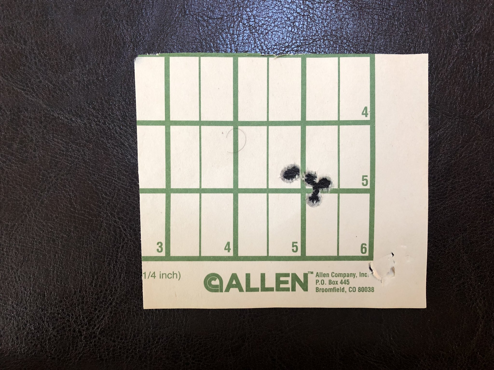

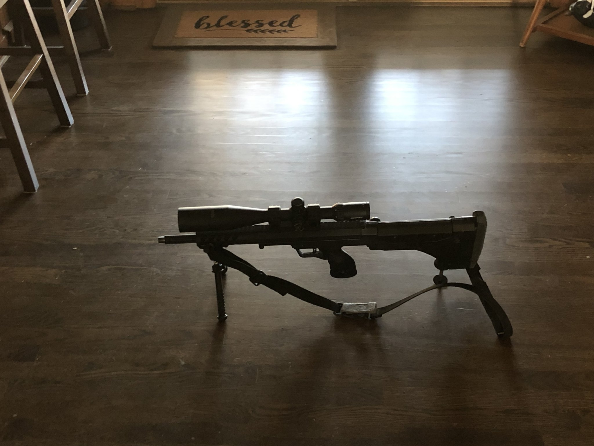

Finally got to shoot my 6.5CM A1 today. It’s a frikkin laser beam.
First pic is 5-shot group
2nd pic is running it as fast as I could

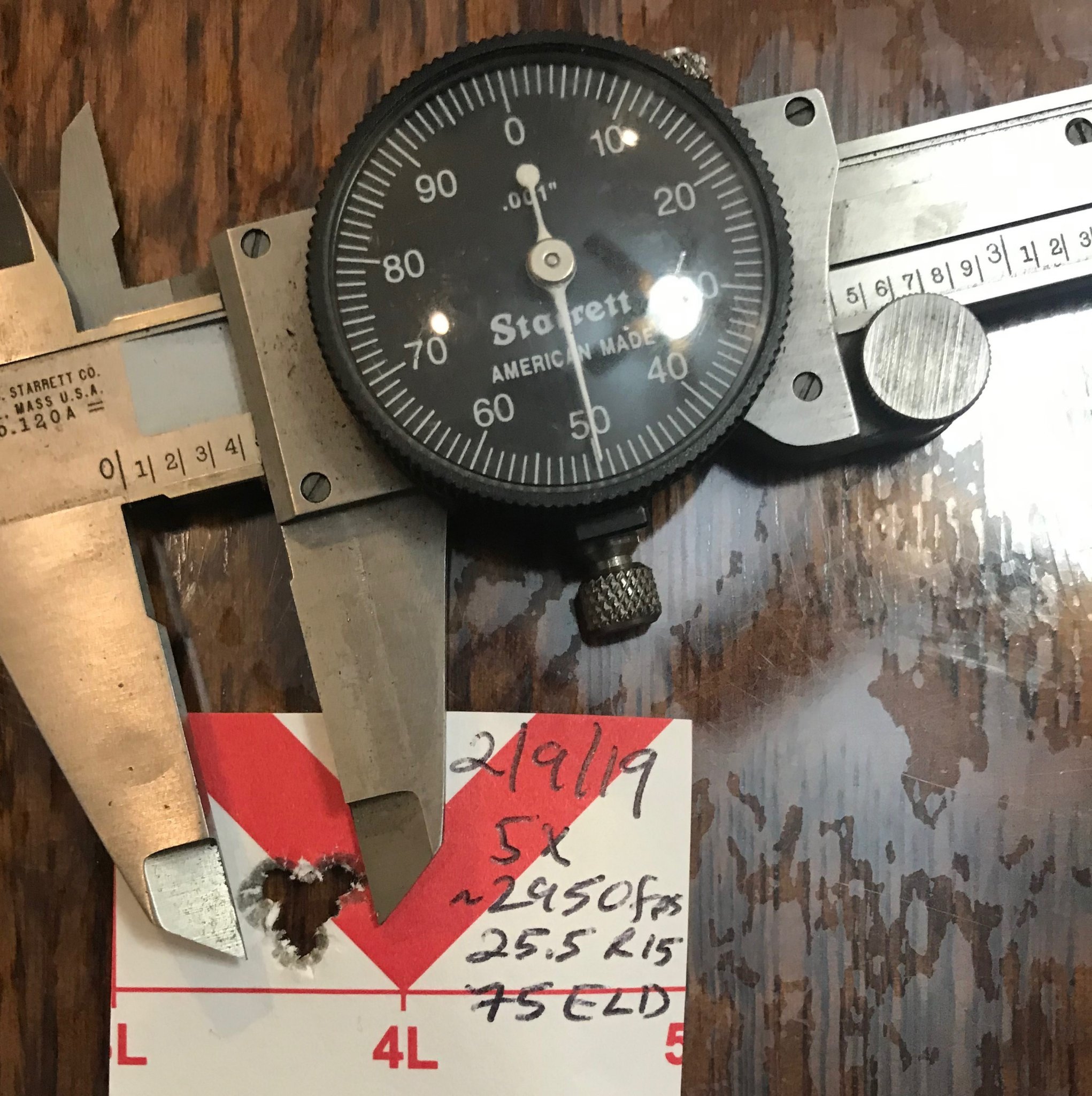

What’s your load details? I have a 223 conversion on order from them
75 ELD and 25 grains RL 15 loaded to 2.490” in Hornady brass. Full case, almost max
Load. Would be over max in Lapua case I’m guessing. 2950-3050 depending on factors
Including temperature, which I don’t sweat because it’s an 800 yards and in gun.
