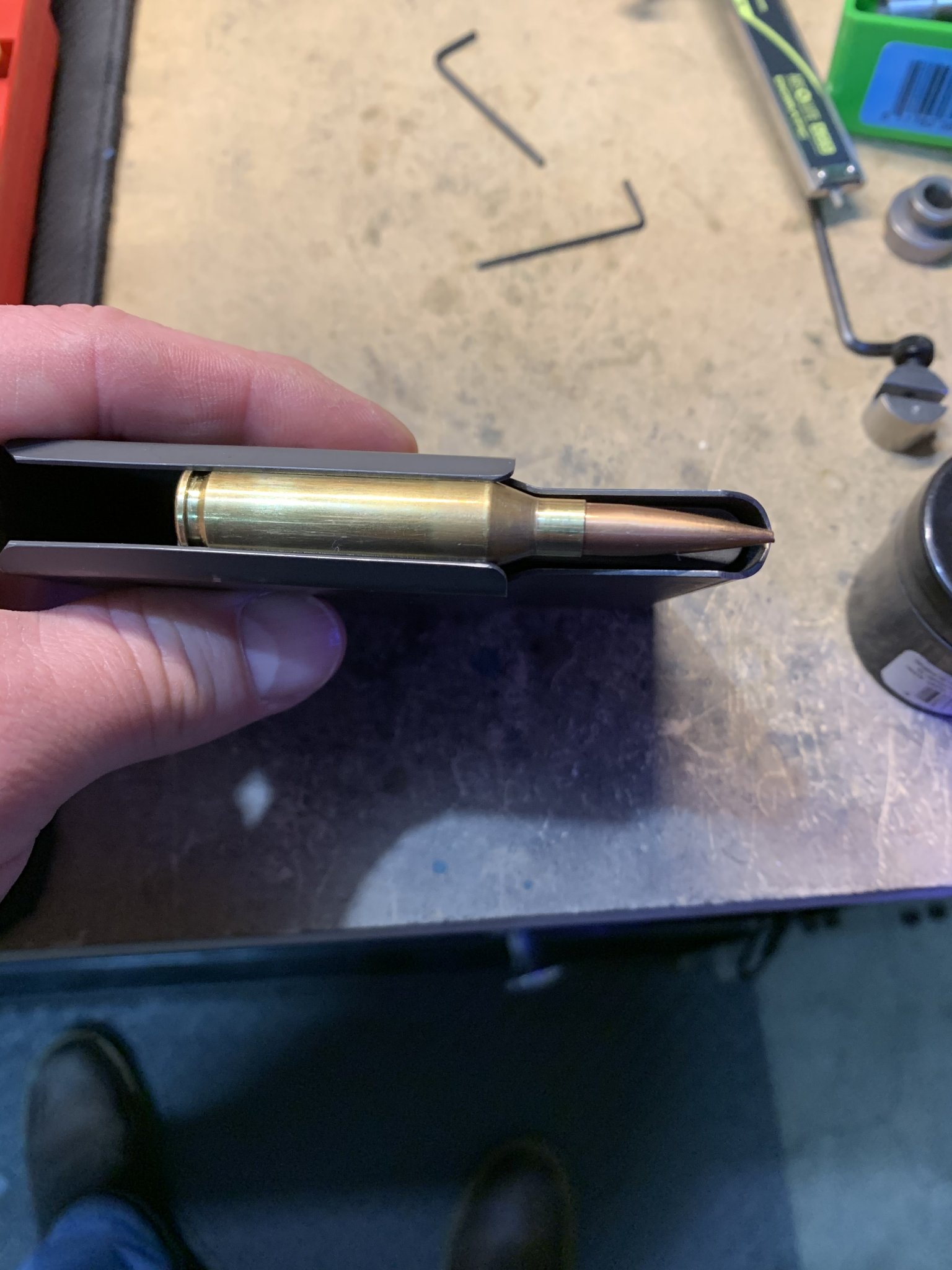

Need help with my magazine on my SRS A-1. Running a TS customs 260 barrel. My problem is the magazine. It will only allow me to run the Berger 140’s at 40 thou off. I want to try and run them closer, like 10-15 thou off. I’d like to get a magazine that’s a little bit longer that would allow that. Any advice on where to get one? Should I look at another caliber magazine possibly that would work?

Wow I have never seen a DT magazine be to short to get close to the lands. That would be a first for me. Did you specially request it cut longer than normal?

Get in touch with short action customs, they can probably take care of you with the modified mags they are doing.

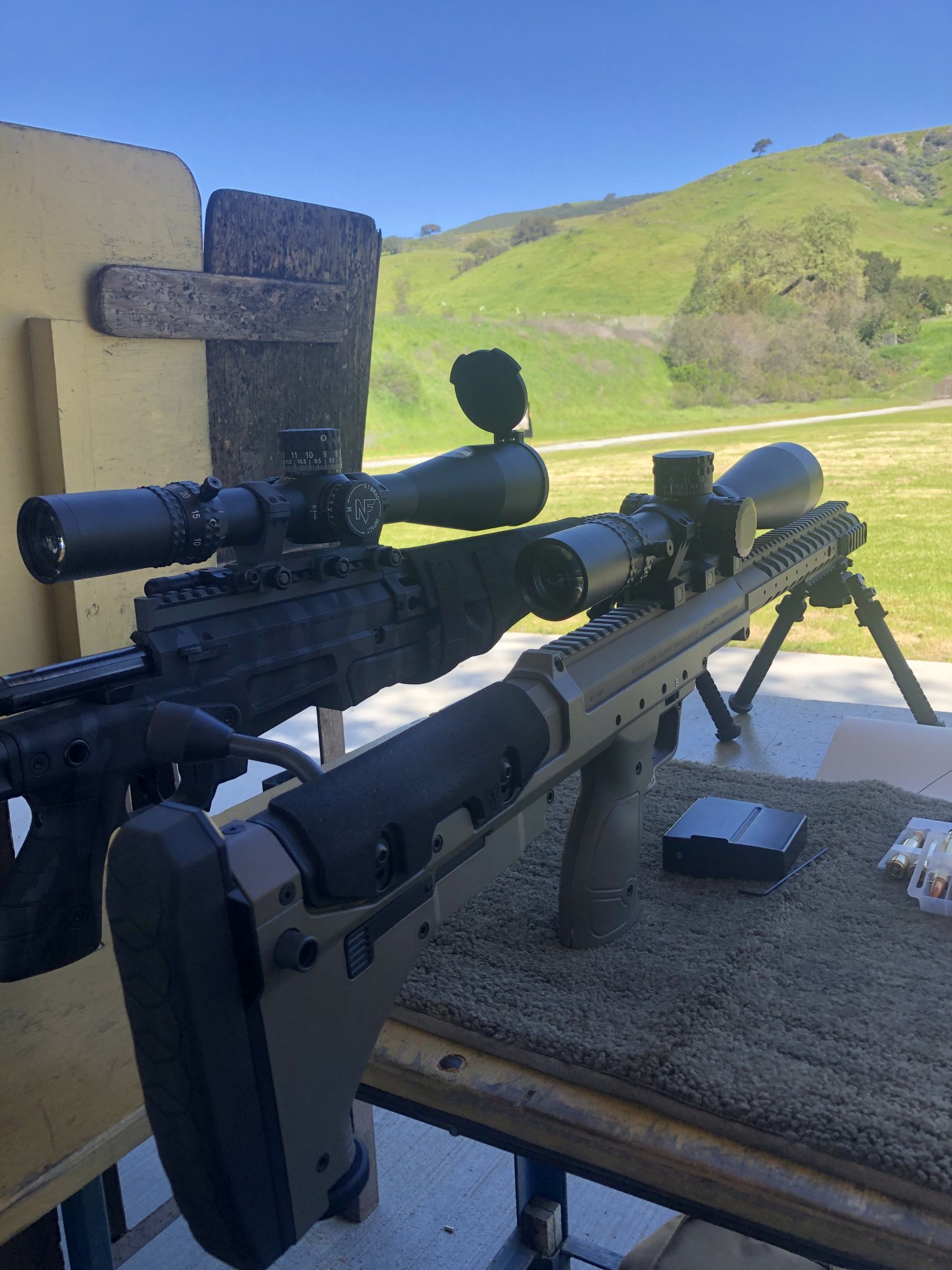

Finally got my 16" barrel! I have been wanting to have the option to convert my A1 to a lighter weight covert ever since I bought this rifle last year. I traded into a covert handrail and bought an unfired 26" Special Purpose Rifles 6.5x47 conversion here on the hide. I sent it over to Mark at SAC to cut it down to 16", thread it and time a TBAC break and give it deep flutes on the barrel and shank to cut as much weight out as possible. After receiving it I sent the Handguard, mag and Barrel to Daniel over at Primal Finish to match the Mirage Cerakote I already had on the rifle.
Mark at SAC did a fantastic job, after cutting the barrel down he weighed it before cutting the deep flutes after fluting he said it cut off .55lbs. I weighed the barrel before sending it off and after cutting it down and flutting it went from 5.28 lbs to 3.68 lbs so it saved 1.6 lbs all in! The rifle with mag, scope, TBAC Ultra 7 and RRS rail went from 15.3 lbs to 13.1 lbs.
I can't say enough about Daniel over at Primal Finish his work is impeccable, the attention to detail and quality of his work is just incredible.
Here are a few pics.

I have the same issue with my 260 with the Berger 140 too. My barrel has about 2000 rounds though and when I set it for about 10 thousandths jump it won’t fit in the magazine. So I seat the bullet so it fits in the magazine, or about 30-40 thousandths jump with no ill affect on case capacity or accuracy.
Maybe that’s a solution for you if your barrel doesn’t mind it.

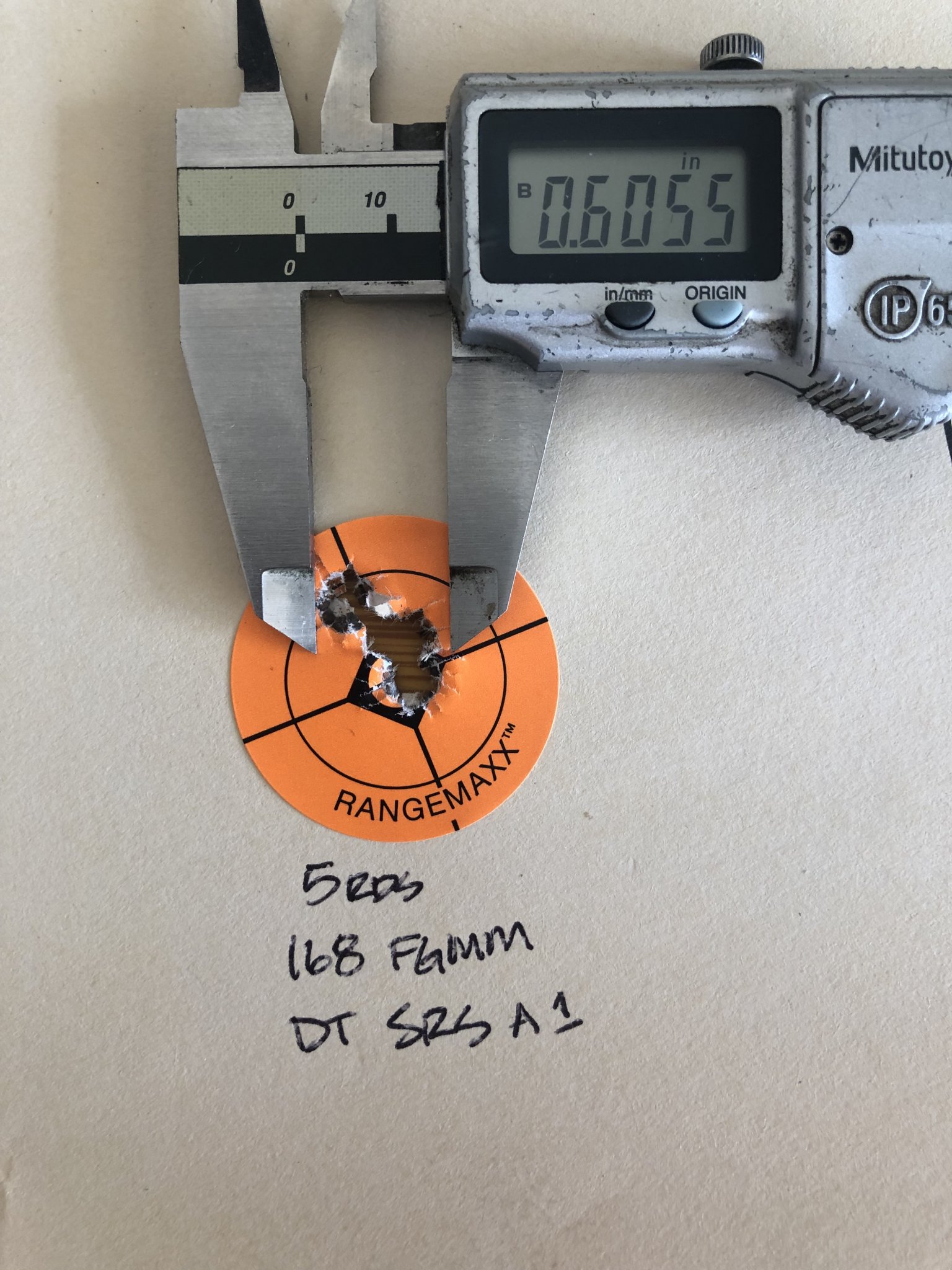

Finished an Advanced Precision Rifle week at Gunsite and then participated in my first ever LRPR match in Phoenix. Definitely a learning experience. Will be attending more around North Carolina. One stage I got a perfect score with a 3moa 5 shot group at 500y. I've never shot quarter moa at 100y before and was told this would be equivalent to shooting the same hole at 100. The rifle seems to exceed the accuracy that I'm currently capable of.
3 moa is not equivalent to quarter moa. 3" is a little over half moa at 500 (.6) maybe that's what you're saying - still solid shooting. But, regardless, sounds like you're having a big time with a fine rifle. Keep it up! I've never experienced any type of problem with light primer strikes and I have only disassembled my bolt once in about 800 rounds. But, I'd start with cleaning the bolt well.
