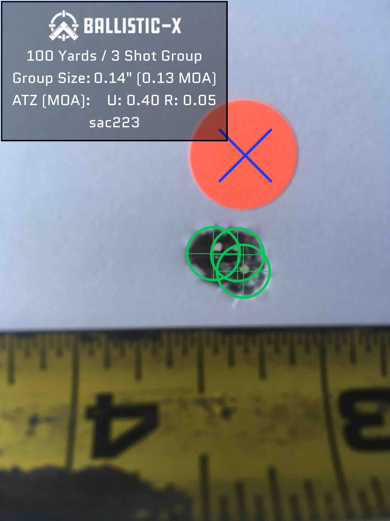

I am on the fence on a new A2 covert. I have the A1 in 308 which is now in 223SAC. And I am absolutely loving this set up. Mark has done such a great job. This thing is a laser with just about every thing I have put through it. I have not shot a group over an inch yet and that is with 55 to 90 bullets from PPU to Winchester Match.

Took the A2 for its maiden voyage this morning. Was on a time table so didn't get any pics or shoot to many rounds. Used M118LR, 2 rounds to zero scope then next three where half minute. Then cleaned barrel and shot a five round group that was just over half MOA. Buddy fired a five rounds of Hornady Superformance 168 ELD-M in one ragged hole. Will get it out to longer distance this weekend.

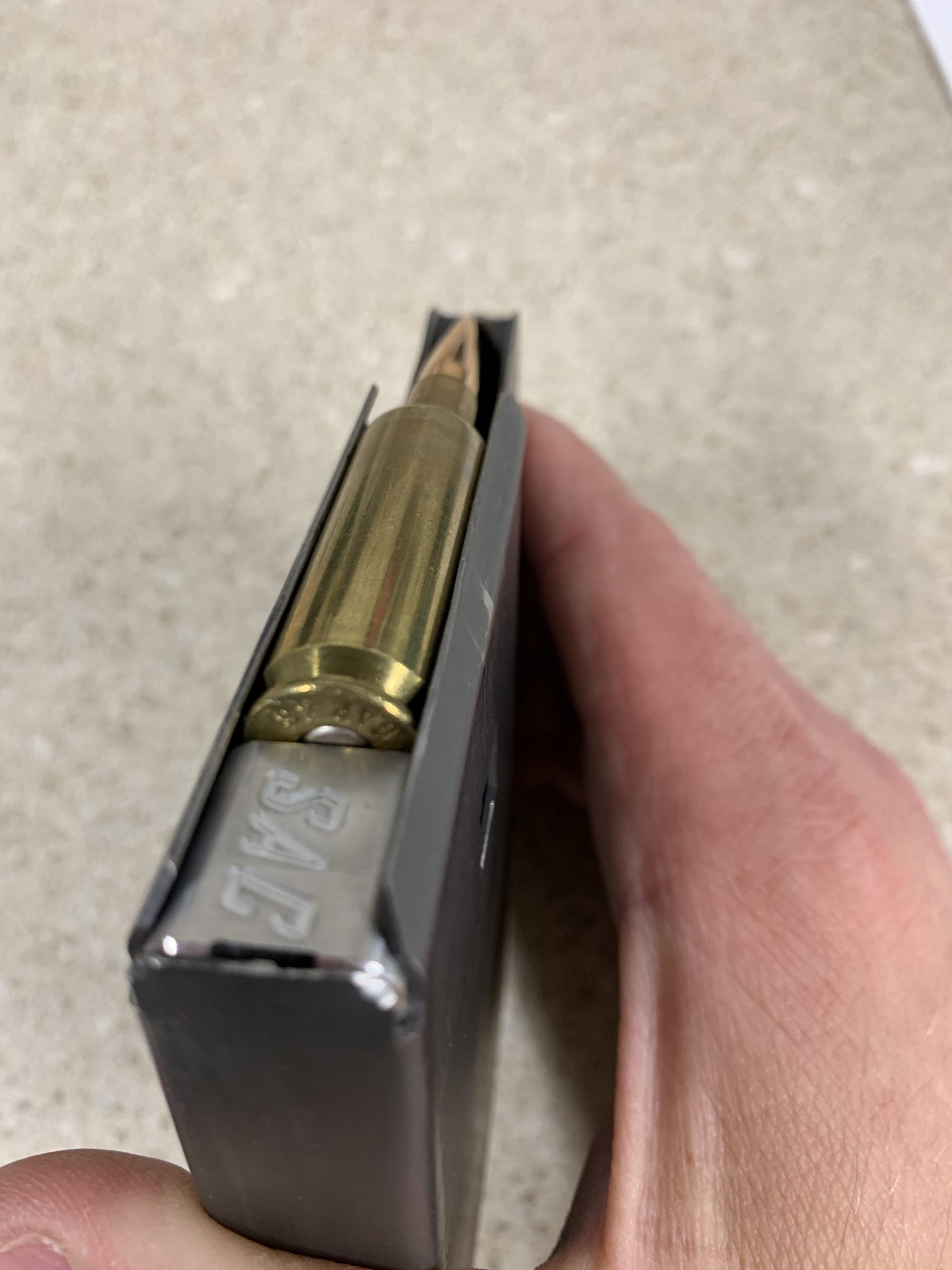

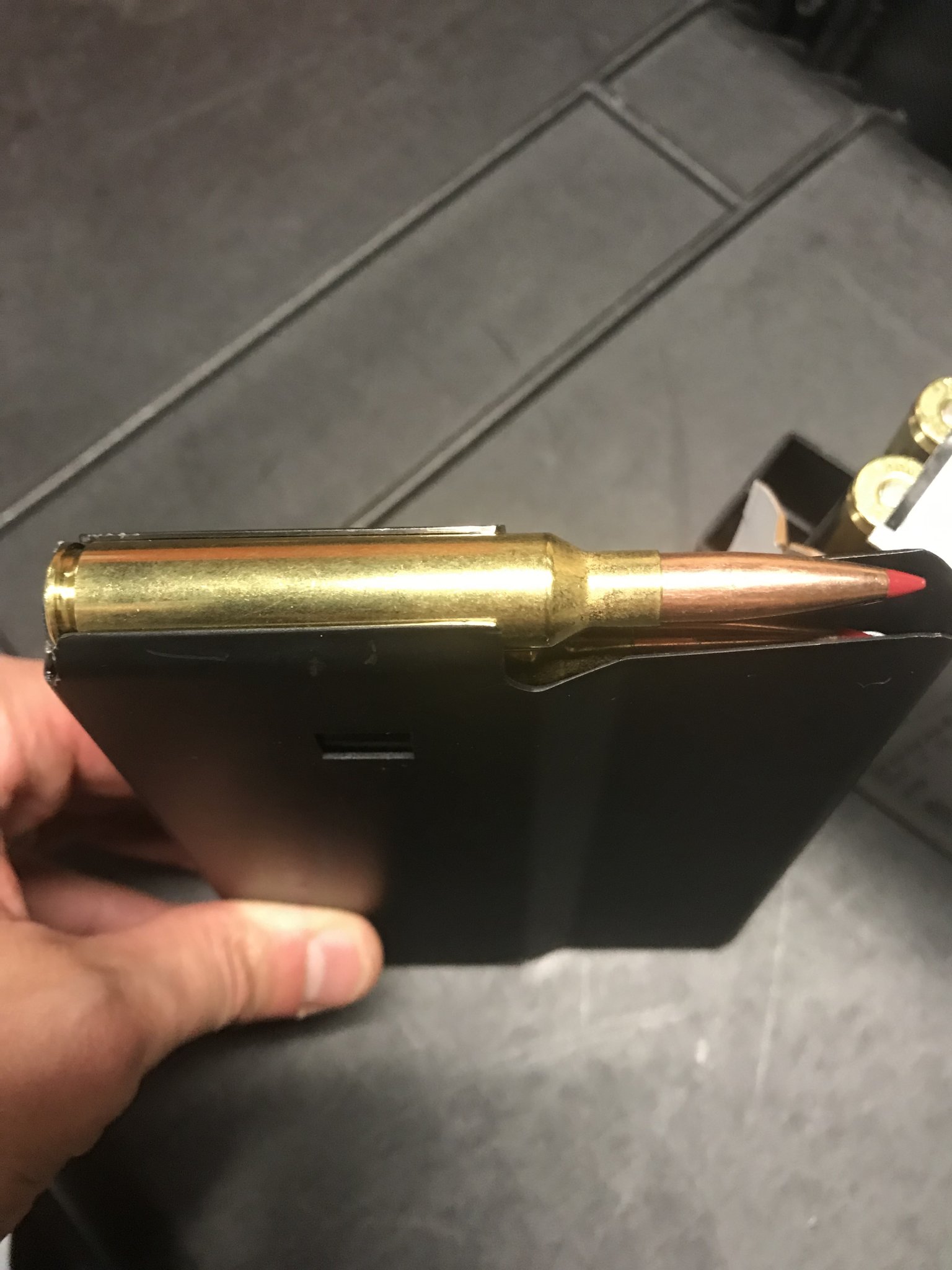

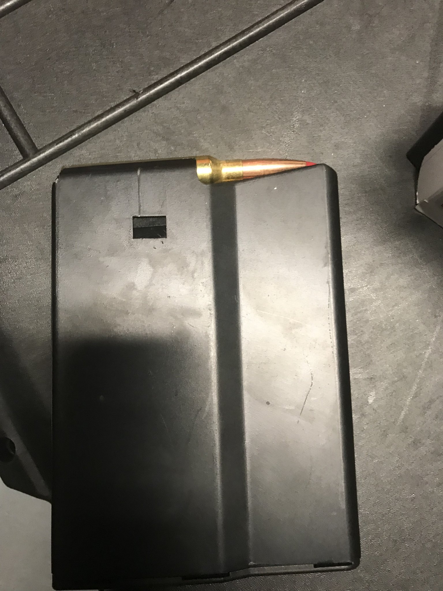

Worth every penny. If you’re shooting the 6.5 SAUM or PRC you need this mod from Short Action Customs. They requested my magazine so they could install the kit, so I sent it to them. Just got it this morning and cycled some rounds and it’s works great!!
Feeding was the biggest issue with the 6.5 SAUM in the DT platform; now that’s been fixed.
Any questions, let me know.
Reactions: M77

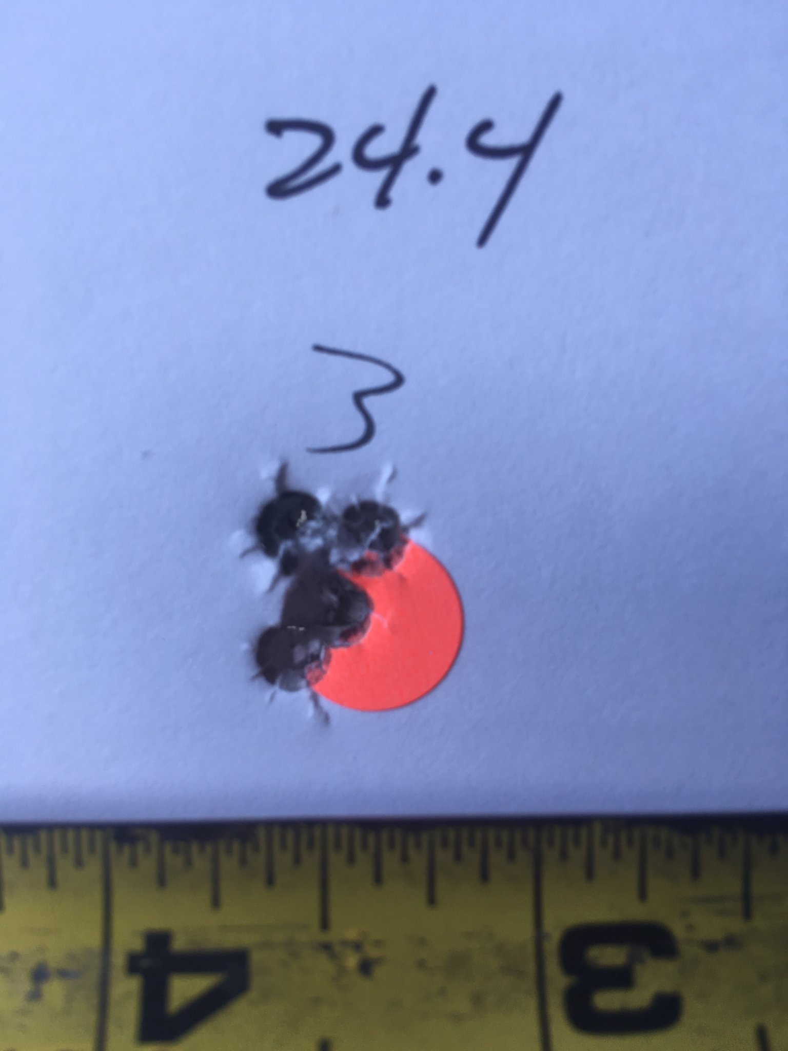

Doing some more load development. Berger 80 and 77 Sierra TMK.
Mark at SAC did a great job.

After I went on the SAC website and bought the magazine modification kit, I expected the parts to show up at my house. Then I got an email from Mark asking me to send him my magazine so they could install it. It’s a free service they provide. I think they had my magazine for a day or two before I was emailed a Fedex tracking number, so the turn around time is pretty quick. Like I said, it’s really a simple but very effective magazine modification. Worth it!!
I wanted to take the SAUM out hunting this November but opted for the 300 WM only because of the feeding reliability. That’s no longer a concern.
So the mag will continue to work with normal short action rounds like 308 and 6.5cm after the modification?
When you go 6.5 SAUM you need to use a dedicated magazine. I think this modification can be done to either a short action or the long action magazine; I had them modify a short action magazine because that what I was using for my 6.5 SAUM already.
If you opt to use the short action magazine for SAC's kit, then NO, this modification will not allow you you to use a 308 based/.473 case diameter bullet; the bullet just sits on the follower because I have modified the feed lips to accept the fatter .535 casehead of the SAUM. But thats ok, since I had already sacrificed a magazine and modified the feed lips.
If you opt to use the long action magazine for the SAUM, then adding SAC's kit to the long action magazine makes the 300 WM length cartridge is too long to fit in the long action magazine. I tried a 7MM Rem Mag bullet that I had lying around and it was also too long; the shoulder of the case hits the magazine shoulder.
Keep in mind Short Action Customs magazine modification kit was designed around improving the operation of the 6.5 SAUM or 6.5 PRC. However, I just tried a 300 WSM with a 230 Berger bullet and it fits and feeds great out of my short action magazine with SAC's magazine modification with plenty of room to spare for longer seating. So this modification should improve the feeding of a 7 WSM, 7 SAUM, 300 SAUM, 300 WSM, 6.5-300 WSM, 338 WSM, etc.

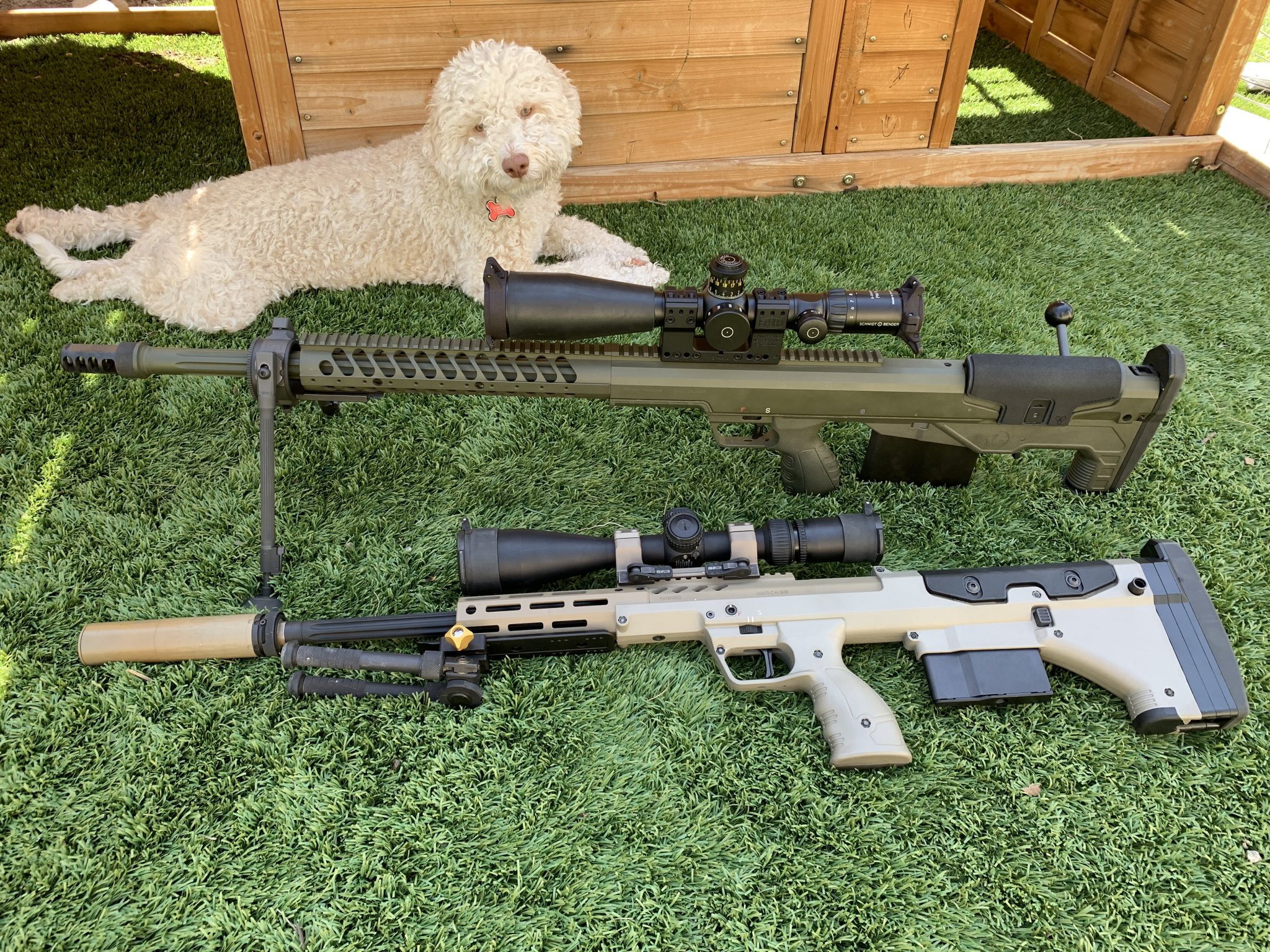

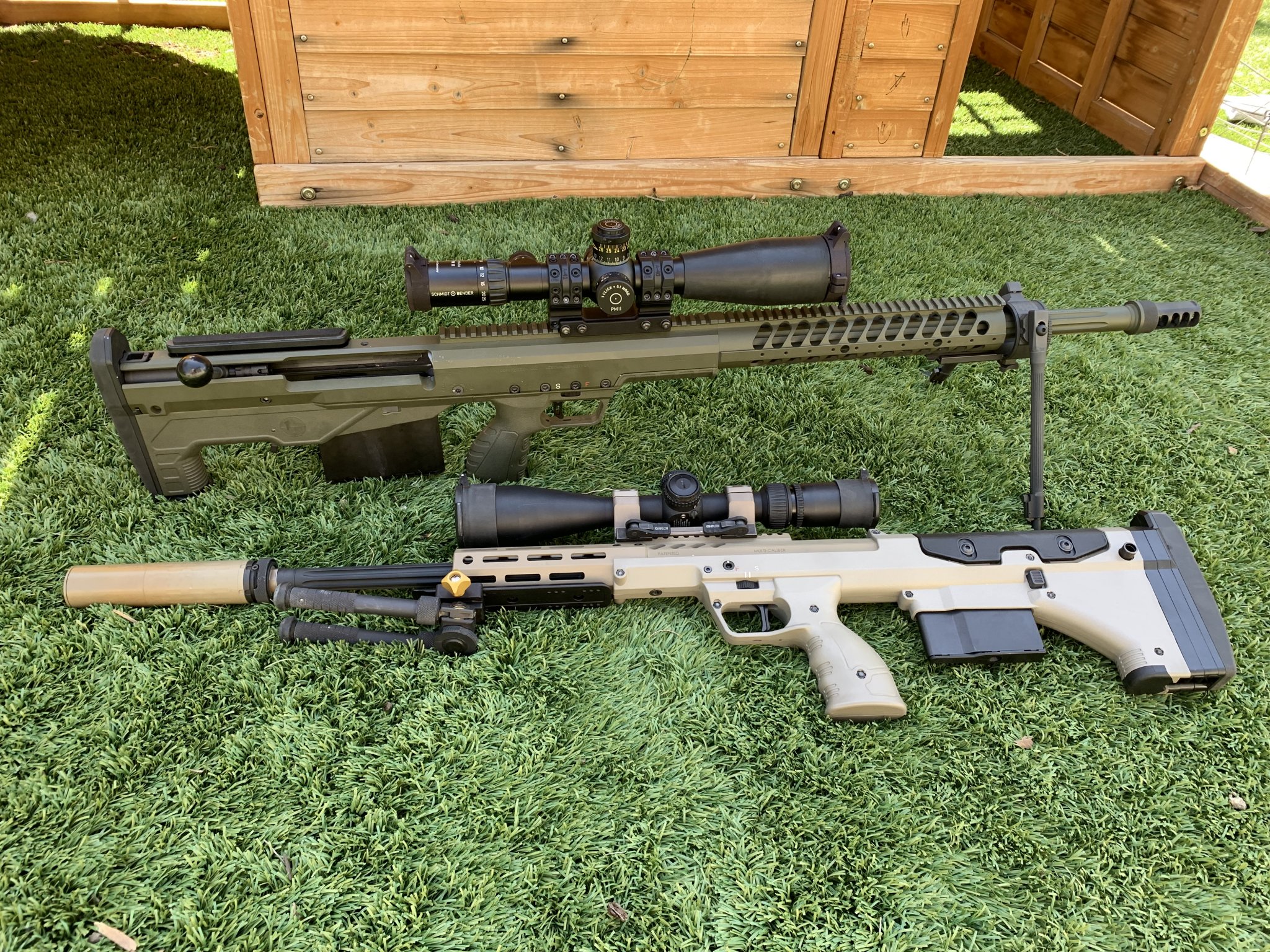

My two. The A2 is an absolute laser with the stock 6.5 barrel and factory Hornady 143 ELDX.

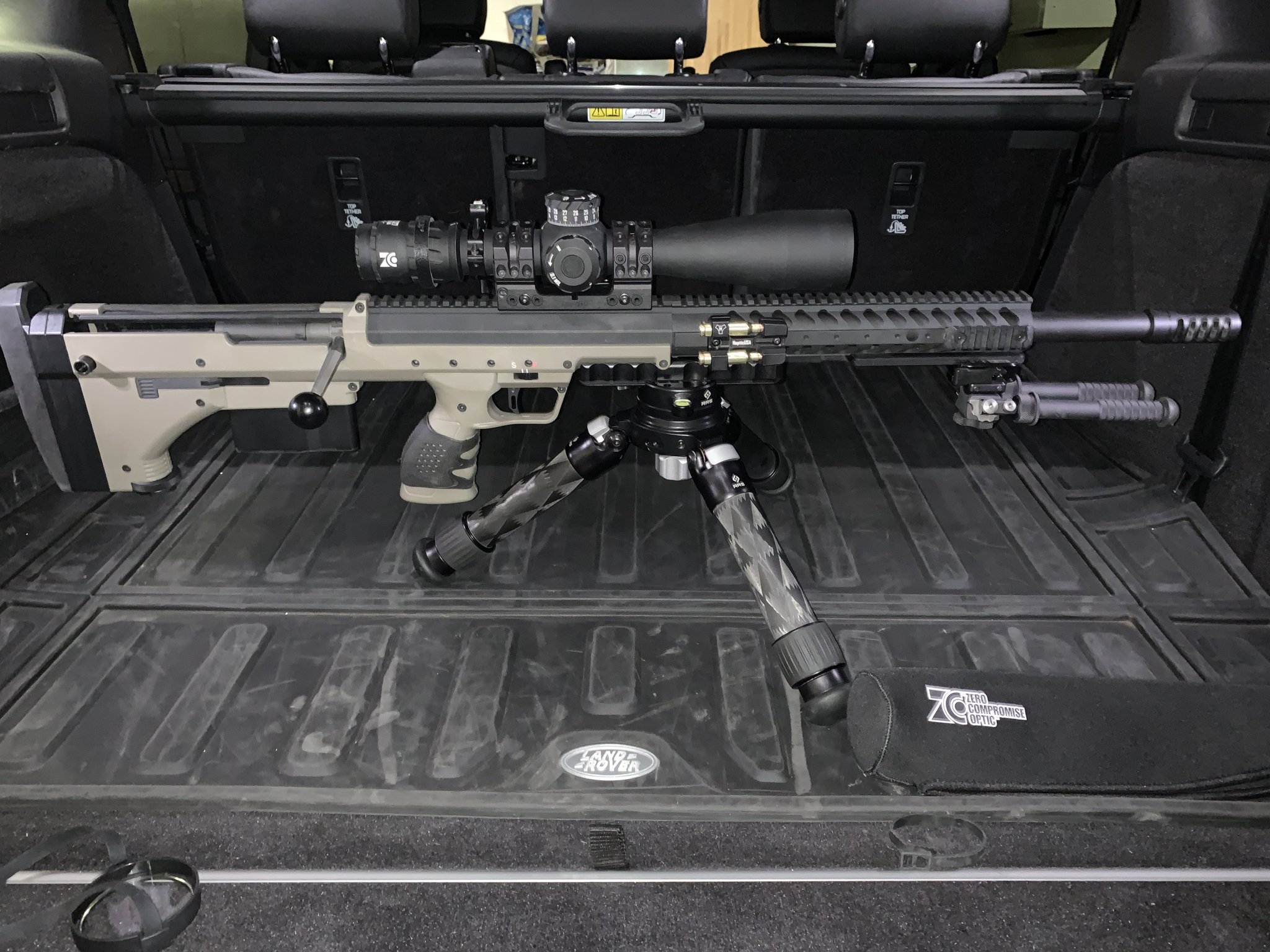

Got a great deal on the HTI from a seller here and finally just got the correct Scope mount and an ammo can of 375 Cheytac to shoot. Taking it out for the first time this week! 50BMG conversion and a bunch of 750 AMAXes come on Tuesday.
Let me know how those 750s fly once you get it out! IT hammered for my brother and I out too 1625...

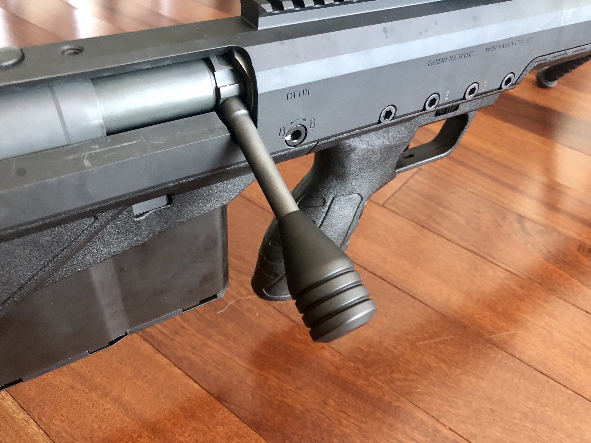

Spoke with Keith @ Phoenix Custom Rifles this afternoon. He customizes each one based on any design/size and will custom fit them to the specific bolt when you send it to him. He's going to make 2 for me for a total of $70
Just got my bolt knobs back from Keith @ Phoenix Custom Rifles and they look awesome! This one is on my HTI 50
