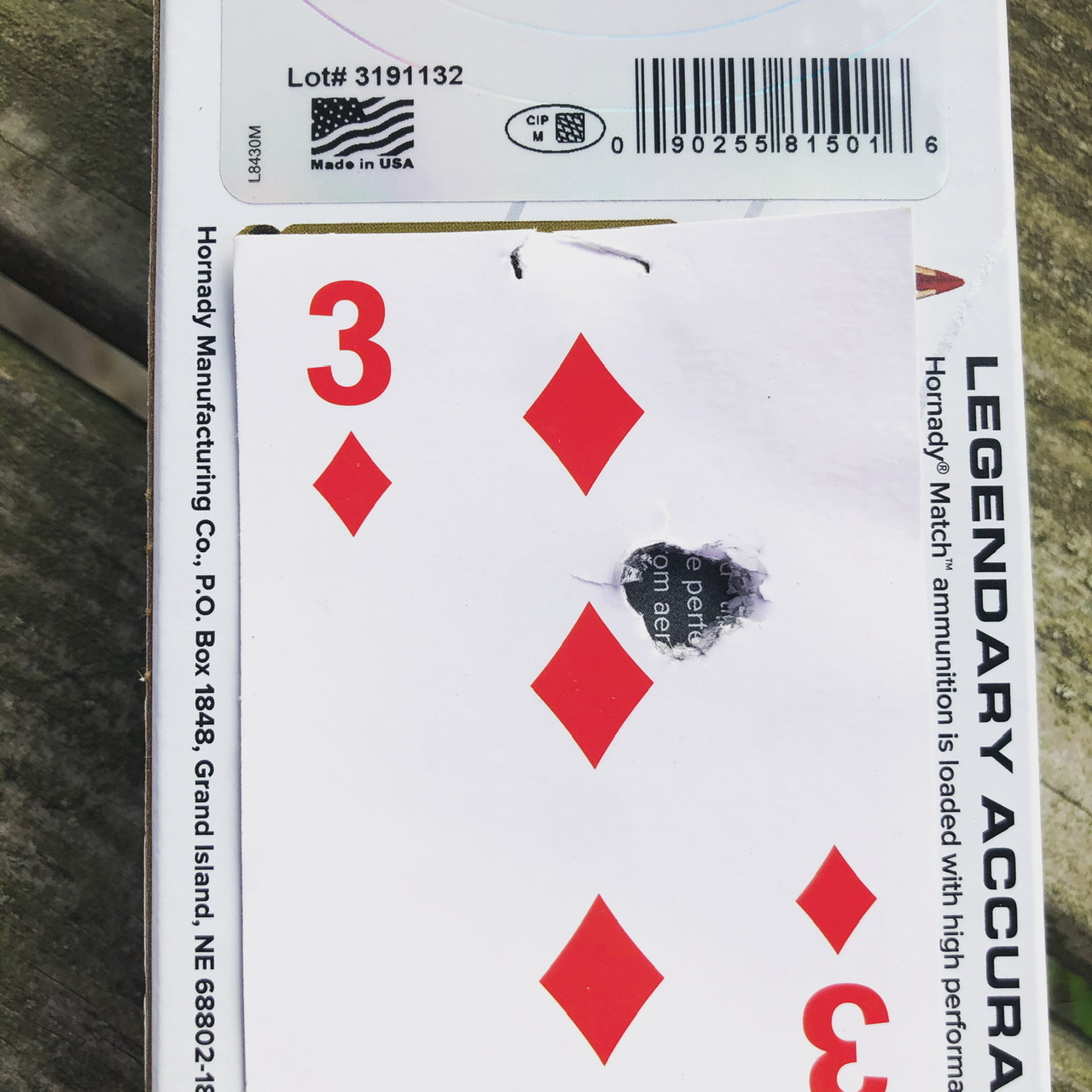

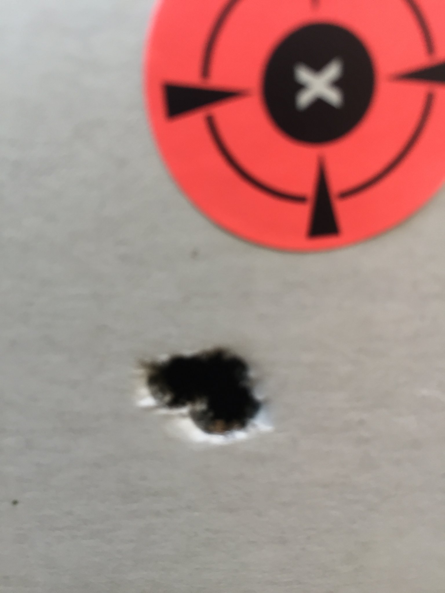

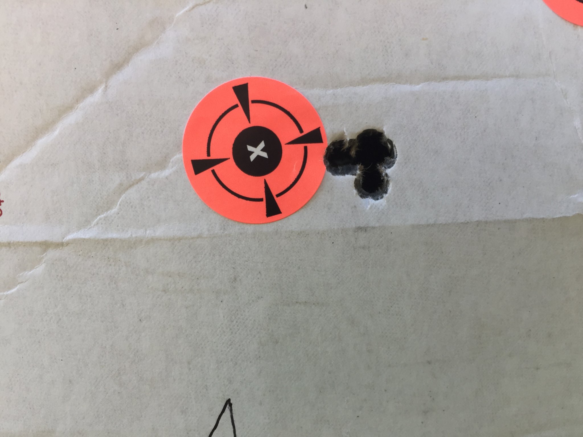

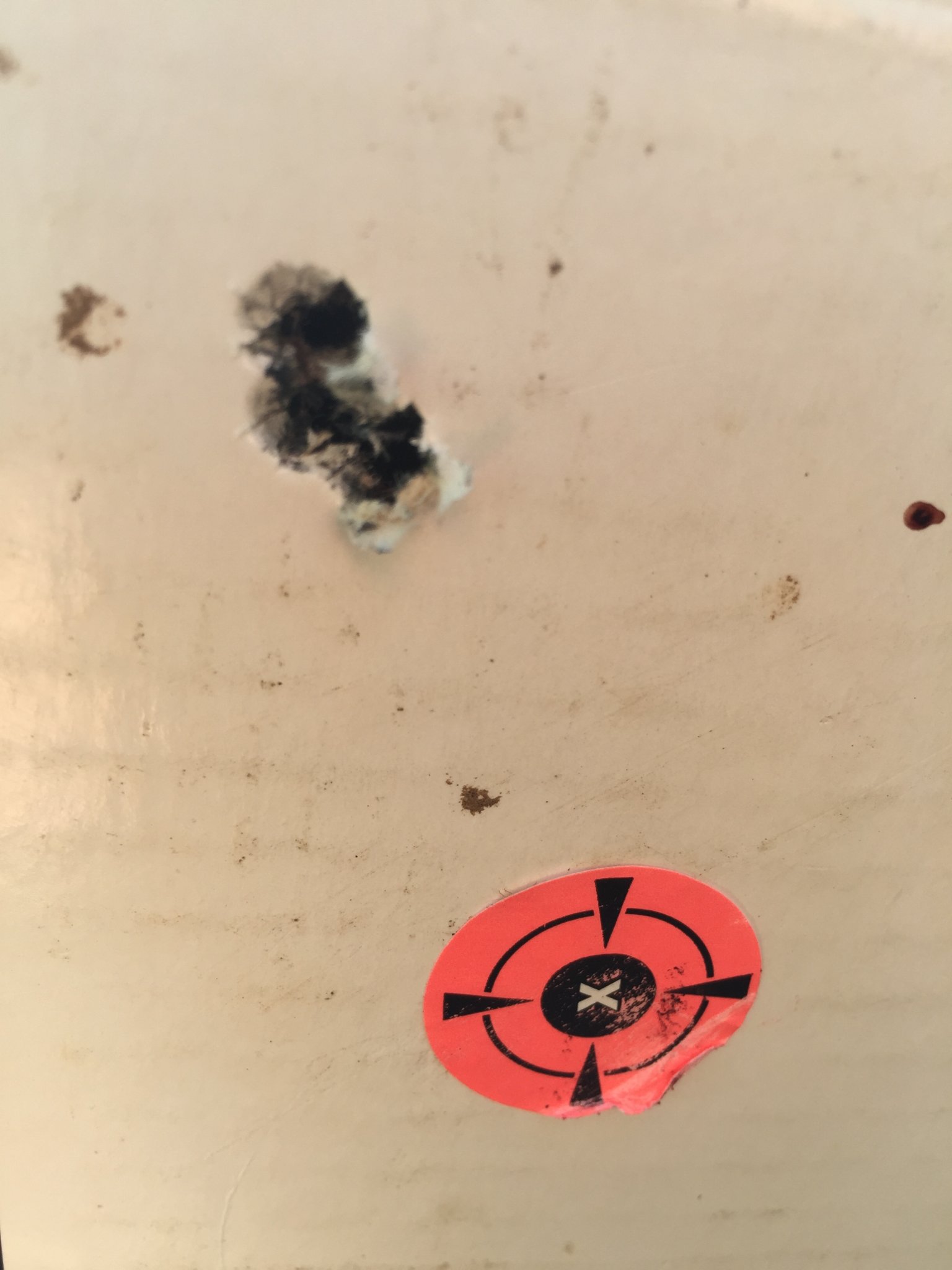

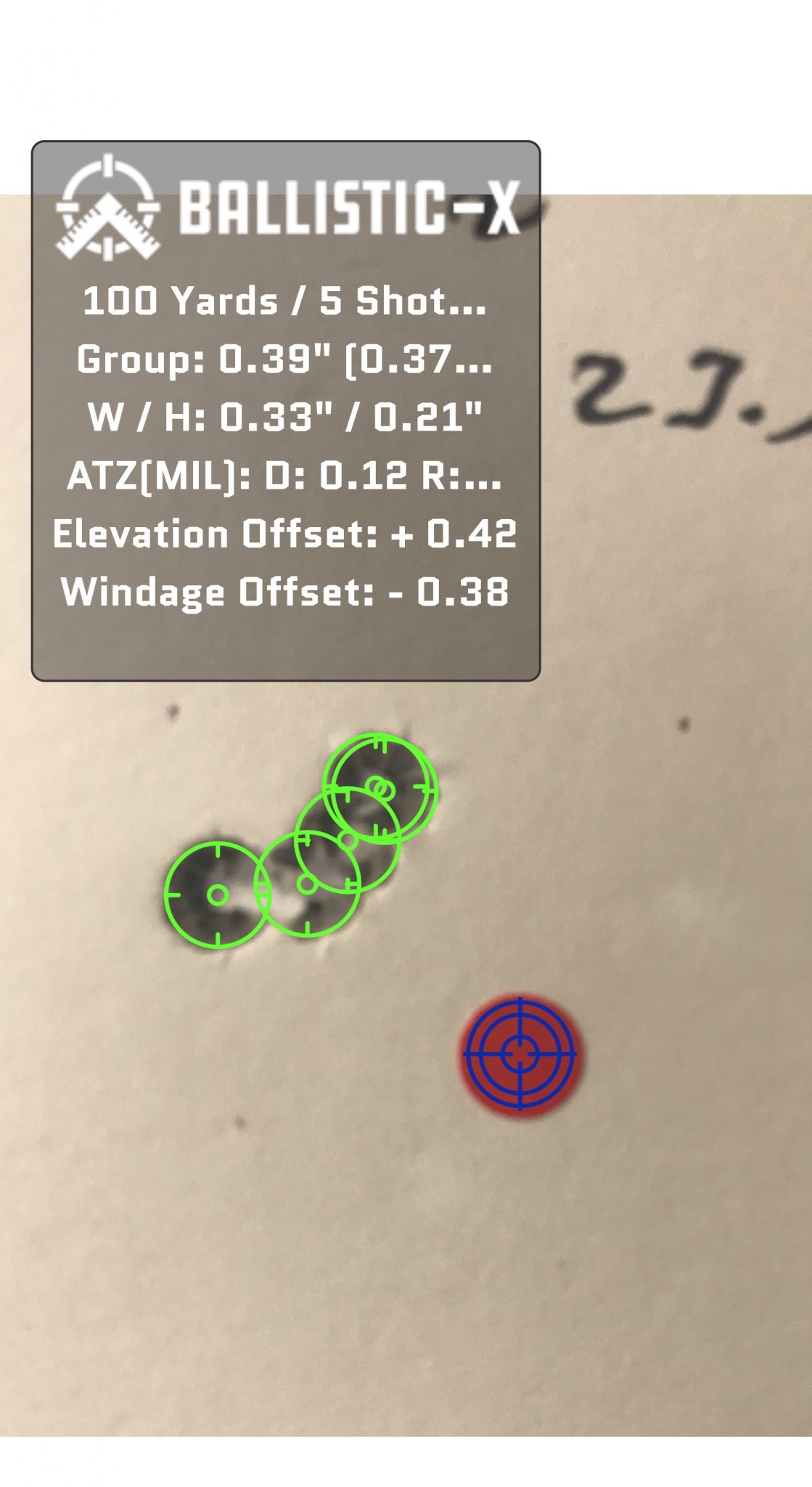

I haven’t shot the DTs for groups lately. But I had to sight in a new scope on an AI with a PVA 18” button barrel. 5 shots
And here’s a 3 shot group from a Proof barreled SP10
And a 3 shot from either the AI or Seekins
I’d do 5x5s but not enough time and I’m not the best shot

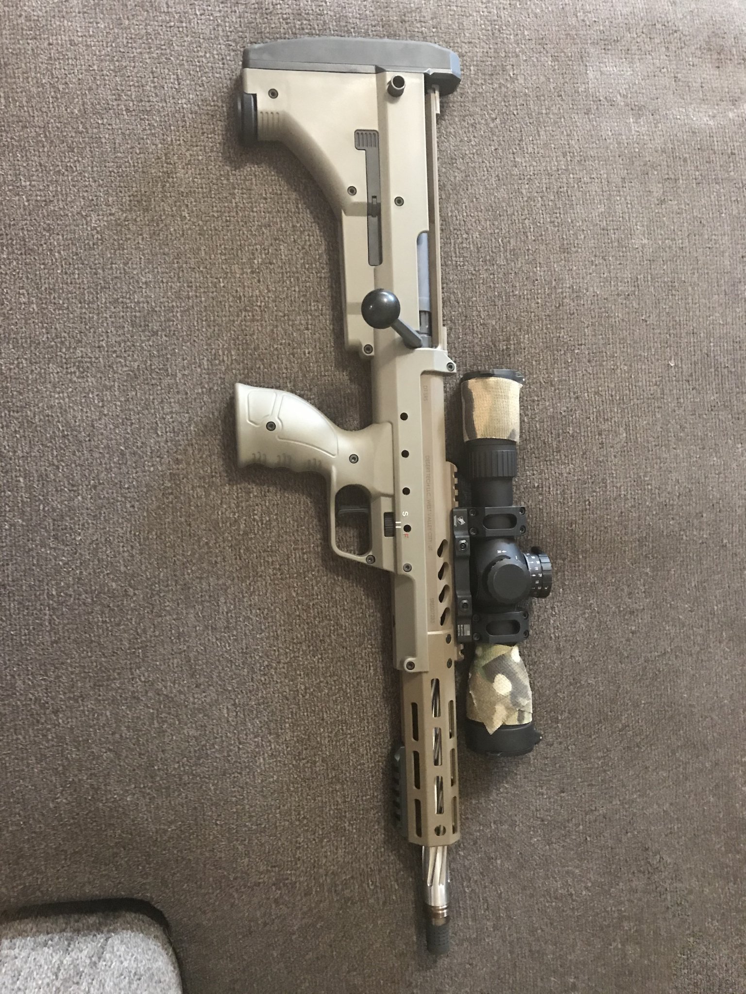

My A1 I wearing a Gen2 Razor and a 30” .338 Lapua AI barrel. They feel like very different rifles. Lol

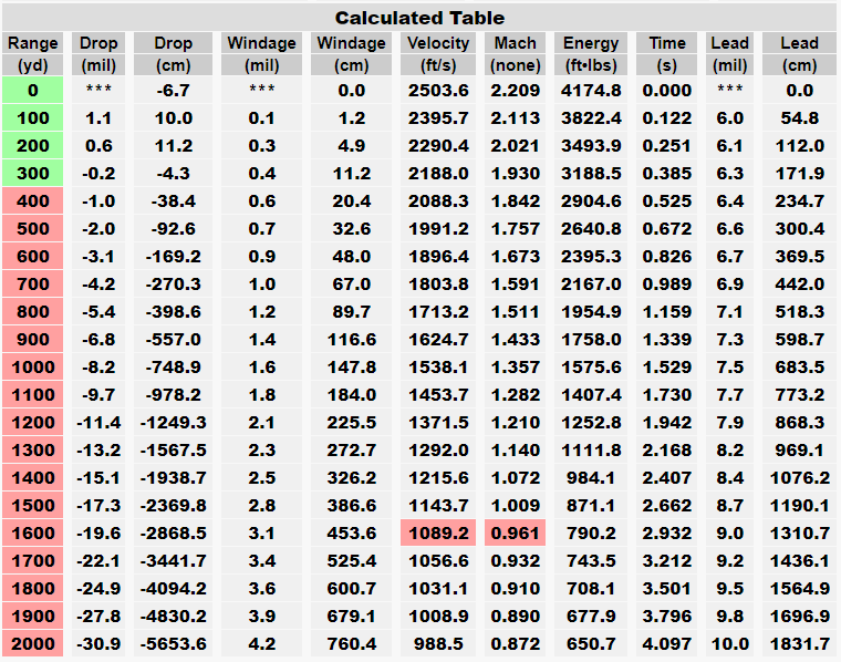

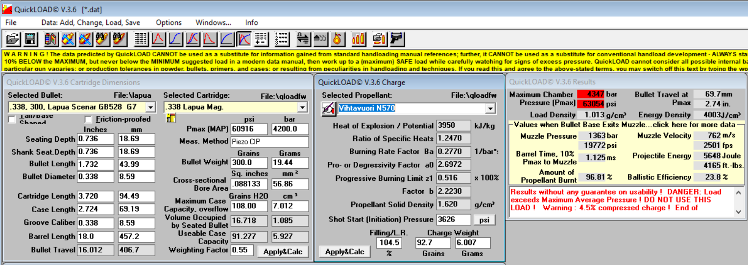

Yup, been shooting mine since 2012. It was initially designed, per DTA, for shooting subsonic 300gr bullets - hence the really fast twist. I did that initially but also found it was good for full power loads too. At 18" it's not the long range beast the cartridge is intended for, it's still really good at hitting hard inside of 1000m and bucking high winds.
250 & 300 grain Scenars run great in it. You'd think 300s would be too heavy for it, but I got surprisingly good performance (92.7gr N570 pushed it to around 2500fps). For some reason I could never get the Hornady 285s to group well at all.
As you can see in the drop chart above, even a 300gr Scenar at 2500fps stays supersonic almost to a mile. For short .338 barrels, I think 18" is the limit to how far you should go. A 22.5" barrel will net you another 150fps, but compared to the above numbers it just won't make a huge difference. That's why 26" - 30" is generally considered the sweet spot to squeeze the most performance out of the cartridge.
