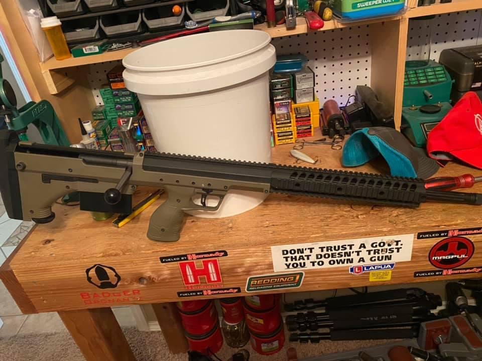

I have a gentleman wanting to trade this dta for a couple rifles of mine. He says it’s an a1 with 308 and 26 nosler conversions. My question is what it’s the street price on this set up. Want to make sure we have an even trade. Anything I need to look for as far as wear or anything when I go check it out? I don’t know much about these rifles but I want one.

Can you get a picture from the other side? I can’t tell if it has the adjustable cheek piece or if that line is a hoptic saddle. I thought the A1’s came with the slimmer rail that only had a picatinny on the top, but this gun has a quad picatinny handguard which were on the Gen 1 and Gen 2. That’s not a bad thing, I actually prefer the rail on that gun but the newer one is a little lighter and used plastic rail sections. That looks like a 26” 308 factory barrel, and the 26 Nosler would be a custom. You’ll want to know what else comes with it, a case, torque wrench, .473 boltface bolt, .535 boltface bolt, number of magazines per caliber, etc. Round count on the 26 Nosler is important.
I haven’t been paying too much attention to street prices lately, maybe someone who has bought or sold one recently can comment, but the pricing would depend on what all is included.

Thanks for your reply pinhead, as far as I know it’s just the chassis, both barrels, both bolts, and one magazine for each caliber. 308 bbl has had 40 rounds thru it and the 26 has had 75 Rounds thru it. I’ll find out about torque wrench and case. And the cheek piece.
Chassis is probably worth $1700-2k standalone, .308 barrel is $600-650, 26 nosler maybe $700 (if you like that cartridge and round count is honest), each bolt is worth $300, and magazines are $50-60 a pop.
Probably got $3600-4k in stuff there on the used market. I would also expect a discount for buying it all as a package. I don't know what your thought is on the worth of your pistols, but if I was paying cash I would be trying to get it done for $3500 for what he's offering.

Awesome thanks 65. I’ve got about 3600 in my end. So sounds like a fair deal. I’ve wanted one of these rifles for a while just never pulled the trigger.
