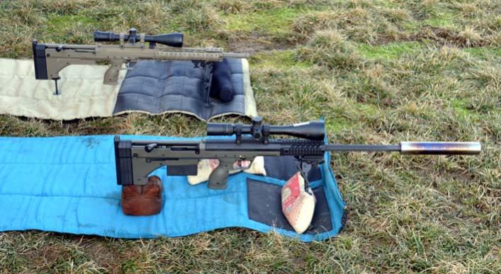

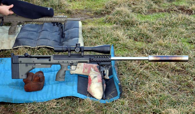

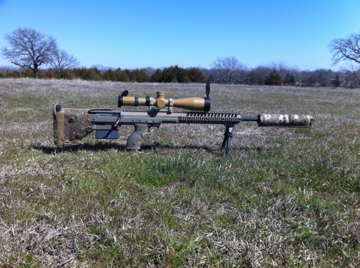

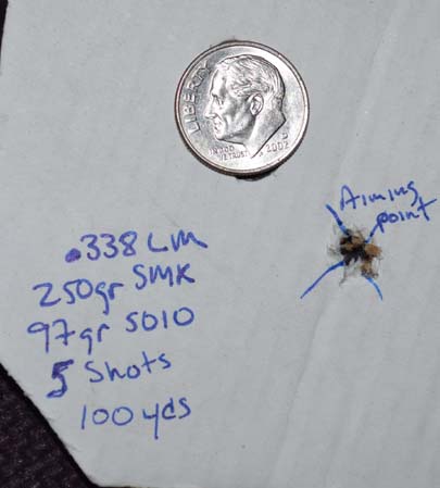

Did a little suppressor testing with my SRS today. The rifle worked great and the old can didn't affect the accuracy as I thought it might....rumors that K baffles are bad for accuracy seem to be overrated. The new can didn't do so well as the last shot was about 8 inches right of point of aim.... launched the tube and baffles downrange when the threads on the tube let go of the endcap. .338 Lapua Mag is a bit much for a can of that size and type. Recoil from a 2lb can fired 37yds is a bit rough as well. Finally tried using a rear sandbag because I'm still waiting for my monopod kit to make it in. That fixed my problem with shooting decent groups. The old can with just under 1000rds of .338 LM through it worked great. Shot a 5rd 100yd group that a dime covered. Swapped the 6.5 X 47 barrel into the rifle and the .338 can made it very quiet. The new can was pretty quiet with the .338 BR and compared to the old unit it was hard to tell which worked best. I'm sticking with welded cans for the high power stuff from now on though. Quiet doesn't matter if the can comes apart.
A few pics....
The pics of the .338 LM group with and without the dime cover, pics of my SRS in green with the can on both the .338LM barrel (black) and the stainless 6.5 X 47 barrel. The flat dark earth rifle is my friends. We were using it to compare the suppressors in real time.
A few pics....

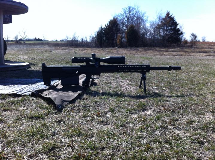

Here is my srs 338 Lapua and hti 50
The srs has a buttpad and cheek piece from Brian and its awesome !
Srs is super accurate and only shot hti first time today with federal eagle fmj and it did really well.

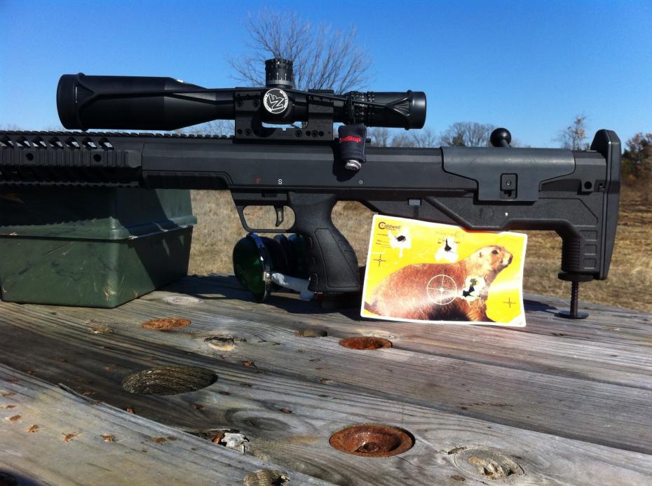

The recoil is not near as bad as I thought it would be. I previously owned an armalite ar50.
Blast is there but again not terrible. Now the percussion you get it is definitely noticeable, not unbearable but does grab ur attention.
The pic is first 2 rounds high and left and last 2 right of bullseye with 633 gr fmj factory ammo at 100 yards.
I plan on running 750 gr amax and have some dta ammo on order and will be reloading as well.
So far I am very pleased and look forward to future range time with it, 375, and the beast !

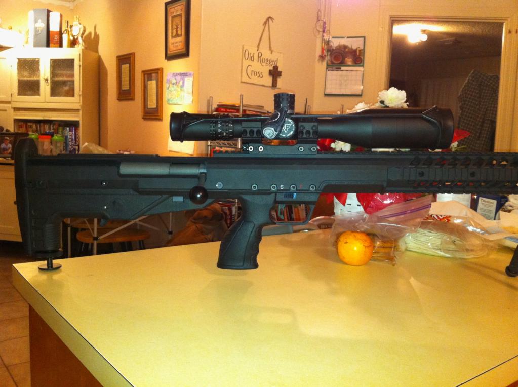

DAMN! Is that a ATACR sitting in a Spur atop a HTI!!! Please show us more pics of that set up.....a lot more!
Will have to take more this is all I have.
Atacr is really nice so far. Spuhr is a 0moa mount and will go on another gun.
Have a dta 40moa mount and night force beast on order.
