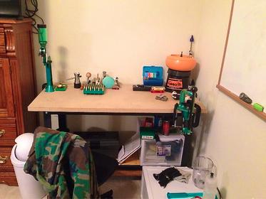

Here's a pic of my Chrismas present!! Bench and Accessories I know it is not TOP notch but I just graduated college a Wk ago im not a Baller yet.
