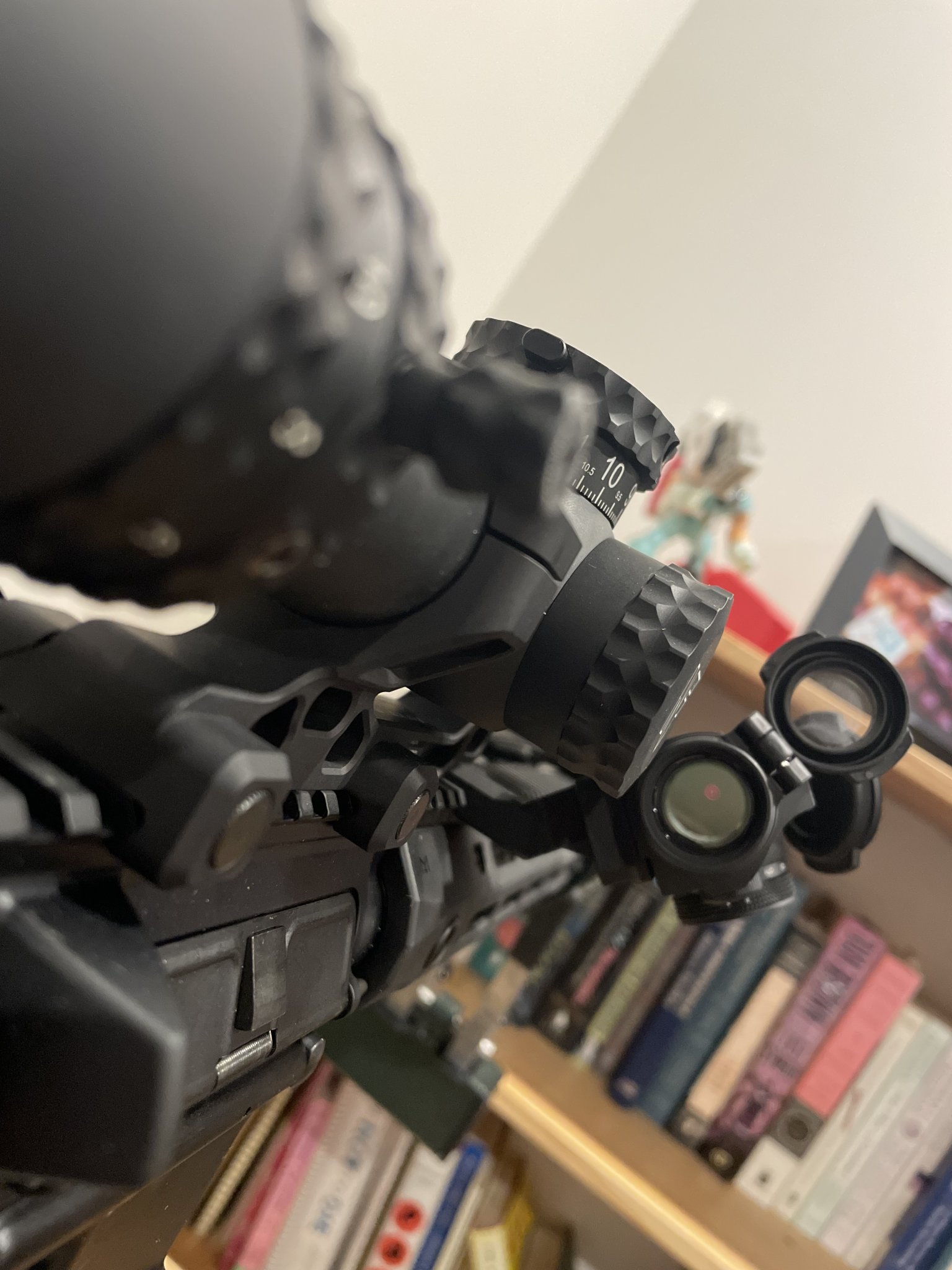

Seconds for offset to maintain cheek weld and I’ve personally found that rotating/canting the weapon provides a very comfortable position for rapid close engagement. Usually these aren’t the lightest configurations (mentioned above and shared by many the opinion of burly over delicate) I noticed that the cant engages slightly different muscle groups and is really nice to practice with when fatigued from classic upright shooting stance. I run the 4-16 atacr and t2 offset with the ariska high mount (1.54 on the atacr) and have never had an issue with zero. The ariska has a burly construction with well thought out hardware.

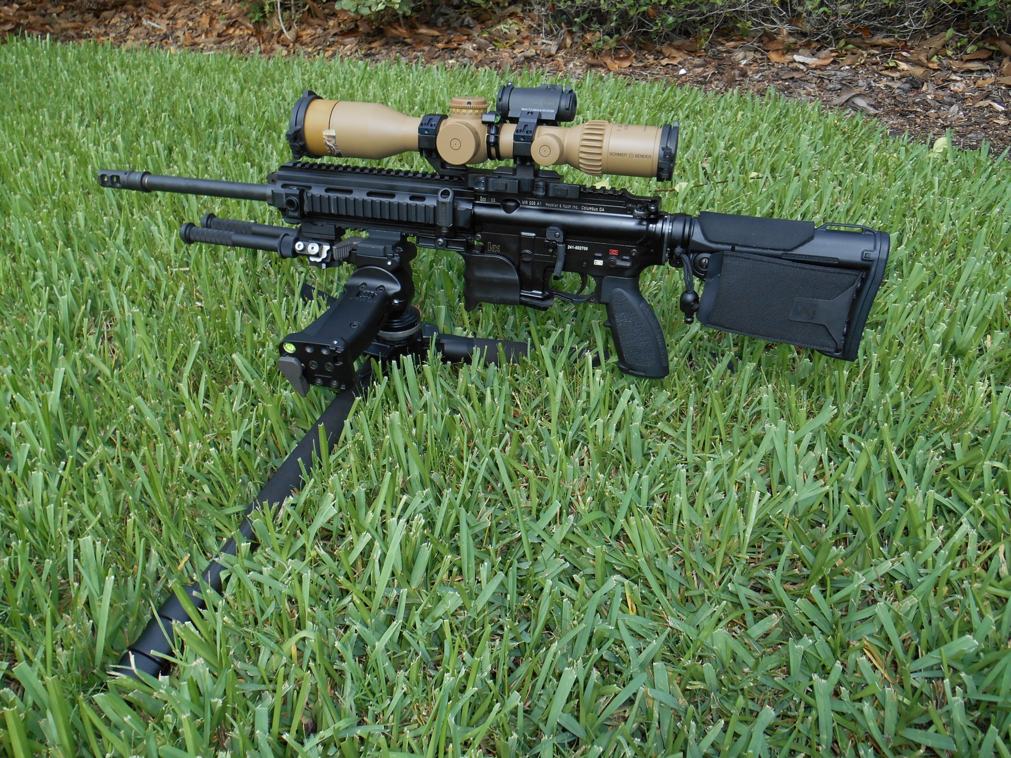

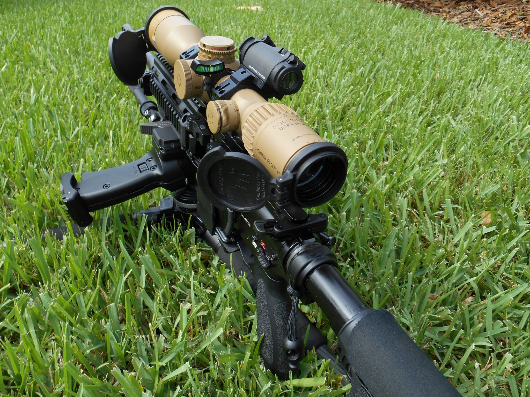

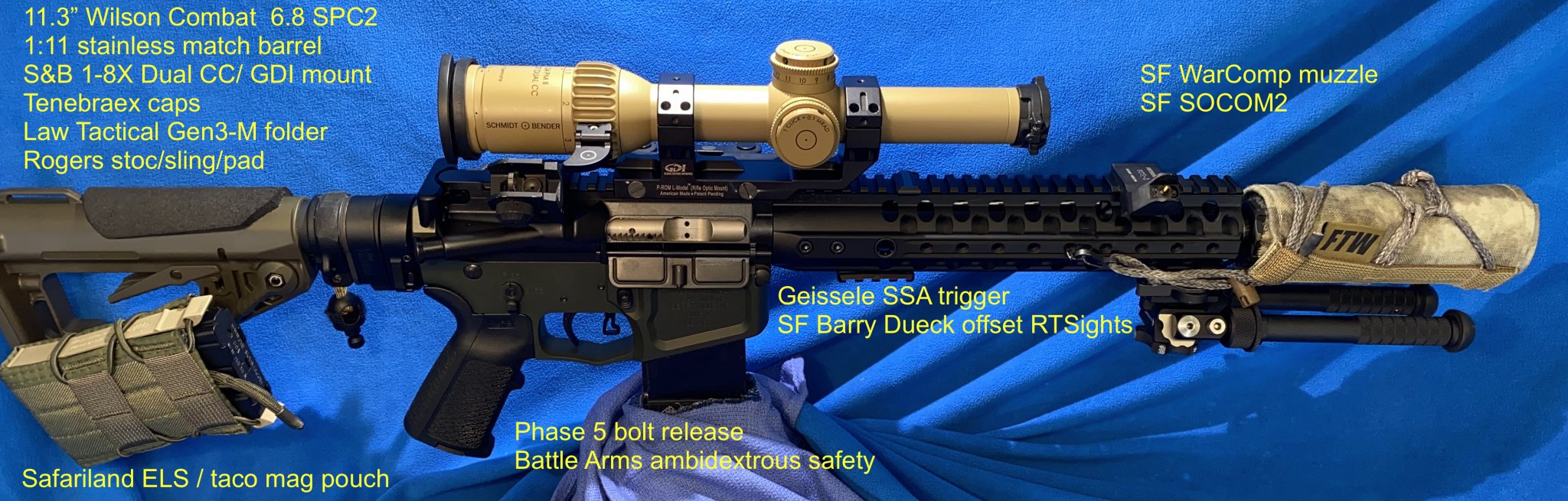

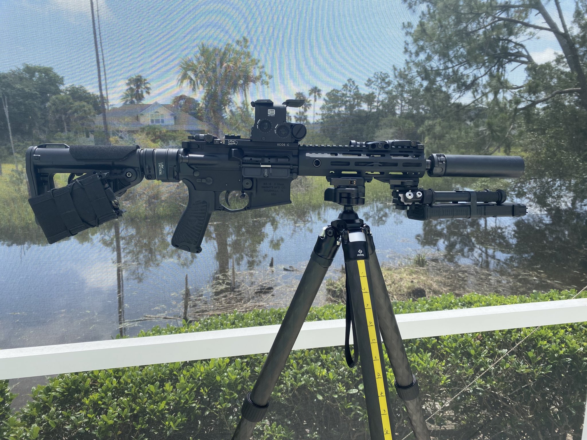

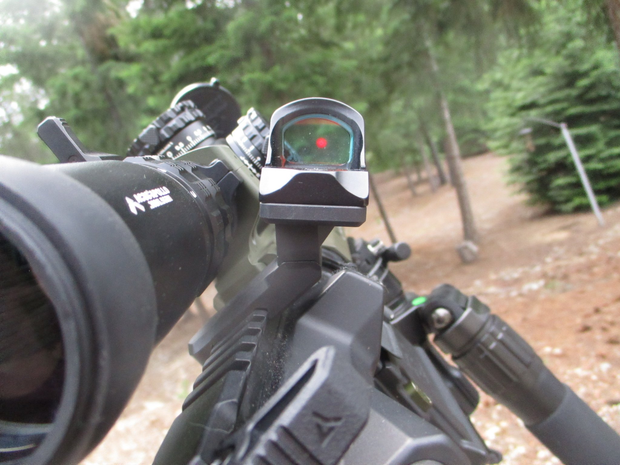

I only have set up a few rifles with secondary RDS optics, prefer strong side offset (HK 556, LaRue OBR, SR-25). The 6-48 ACOG with RMR on top is a mother lode. Surefire's Barry Dueck has nice offset RTS (rapid transition sights) that I have on this Wilson Combat 6.8SPC2 SBR; No battery worries.
I only have set up a few rifles with secondary RDS optics, prefer strong side offset (HK 556, LaRue OBR, SR-25). The 6-48 ACOG with RMR on top is a mother lode. Surefire's Barry Dueck has nice offset RTS (rapid transition sights) that I have on this Wilson Combat 6.8SPC2 SBR; No battery worries.View attachment 8171373View attachment 8171374View attachment 8171375View attachment 8171379View attachment 8171380View attachment 8171381
Beautiful stuff… I been very curious on the top strong side as well especially because I believe we have the same mount on a few. The spuhr qd. What tripods you runnin? I need those too lol
Over the past 10 years its been a journey......alsmost every variant of Manfrotto with Picatinny adapters, Swarovski center column carbon fibers got lighter, now just the RRS 34 mm tubes with Anvil-30 which is pretty stout for my uses. KAC SR-30 SBR.
