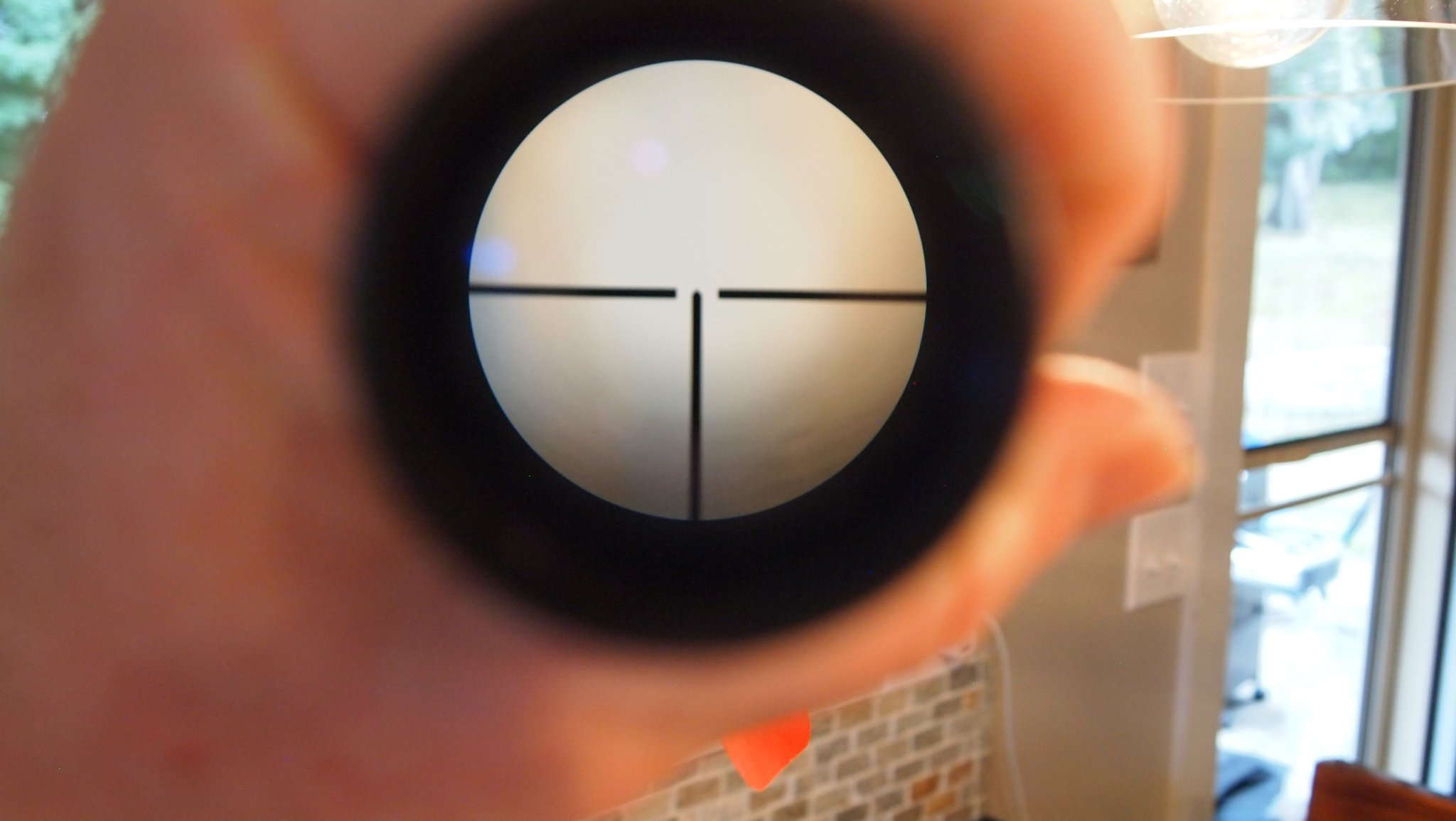

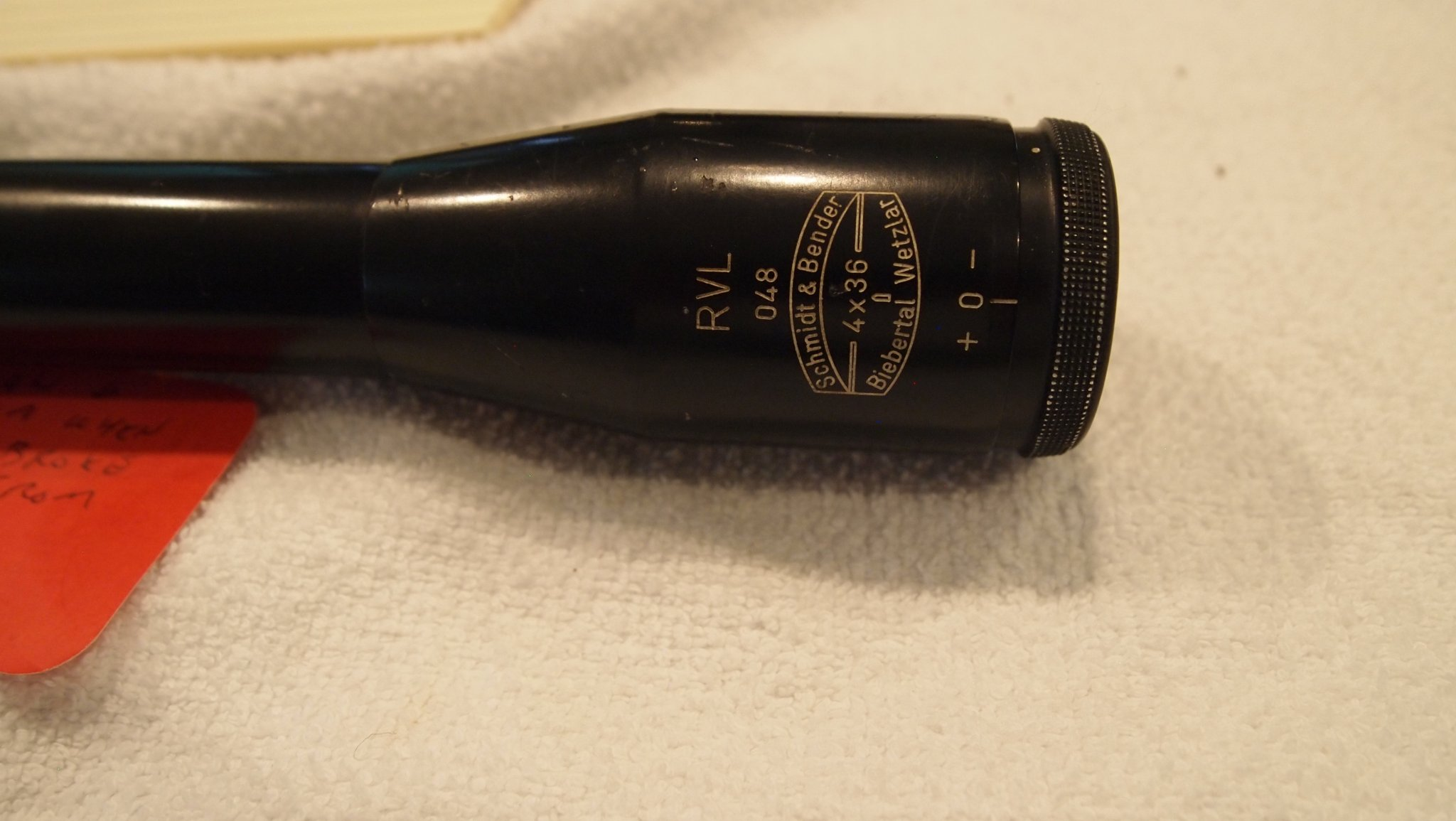

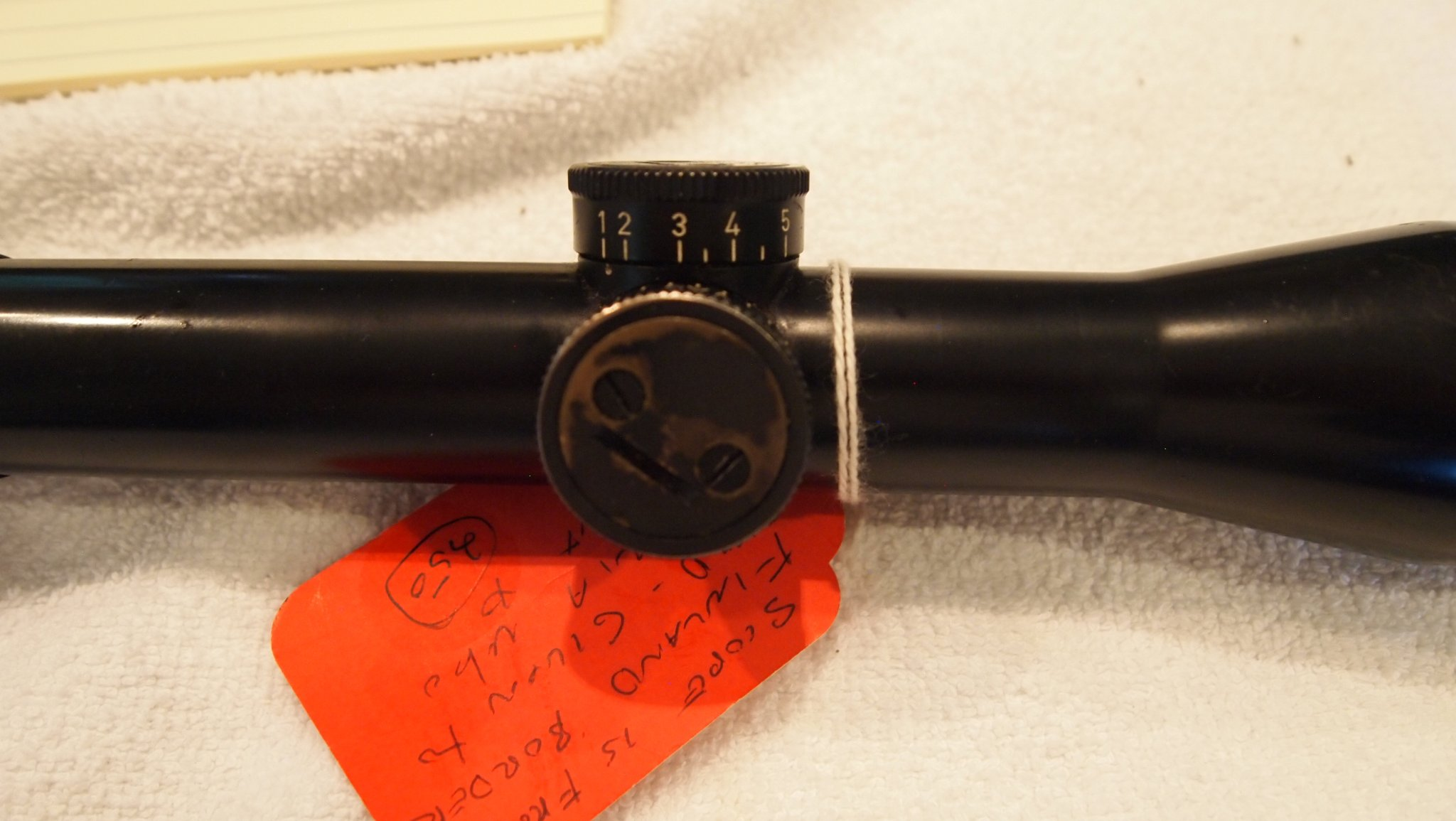

I picked this one up recently...
Fixed 4X but the turrets are very tactile and solid.
Its a perfectly suitable scope for the present.
You could get a lot worse.
This one only suffers for being BDC for Russian Mosin ammo as used by the Finn Border Guard snipers.

That's a great and an unlikely find pmclaine!
Actually the BDC turret on this scope is set up for the JVA0221 & JVA0222 rounds used
by the Finnish Defense Forces.
Specifications of this round are:
Cartridge: JVA0221 & JVA0222
Caliber: 7.62x53R
MV: 720 m/s (2362 fps)
Bullet: Lapua D166, 200 grains, G1 BC = .448
Case: Sako or Lapua (Formerly known as Valtion Patruunatehdas, VPT)
Powder: Vihtavuori N140
Charge weight: 2.77 - 3.00 grams (42.7 - 46.3 grains, has varied over the decades depending on the powder lot)
The only difference between the JVA0221 & JVA0222 rounds is the packaging - JVA0221 comes in a hermetically sealed package, while JVA0222 doesn't.
Atmospheric conditions that match this BDC:
Temperature: 15 Celsius (59 Fahrenheit)
Elevation: 50 meters (164 ft) above sea level

Its marked RVL rather than SA so I understand the Border Guard used it.
I think tube is smaller diameter than SA.
I couldnt leave it on the rack at the shop I bought it from so I bought it as a sniper rescue for someone interested in such hoping to sell it but there has been little interest.
Saved an SA Wetzlar in green leather case at same time.
Thank you for the added knowledge.

This is correct - RVL is short for Rajavartiolaitos, which is the Finnish Border Guard, so this scope has been their property. Scopes that have been property of the Finnish Defense Forces (FDF) are marked with either SA (short for Suomen Armeija, which means Finnish Army) or with a tower logo.
Over time there were three different scopes that were used on TKIV-85 / TAK85:
- MSW Wezlar 4x36 (no longer in use, all surplussed, found on TKIV-85 prototypes and scoped m28-76 rifles)
- Schmidt & Bender 4x36 (most common, some surplussed, some still in use)
- Zeiss Diavari ZA 1.5-6 x 42 (still in use, not surplussed)
My understanding is that the specifications of each make & model were identical regardless of whether they were property of the Border Guard or FDF. Border Guard is a much smaller entity than the FDF, so I 'd presume that RVL marked S&B 4x36s are much less common than SA or tower logo variants.
Really good call to pick these up and you're most welcome!
