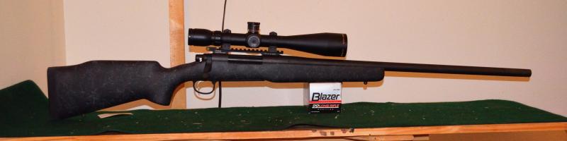

    I picked up my 30-06 model # 84166 today from my LGS.
    I thought I would post up a pic and one of its first 10 shots using standard Winchester super-x 150 grain power points... since I don’t have any dies or brass yet for it. I forgot about a mounting system while I was shopping, so I scrounged around and cobbled together the Warne PA rings and some uber cheap bases I bought about 20 years ago...
    The rifle
    The first five then a scope adjustment for the final five.
    The final group of five if measured CTC is .97

    As shown mine weighed 11lbs even. I've since added a cheek piece and harris bipod.
