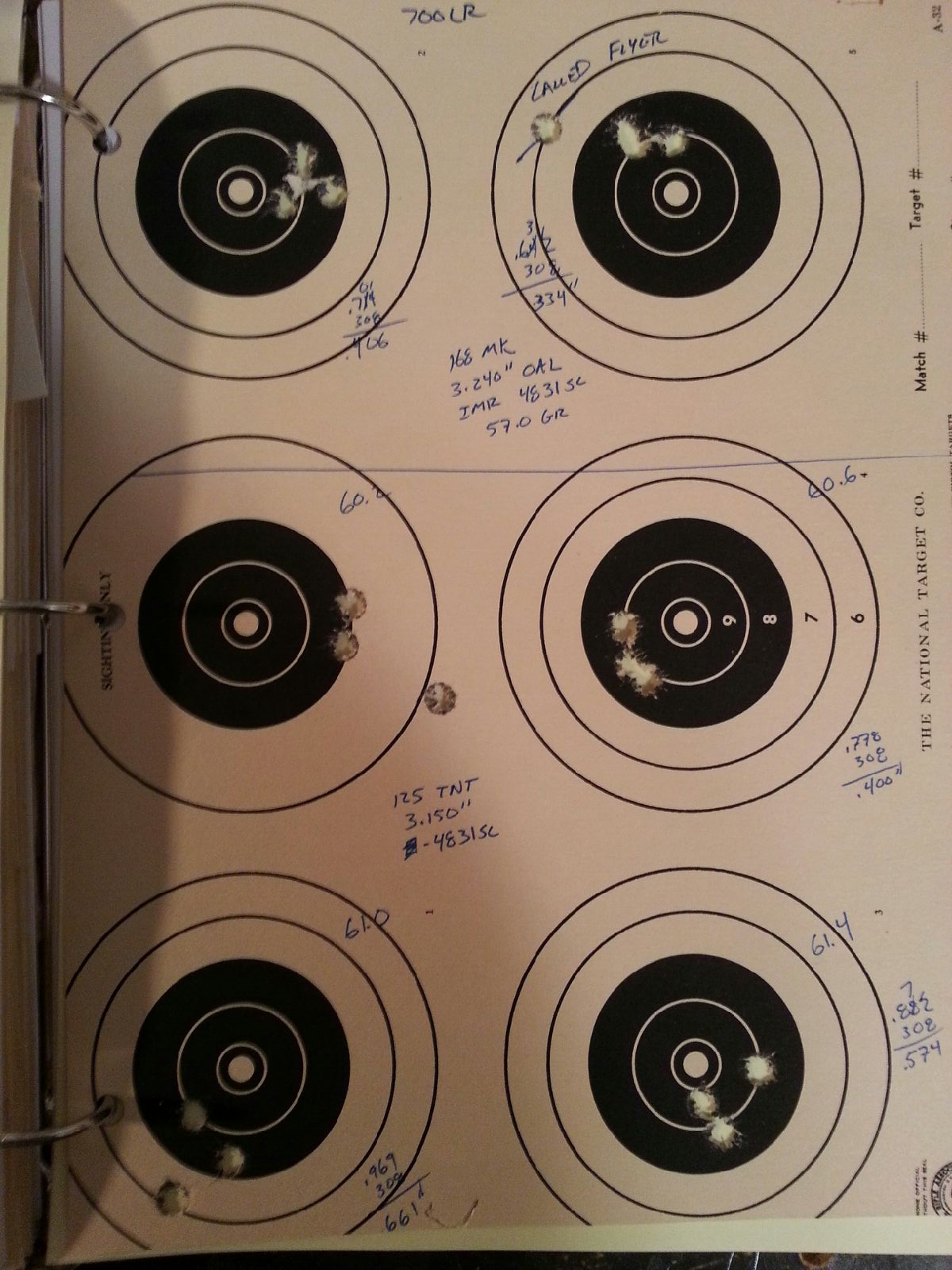

I had a chance to play with mine last weekend. I'm really starting to like this rifle. I only went out to the range to finish barrel break in and try to work up a varmint load. I threw some 168MK loads together completely at random and they look like they'll shoot sub .5 MOA. With a little more effort I should get the 125 TNT's to settle around .5 MOA as well.
Edit: Don't look too closely at POI, I was screwing with the scope adjustments between groups.
