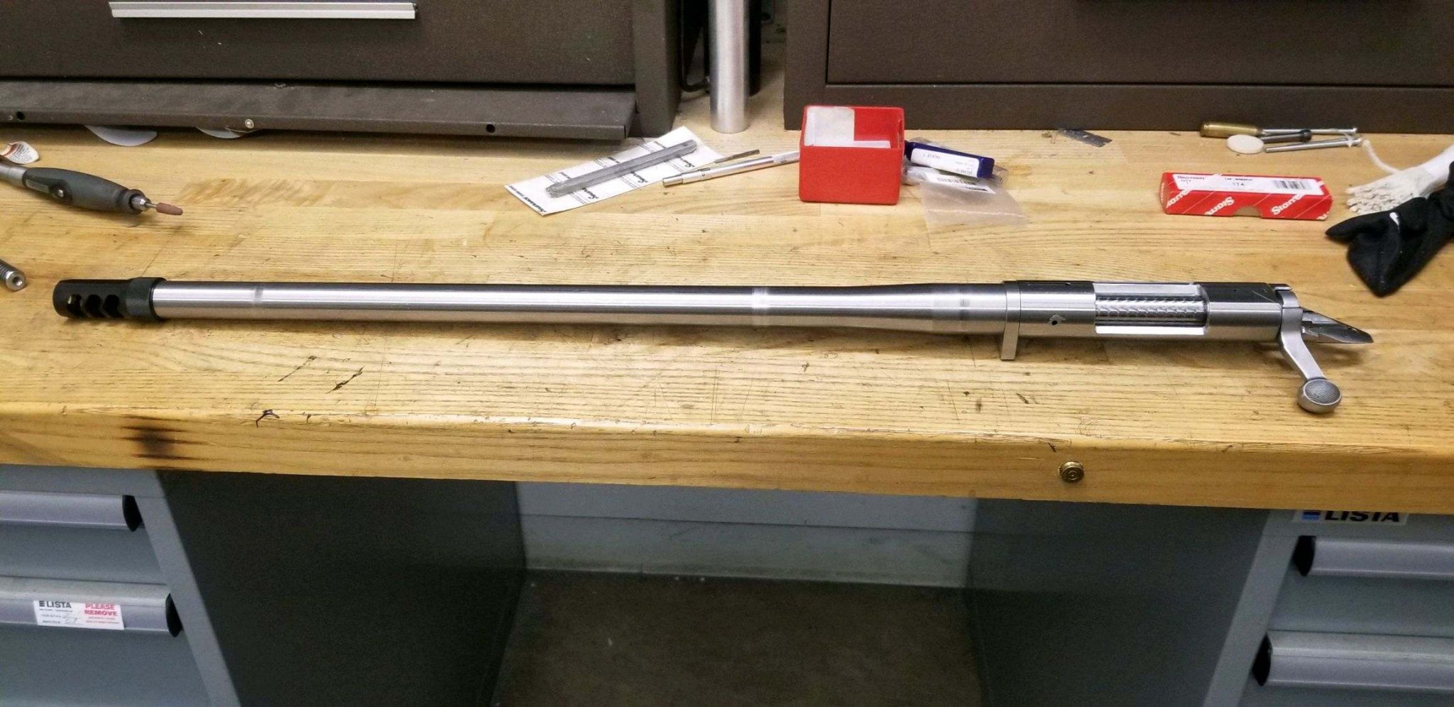

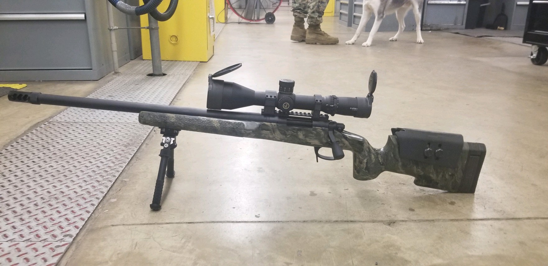

Parts breakdown:
PartDescription / Specs
Receiver / actionRemington 700LH short-action, .473" bolt face
- Bolt knob- Badger 306-31
TriggerPre X-Mark Pro (Walker) tuned by PWS
StockMcMillan A-5, LH, saddle cheekpiece, spacer buttplate
BarrelKrieger Heavy Palma, cut-rifled 1:10" 4 groove, 22" finish length, 5/8-24 threads
recoil lugBadger Ordnance 306-01M - USMC M40A3/A5 lug
scope baseBadger Ordnance 306-06L, 20moa left hand
scope ringsBadger Ordnance 306-75, 34mm USMC M40A3
trigger guard / DBMBadger Ordnance M5 Detachable Bottom Metal
scopeAthlon Cronus 4.5-29x56 MIL/MIL
Picatinny bipod railAccu-Shot BT-46
BipodAtlas BT10-LW17
Muzzle BrakeArea 419 Hellfire with 5/8-24 adapter

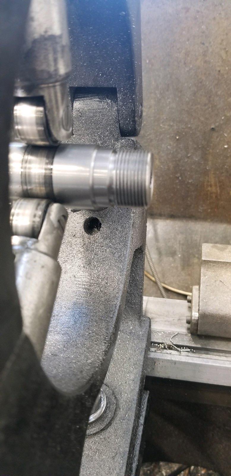

At PWS:
Finished Product. They said it's a hammer without the brake. With the brake it opened up to about 3/4moa.
Reactions: Nameless
Very, very nice rifle.
The muzzle brake has probably altered the barrel harmonics so that the FGMM isn't delivering the same accuracy node.
For quick and dirty barrel retune; wrap the barrel tightly behind the brake with #12ga solid copper wire; start with about a foot's worth.
Fire it, trim it and test fire it again; repeat as required.
Eventually you will have the proper amount of weight for the tune as the group tightens up adequately. if you trim it too much, give the smith the 'good' bits along with the existing length.
To make it pretty, have the smith weigh the copper, make an equivalent weight out of a jam nut, then install it on the threads behind the brake.
Yours, free of charge...
