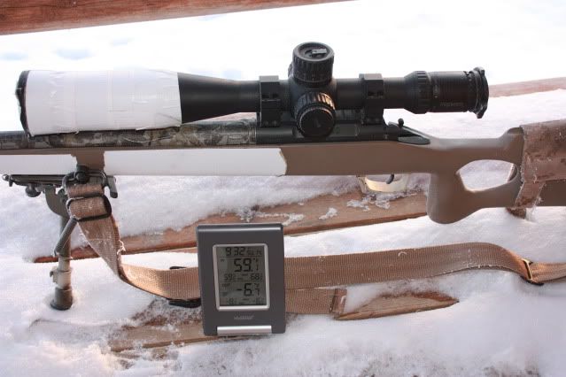

This was yesterday morning...I left it out on the deck for 4 hours prior to this picture, then I shot it and left it outside while I warmed up and gathered more ammo....

I have to admit, by the time I was done, it was about 10F. The saving grace for the shooter was the calm to 3mph wind. Humidity was about 75% and station pressure around 27.50...
The white tape is for coyote hunting. There is some on the barrel, and the inside the objective cover of butler creek. Basically anywhere to break up the outline.
