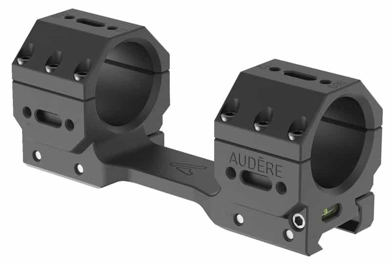

    Received a Audere Adversus Gen 2 mount with the purchase of a Zeiss S3 from MK Machining. No issues with it. Audere is not a very well known brand out of San Marino. Or perhaps I should say that I had never heard of them. Several different heights, diameters, cants and colors are available.

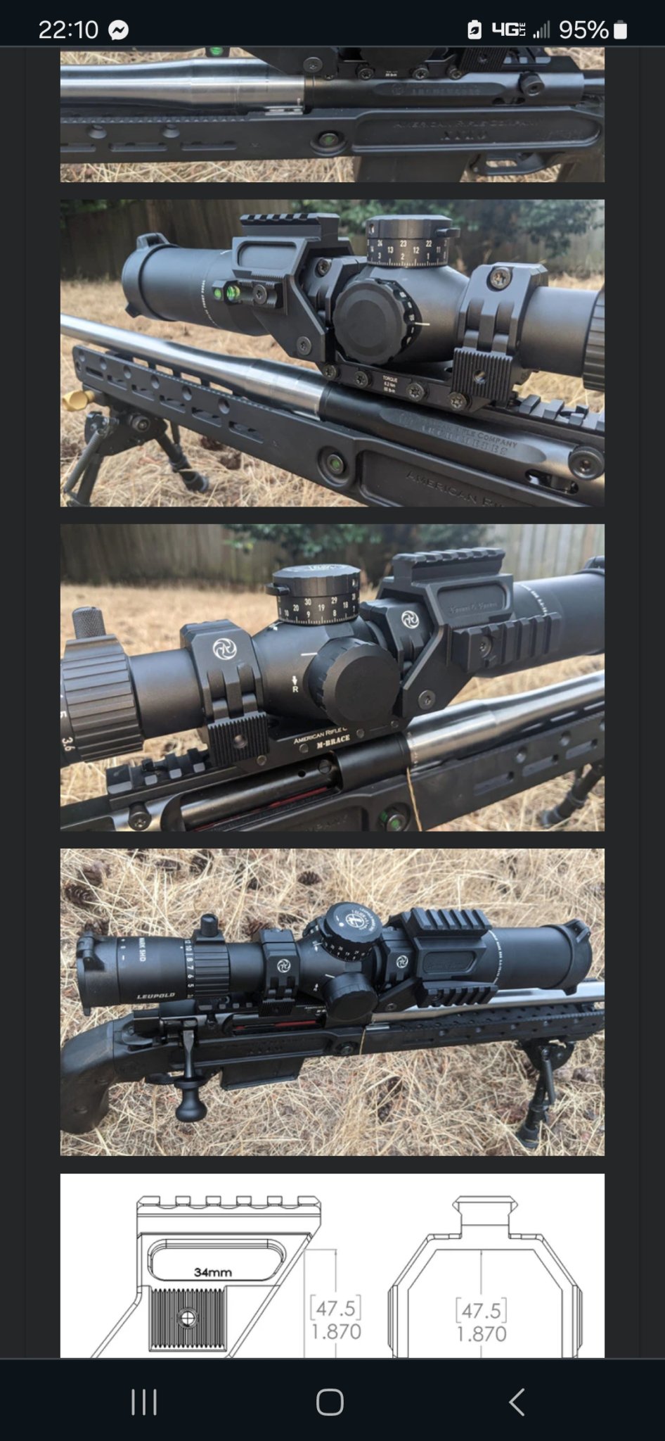

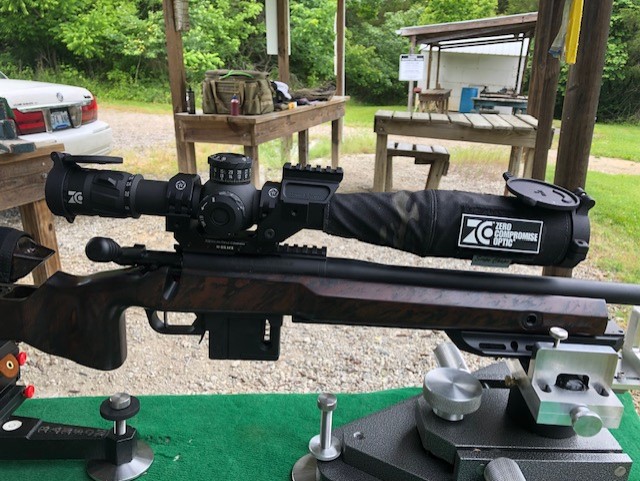

    I went with the ARC M-Brace on my last two rifles.

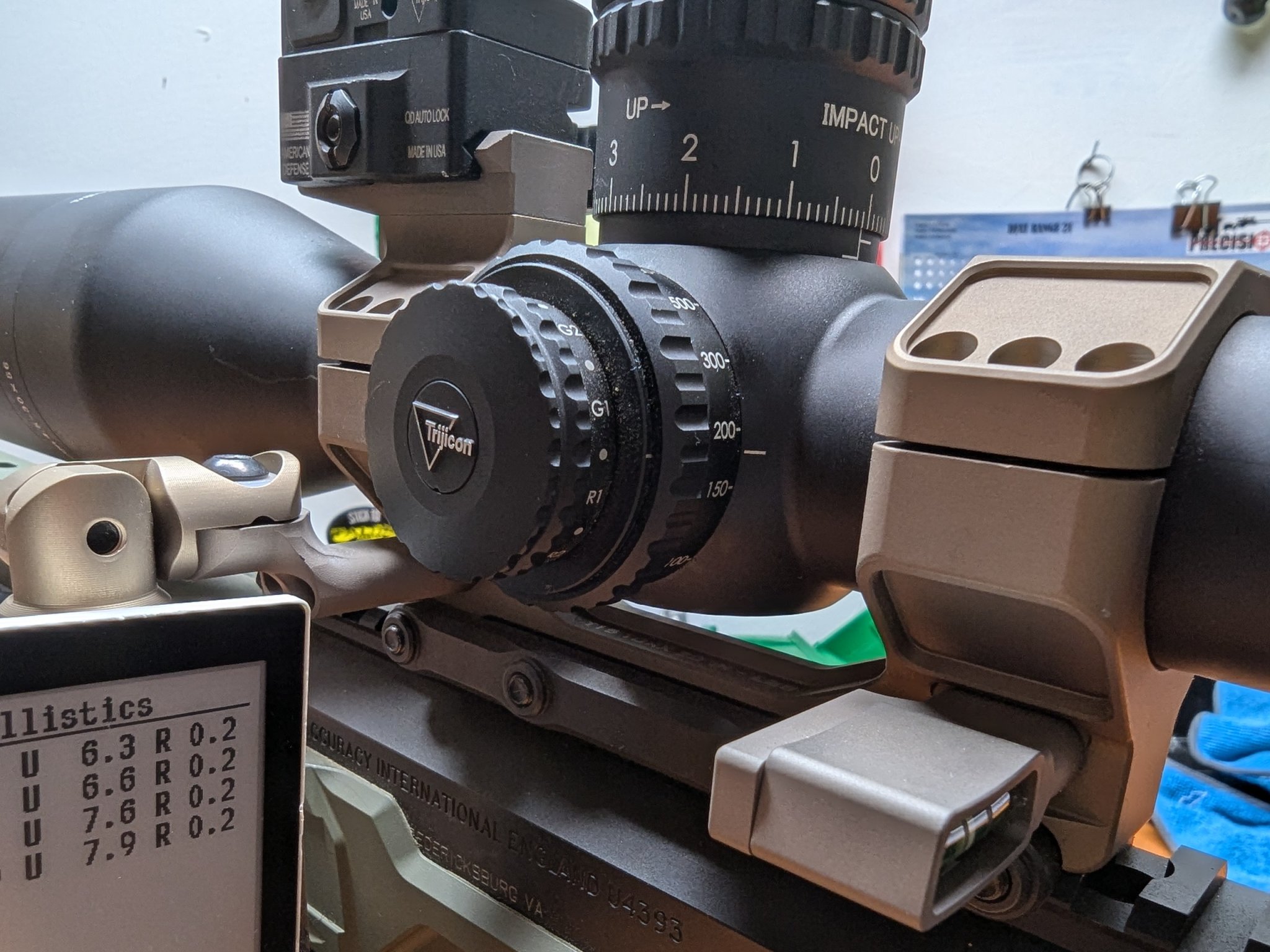

    They are super strong and precisely built; I like them a lot. 👍🏼
    I use one Spuhr for looks and own two Arc Mbrace. Love the Mbrace. So easy.

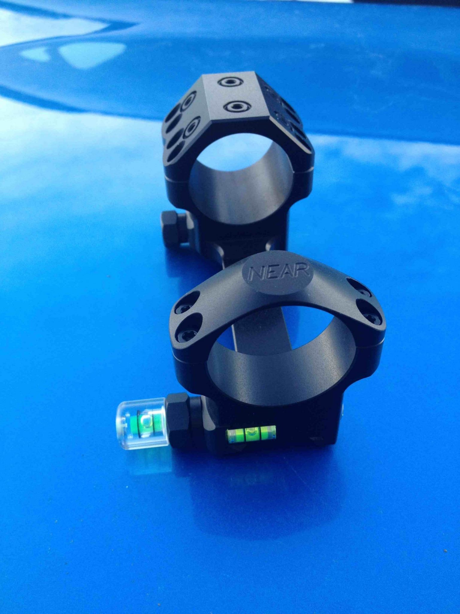

    But I have been thinking about buying a Near Manufacturing Alphamount with the Spuhr accessories compatible ring cap.
    Reg ring caps
    Richard, the owner, can make you whatever you want. He’s some genius machinist/designer. I own some of his Rem700 bases and they are amazing. He loves TRG’s.
    One thing he’s not is a web designer or e-commerce wizard. He runs two sites (below). Call him, trust me, call and don’t email. He loves to chat and ships fast.
    Same here. I have several Spuhrs, and an Audere that was rebranded for "Hoplite" arms (now that was a train wreck), and have recently gotten an M-Brace. I'll be moving to M-Brace from here on out.

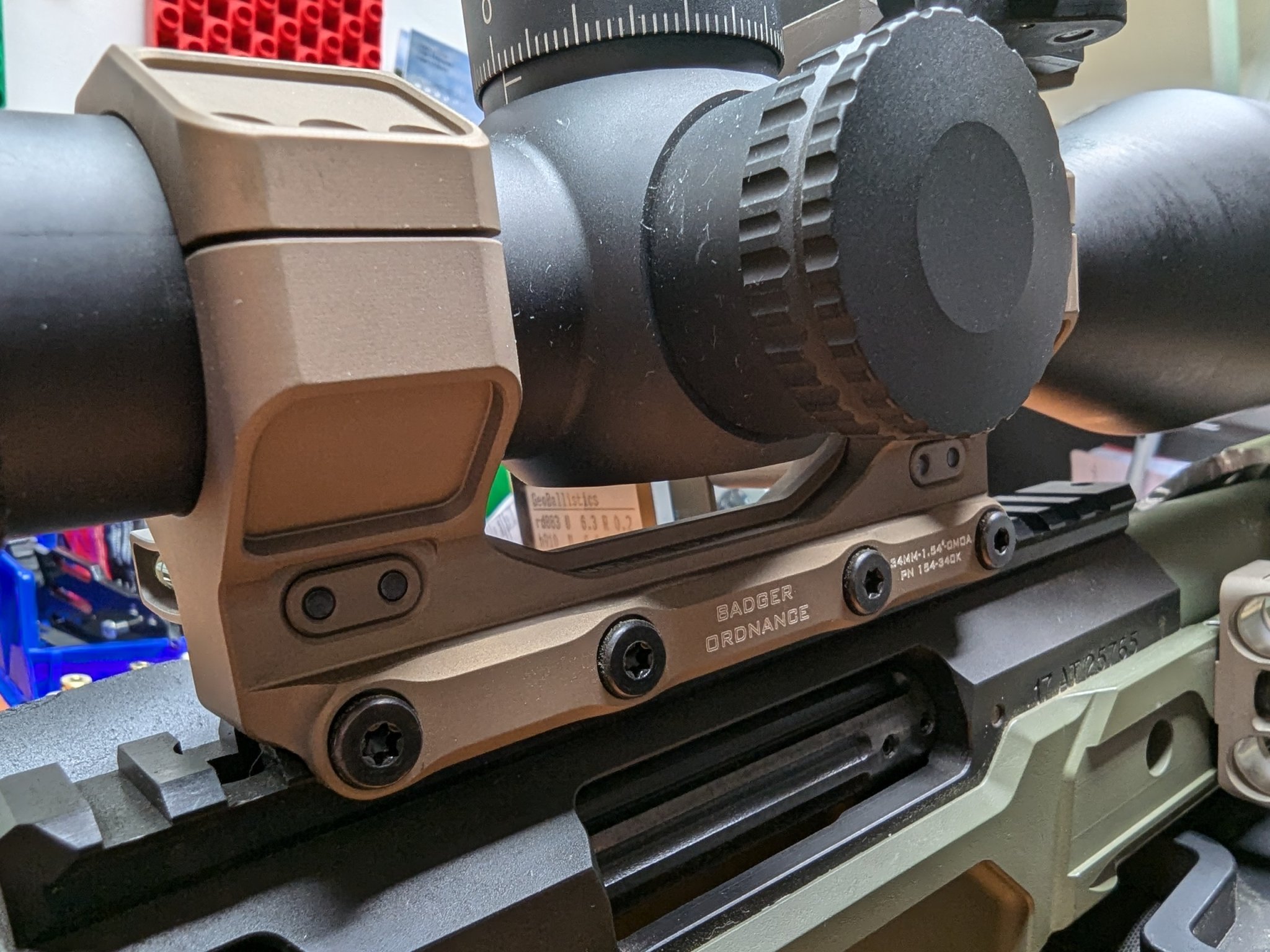

    I used spuhr exclusively for about 12 years, but after dealing with 5 cracked clamp bars between 11 Spuhr mounts over that time period I switched them all out to ARC M Brace on the guns that didn't need cantilever mounts and badger C1 on those that needed a cantilever mount. (Before the thread sidetracks about my 45% failure rate with spuhr, I was not adding lube to the hardware and my mountz torque drivers get checked 3-4 times a year in the NIST-traceable calibration lab at work, so it's not user error or a crappy out of spec torque driver overtightening the hardware.)
    Happy with both the ARC and badger mounts, although I wish the badger C1 cantilever mounts had the clamp bar and low profile clamp hardware from the non-cantilever C1 max mounts instead of the smaller individual clamps and protruding nuts.
    One negative to the ARC mounts is that if your scope has a very low profile elevation turret, the thicker top of the ARC rings can block your view of the turret and the alignment hash mark when behind the rifle. Some aren't happy that ARC doesn't offer any accessories for them yet (offset red dot mounts, etc) but for me that's not an issue. Also, their LRF mount is really stout and doesn't impart any additional load into the front ring cap or scope tube (unlike pretty much every other LRF mount out there.)

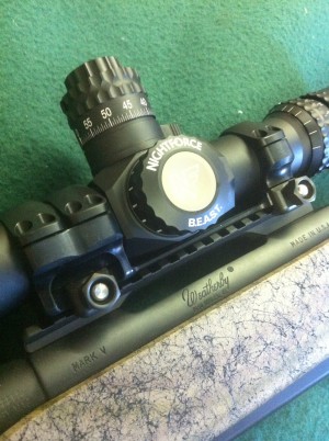

    Best I've ever been behind is Nightforce. Their top half of the rings just disappear and give an actual good view of the turret. I know a lot of companies claim to have a clear view of the turrets, but nothing comes close to beating Nightforce.
