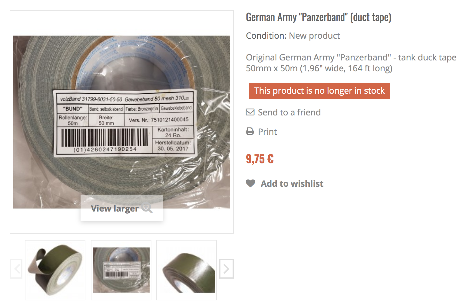

I use a German QR called Panzerband on my Henny. Highest speed lowest drag bruh.
Reactions: Boltyboi
