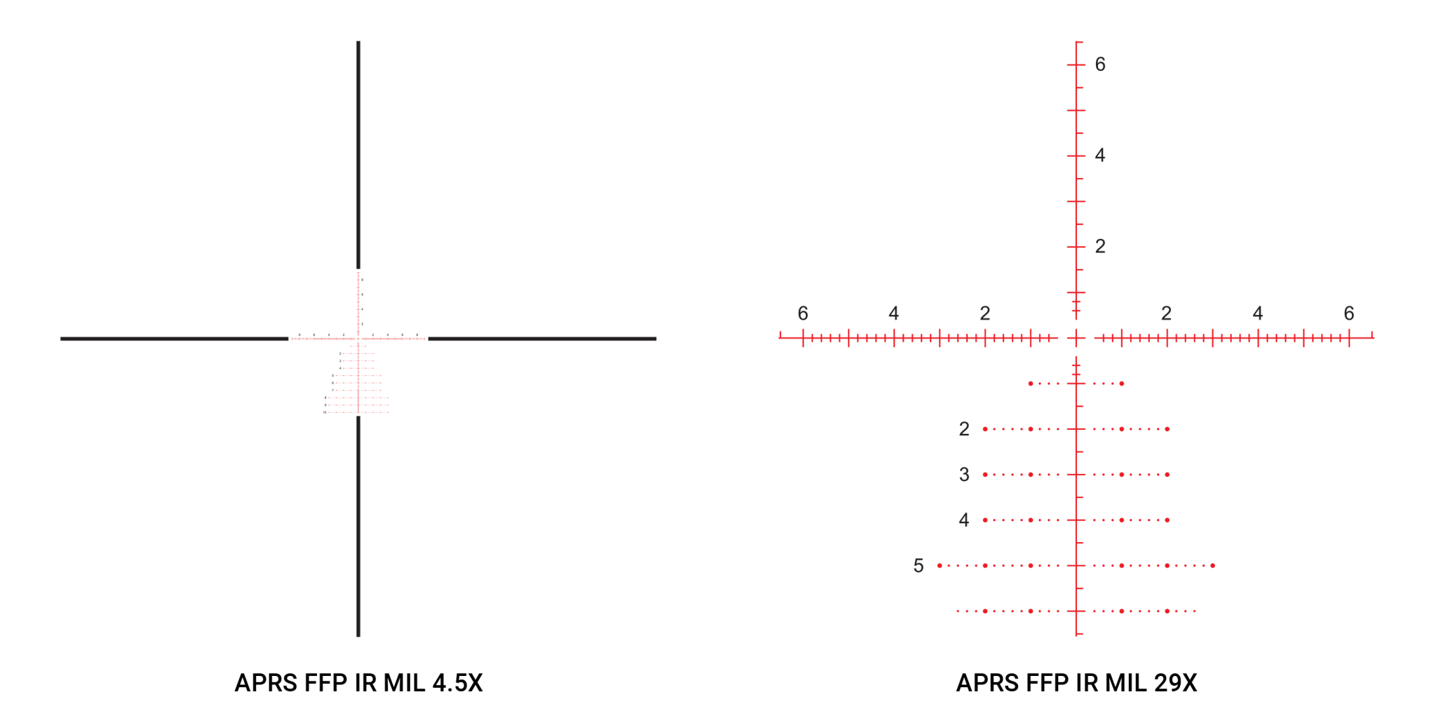

Personally I don't like the solid line as much as the floating crosshair. I have the APRS MIL in my Cronus and like how the floating cross draws my eye to the target. I prefer that, or a good size dot like the TT Gen 3 XR (I dont have the floating dot model) for quick acquisition.
