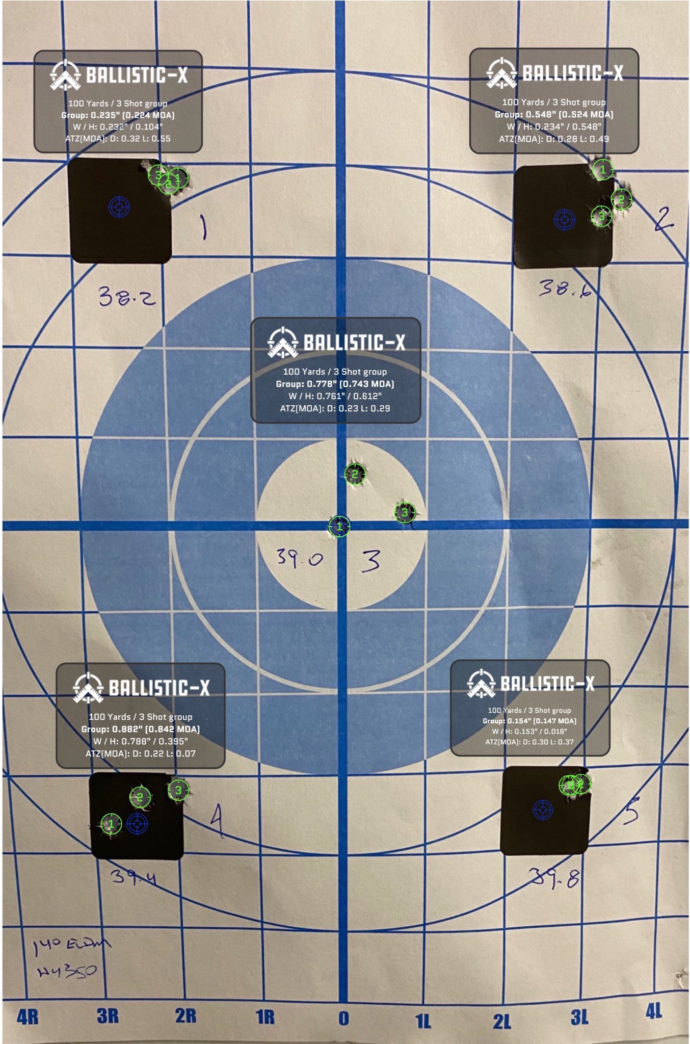

This is the load development target from the 12FV Cabela’s rifle. Shot in -20F temperatures on New years Eve 2020.

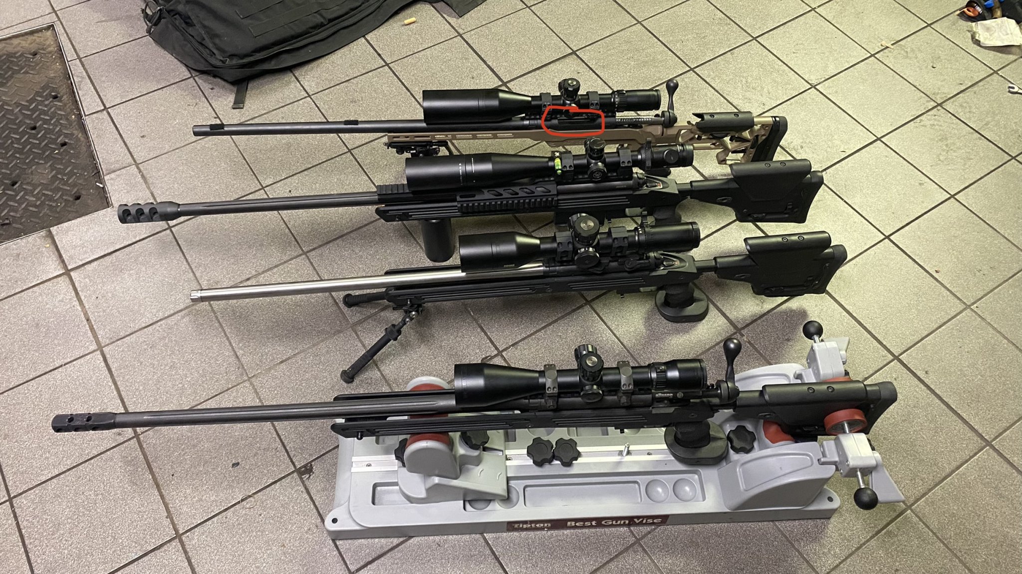

Some of the Savages before the bolt knobs were replaced.
I can’t help also posting my favorite picture of my Savages with the Tangent Theta and Schmidt & Bender.

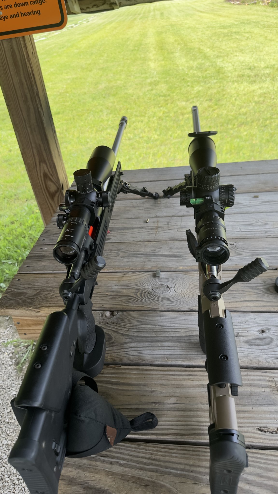

I even have pics of a tangent on my savage lol because why not.
