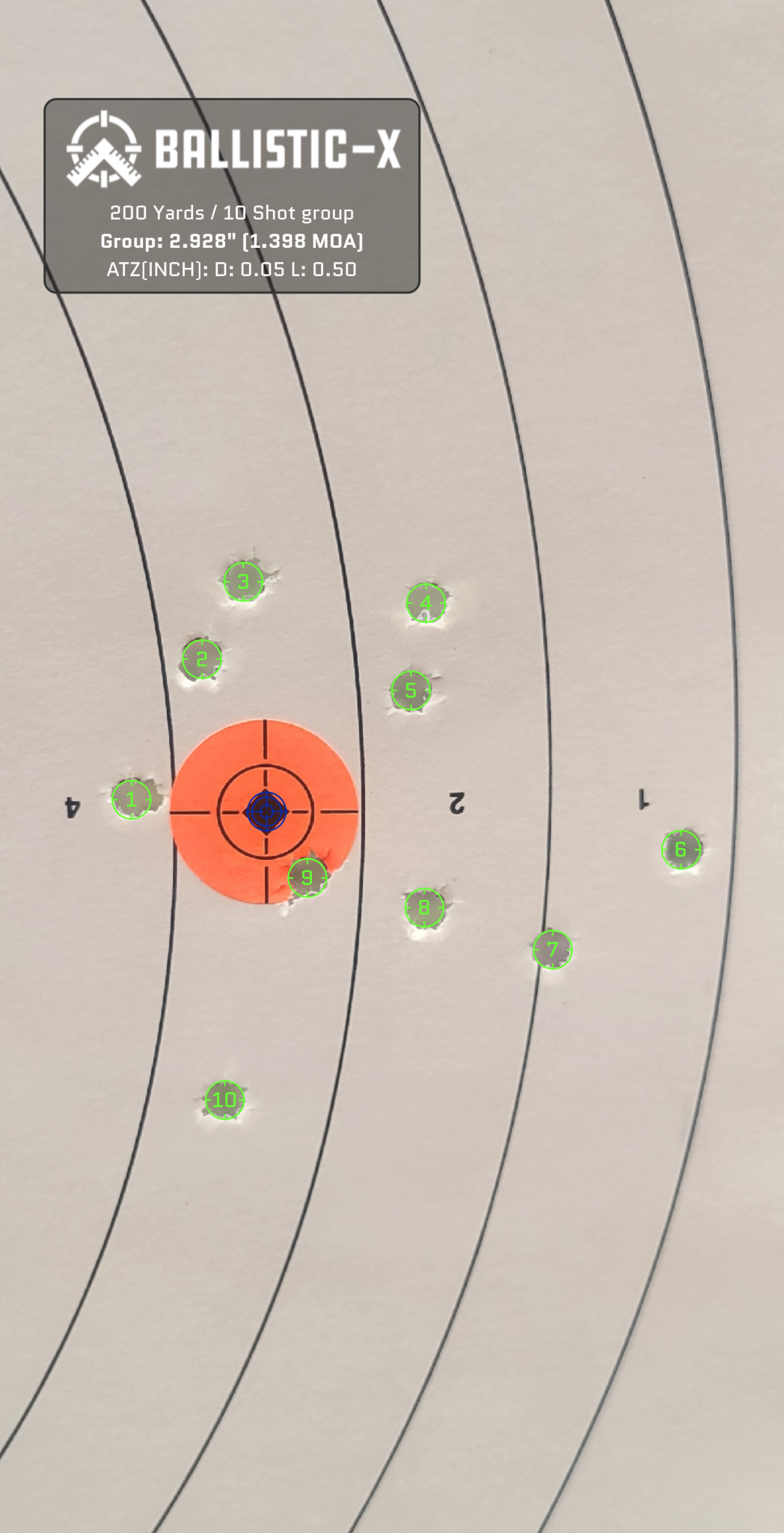

Leaving the ethics aside, I have an older Rainier 18" SS Ultramatch 223 with 7.5 twist and Rainier Match Chamber. I took it to the range today for the first time and using basic factory ammo (PMC 223A 55 Gr FMJBT) at 200 yards I got the below which I find quite promising to start with.
For the moment I am not ready to reload yet. With that in mind what would be the recommended bullet weight and if possible brand of factory ammo to run through this barrel to tighten the groups? For reference, I've made only 4 - 10 shot groups today and they all were in 1.4-2.1 MOA range the below being the best.

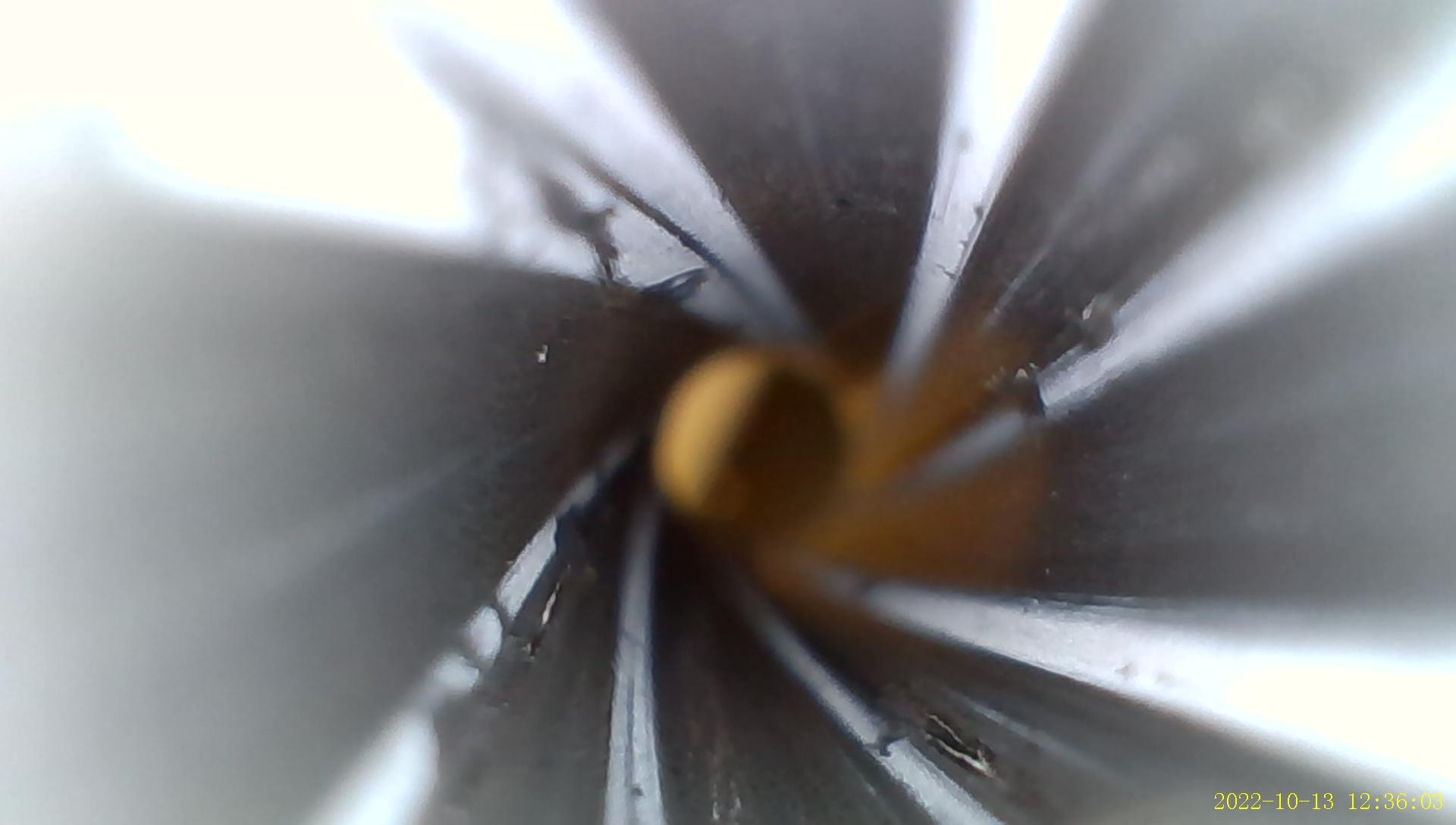

I had a pretty bad experience with their barrels. Sent it back after dumping money into my gun trying to figure out why I couldn’t get their sub MOA guarantee. Sub 200 rounds through the barrel
Asked them to bore scope it and received this from them. They said they had a bad batch of material for some of their barrels. Their CS was great, but the replacement I got wasn’t. Gas port wasn’t drilled completely through.
I used some pins and realized it was undersized, either drill bit broke through just enough or there was a burr on the inside that constricted flow. Either way, I was 2/2 on bad barrels from them. Ended up drilling it out myself just to not deal with them again.
Barrel seems to shoot right at 1 MOA, but I would look elsewhere.

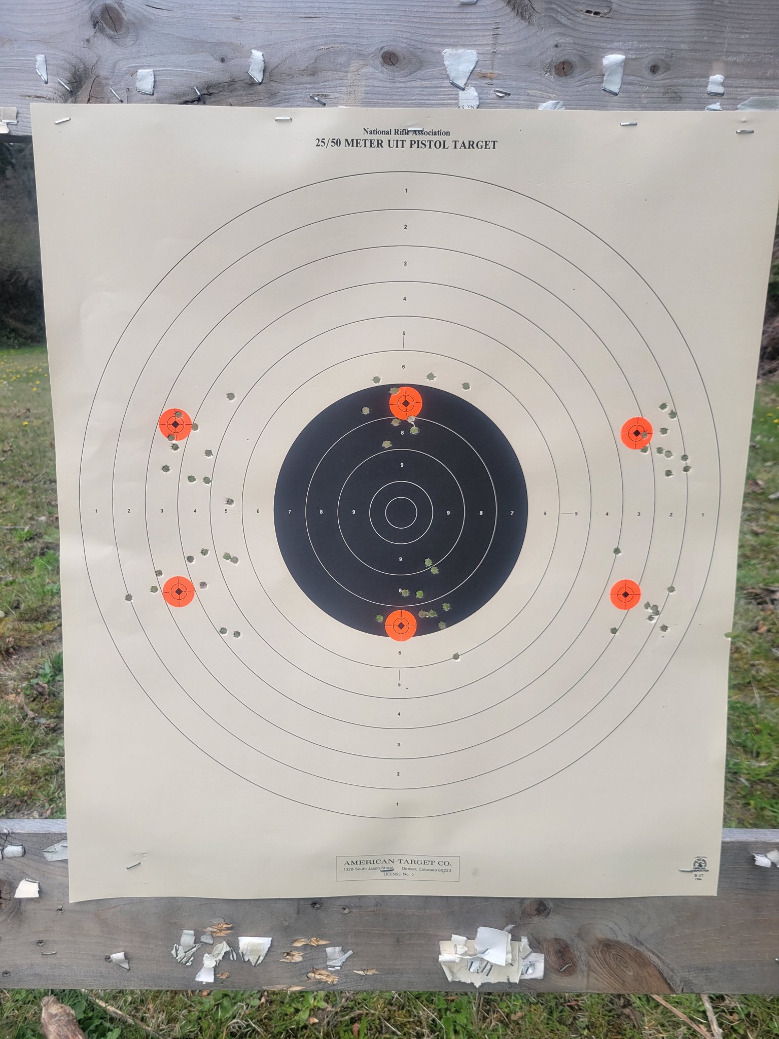

I'll beat this horse a bit longer. We had a pretty calm wind weather at the range today. Below is a target with 60 rounds at 200 yards. Two left are Hornady 68gr that I feel like the barrel doesn't really like too much, four on the right are AAC 77gr OTM (not the Sierra). Shot from a bipod and squeeze bag. I could probably get it tighter should I take my time and/or take 5 minute brakes between the groups, there were a few flyers where I can take blame.
Is it great? No.
However, for an average and still pretty fresh to this stuff Joe, using ~50cpr factory loads, and not stressing about it at all - if I'm able to get consistent 1-1.5 MOA 10 shot groups then I'm happy about it.
