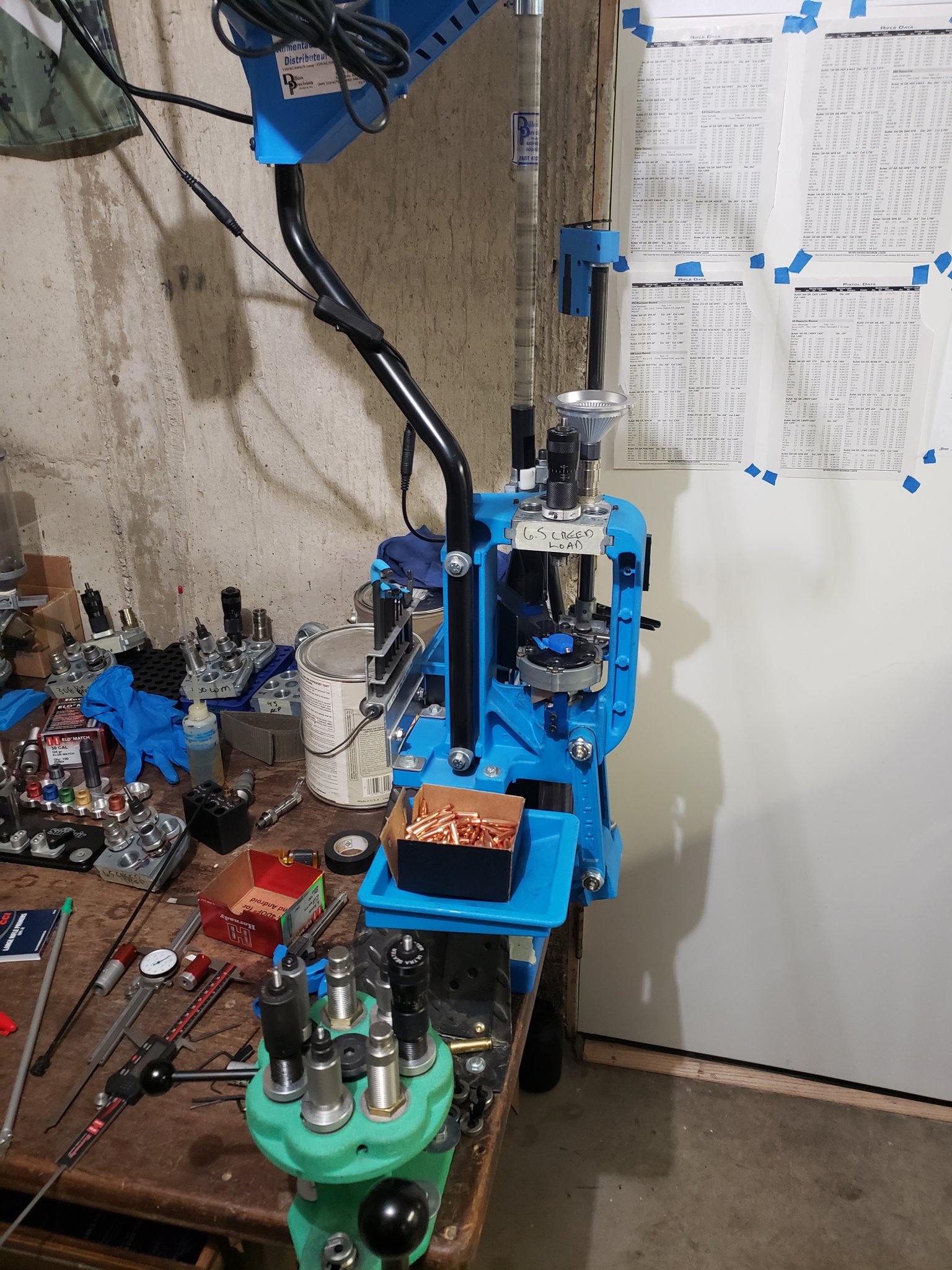

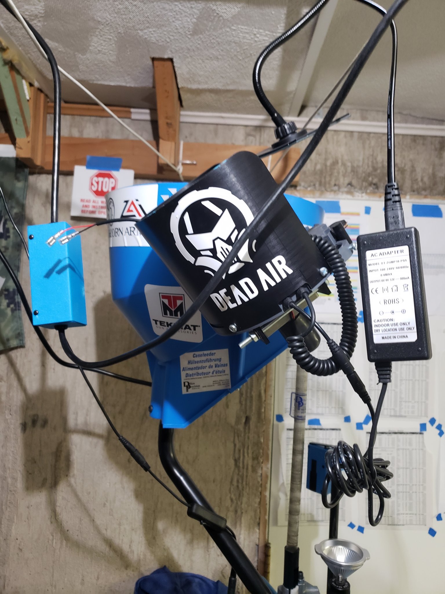

Sure bro can u gaurentee those powder charges are + or - a tenth a grain. I can cuz i weigh each one. Right now my load for my 30 has a es of 8 and sd 4.4
I do...cuz they are weighed and thrown with an autotrickler v3 on an fxi120
So your post is misleading. Your using that progressive press like a single stage. All i see is a powder funnel and a seater die. So if i had the same auto trickler i can do it as fast as u
False....I deprime, size and trim in one pass. I can do 500 6.5 cm cases in about 15 min.
Toss them in the tumbler to clean for an hour. While they are cleaning I load my primer tubes.
Pour cleaned brass back into hopper and I will load all 500 cases with bullets, primers and powder in about 1 hour and 15 minutes if I'm just chilling....so you are 2.5 hours to do 500 rounds of match ammo prep through loading...nothing single stage about it and no way you could do it as fast as a progressive lol

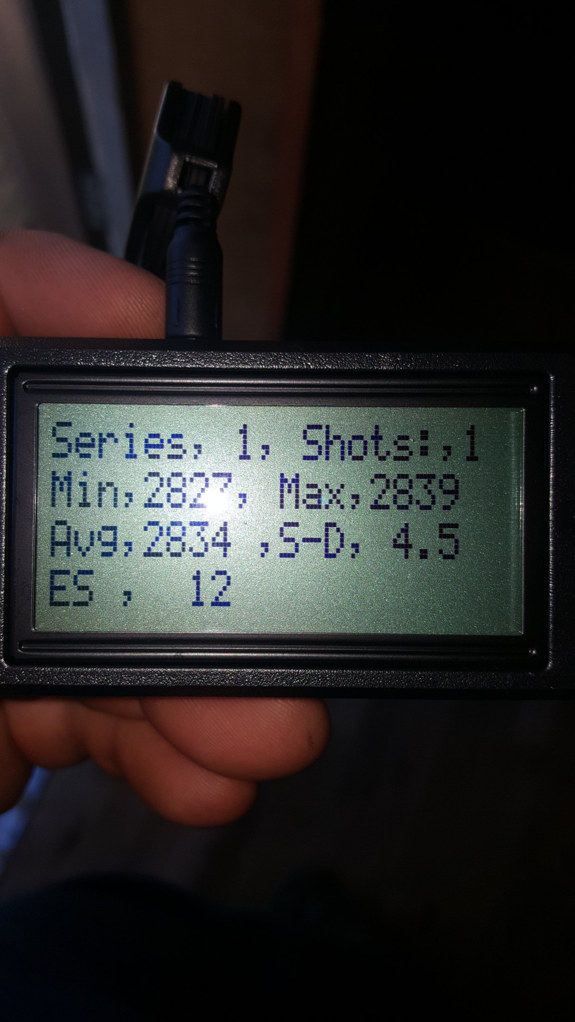

Out of curiosity what kind of shooting do you do? Some casual prone? PRS? F-class? and how big are your groups? What is your SD and ES?
I want to shoot prs but this year is shit, im shooting 175grain sierra matchkings out of 30inch krieger barrel on a ruger rpr. Im getting mv 2834 sd 4.5 es 12. Thats on a 10 shot string, heres a picture of my magneto speed with that data. On a 5 shot string i had es 13 and sd 6.6
Are you happy with those numbers?
Nah. It is just that it doesnt seem that you NEED a new press. You have good groups and numbers that you are happy with?

So...I currently have the T7 but am looking for ways to speed up process and not lose accuracy. For you guys using Dillon, what does your process look like? I assume you clean and anneal all your brass before it gets loaded into the Dillon case feeder for sizing, charging, and seating?
Anneal fired brass
Put brass in gallon Ziploc bag and spray down with alcohol lanolin lube mix
Dump brass into hopper
Install Prep tool head...size/deprime, trim, expander mandrel
Toss brass into corn cob tumbler
Toss brass back into hopper
Install Load tool head...prime, powder,seat bullet
Done
