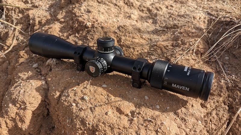

My research for a 20” barreled White Oak Armament SPR upper in .223 Wylde has led me to the Maven RS1.2 - 2.5-15X44 FFP with SHR-MIL reticle:
I will make my purchase after I hear back from Maven confirming or refuting the reticle line thickness data in this article on Rokslide:
