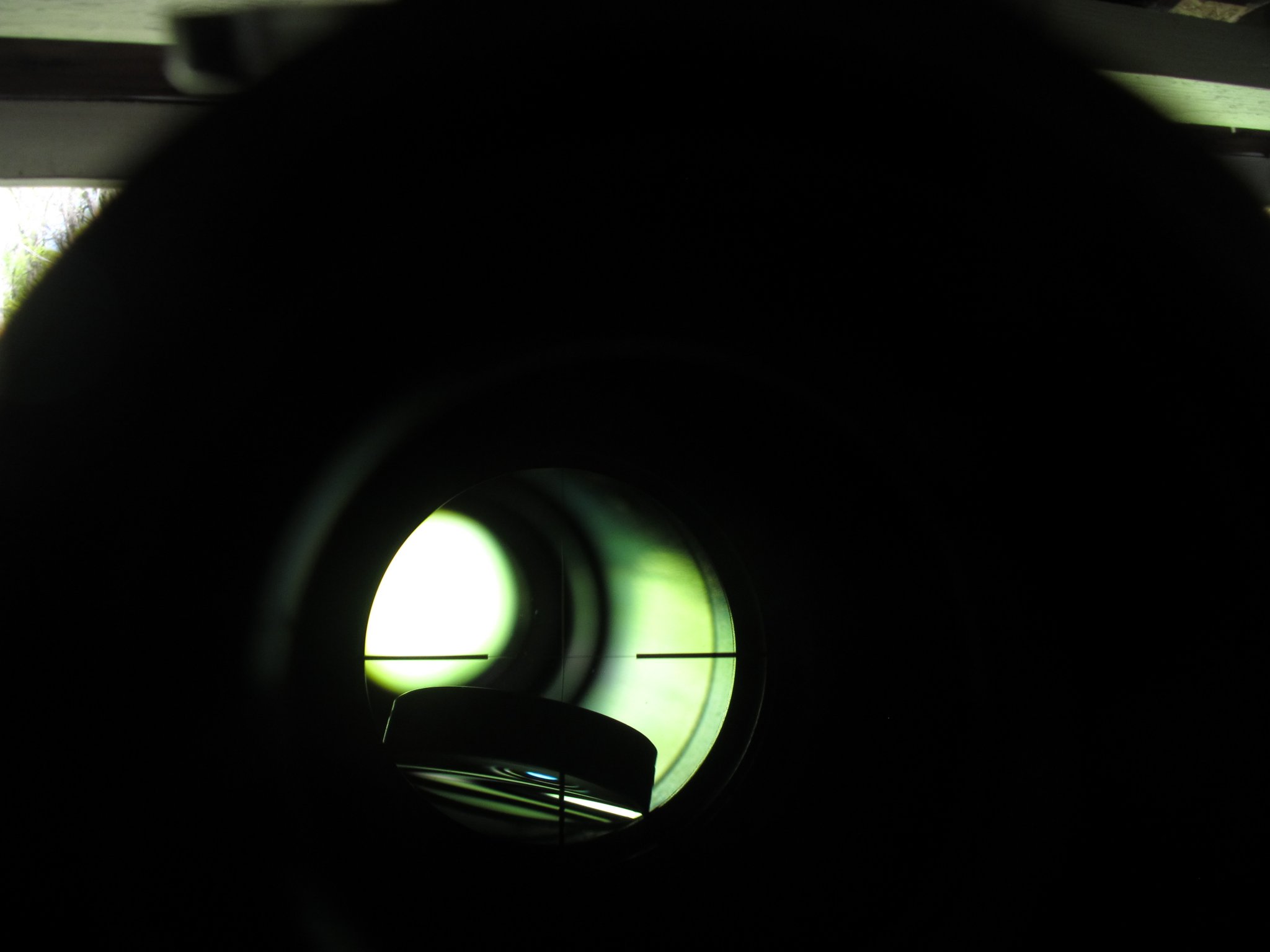

My Kahles K624i is boxed up and ready to be shipped back to Austria for repairs. When you turn the magnification dial, the reticle jumps approx 0.3 mils. Very visible on high magnification. If you just turn the mag dial back and forth a few degrees the reticle jumps up and down (and a little bit left/right).
I spoke to Kahles and they'll check it out and likely (hopefully) take the blame and repair it free of charge.
Is there somebody here who could tell me how this happened? Have I overtightened the turret screws or something?

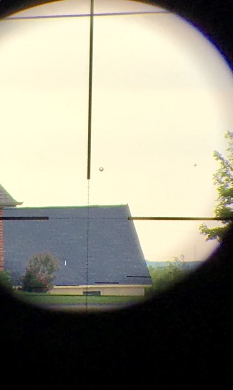

Vx5 canted reticle and 50% off in tracking wouldn’t hold zero. Sent it in they said nothing was wrong with but the reticle was straight. Vx2 cds wouldn’t track or hold zero.

View attachment 7904314Schmidt and Bender PM II 5-25. Two days after getting it and on the first outing with it. Grease specs on the lens.
A buddy of mine has a S+B, one of the earlier ones. Says its one of the best scopes ever. I believe him.
You don't realize that the scope is so good you are probably seeing something the naked eye can not. Those are orbs. UFOs or spirits, your choice. 😜
Well, the goods news is there is no physical damage. The bad news is that you have to send it back to get it cleaned up. Oh well, "QC" :rolleyes:.

This was from a few years back. Sent it to the repair center in Va. and had it back in a few weeks.
