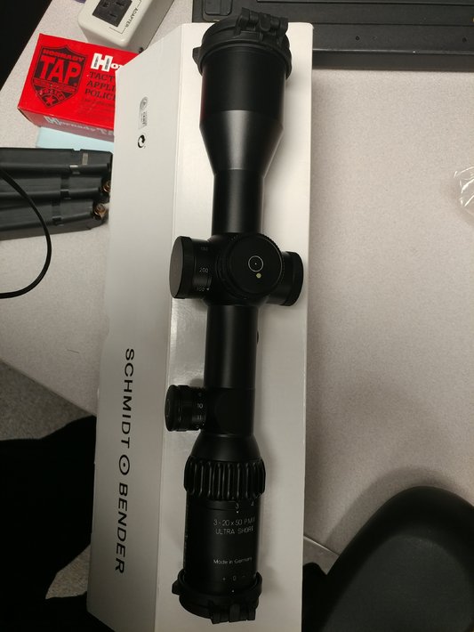

Thanks to everyone for the suggestions. I was stuck out of town for several days, but I am back and appreciate all the input. I found a class I want to attend coming up in November so I will make a decision soon and get something ordered so I can be as prepared as possible.
Well it pays to ask for good advice. I went back and forth on this, alllmost pulled the trigger on a Mark8, but when I got a screaming deal on a new S&B 3-20US I had to jump on it. It arrived today, I've got to get a mount ordered tomorrow and try to get it zeroed next week. Thanks again to all for the help, especially wjm308!
