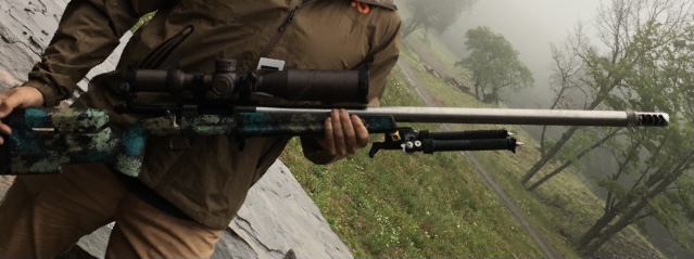

One of @b6graham rifles. He likes them Thicc

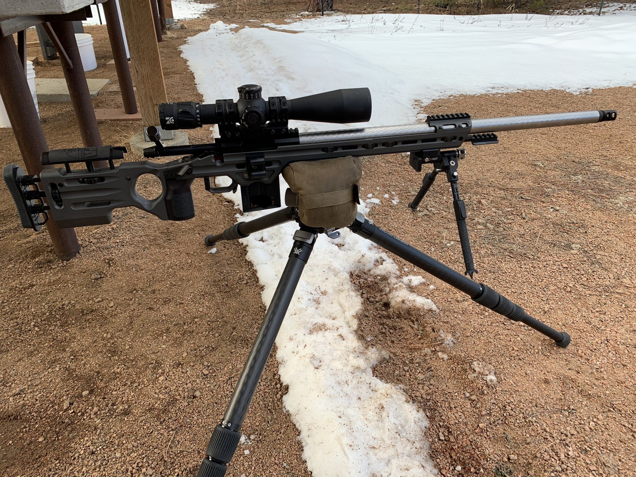

I run 26” in Heavy Varmint (whatever the manufacturer du jour is calling a 1.25”x5” shank and a single taper to 1” at 27”…I think Bartlein calls it a #9). With an Ultra 7 out front it’s annoyingly long anytime the barrel has to go out through a port/window. Might do the next at 24”. With just the brake, 26” is fine.
