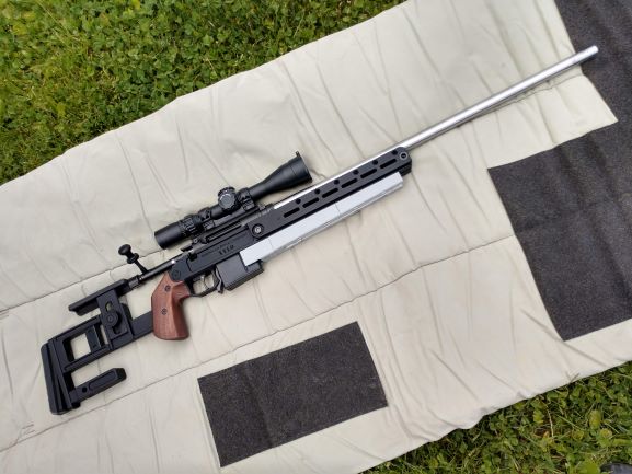

    I'm using an American Rifle Company XYLO chassis for my NRA Highpower rifle. It's pretty easy to adjust the stock between stages.
    I added the 3D printed riser on the bottom for a little additional height in standing and sitting. I wish I could move the butt plate to the side a little bit, like with my Eliseo chassis, but this is still really good.
    To clarify, the butt plate on the XYLO moves in/out, up/down, and it rotates left/right a few degrees.
