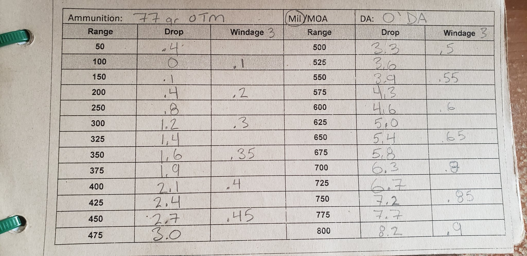

I view my data book as essentially two data books in one with some pages acting as an admin/data collection book and some pages serving as a field/quick reference data book. The data pages where I'm logging hits and taking notes is the admin side that is helping me track trends in the dope, correlate that to changes in DA and anything else related to the ammunition, shooting position, etc.. After a little bit those admin pages feed accurate data to dope charts based on DA so that I have a hard copy reference for the dope if I ever need it. Likewise, I can use those admin pages to affirm that the dope my Kestrel is giving me is accurate, building confidence in the system or I can use it to note deviations that I need to work on truing out.
This is an example of a data book page for my SPR:
That data confirms my electronic data and feeds a hard copy summary sheet that's easier to reference at the front of the book:

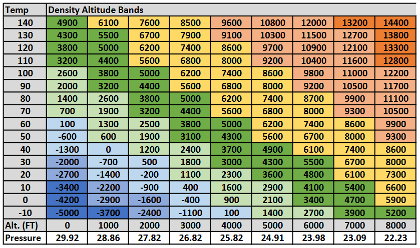

If I don't have my Kestrel and I need the DA I reference a chart like this one to get me in the ball park:
