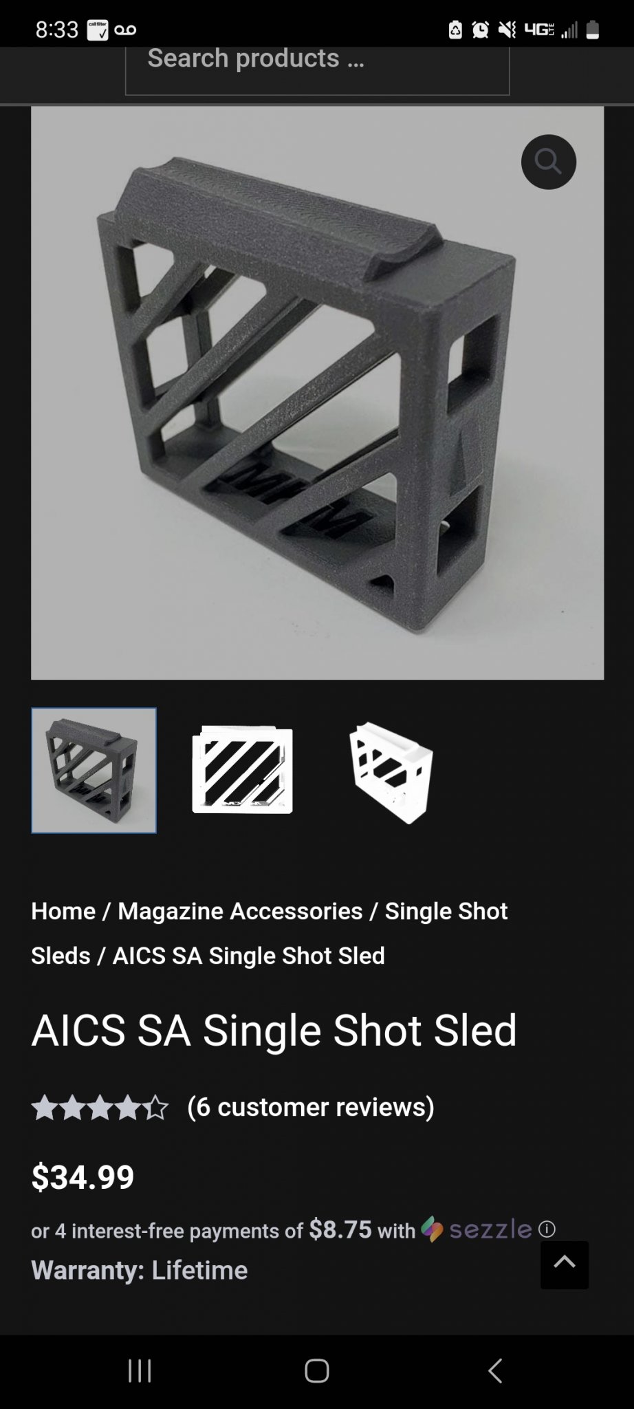

I use the MKM magazine sled with my Origin.
I tried single feeding once and mine did not go over the rim. Now, I didn’t push very hard for fear of damaging the brass. Does the sled let the round sit lower than the top of the AICS magazine does?

Update: I ordered the MKM single load adapter last night. Today, I tested with Magpul AI mag. Throwing a round on top of the mag won’t feed. However, if I place the case head on the follower and tip into the start of the chamber, as was suggested, it feeds. Downside is, i cant just throw a round in there as I can with other rifles. I think the adapter may fix that issue.
Thanks for everyone’s responses, I will update when adapter arrives.

The MK Machining sled showed up yesterday so I tried it today. Feeds like warm butter!! I’m guessing I am just not willing to put enough pressure on the bolt to snap the extractor over the rim. I’m happy using the sled, so no more worries. Thanks for all the responses! Really love this action! Wish there was a Lapua bolt face for the LA!

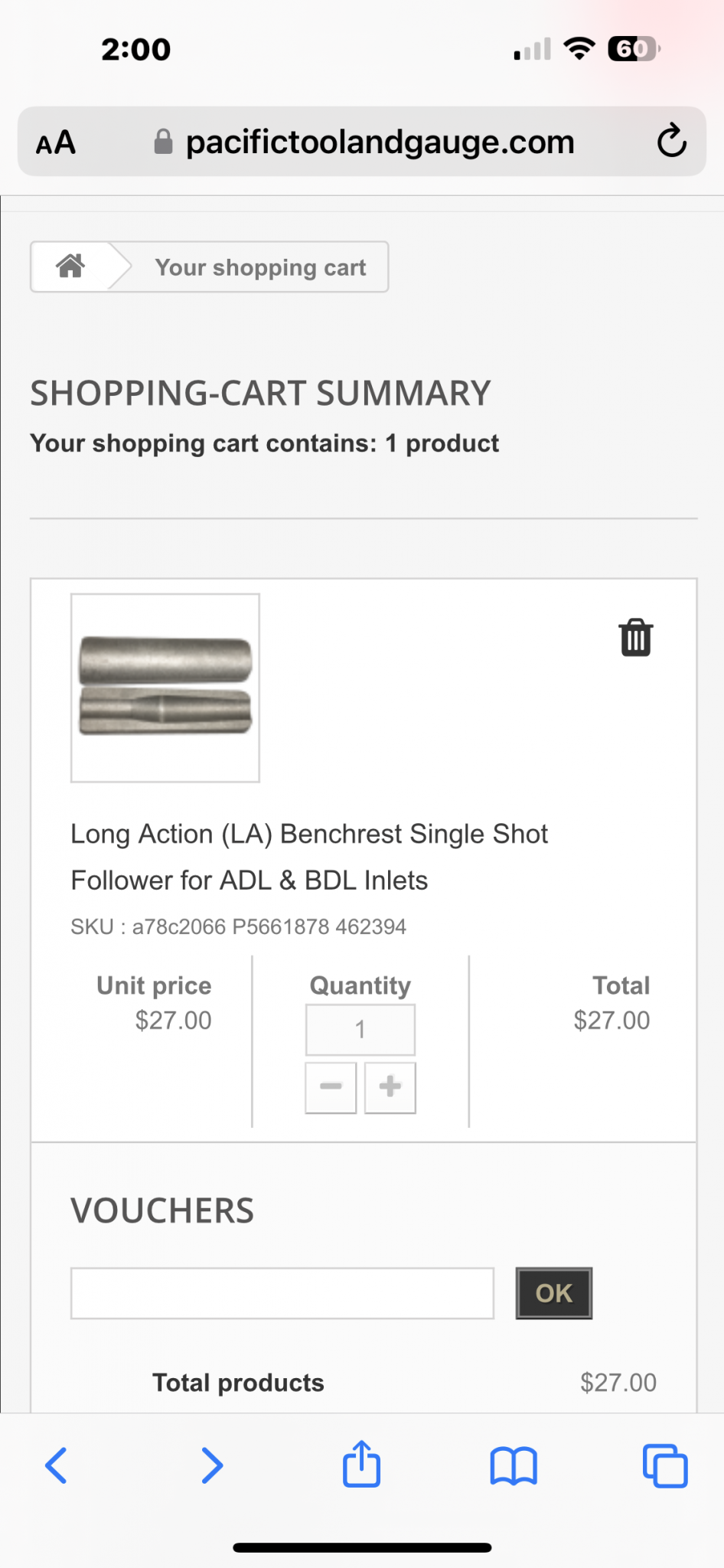

I know this thread is a year old, but I have a LA Orogon that I am switching from a chassis setup to a backup Fclass type setup w a wood stock. Has anybody run one w a single shot follower? I’m doing this to get my boys or a buddy interested in that type of shooting and will have another rifle that I can take or even use as a backup if needed.
I’m running my SA with MK Machining single shot sled. It feeds great. Occasionally, the rim doesn’t go under the extractor and the bolt is very hard to close. I believe the effort is snapping the extractor over the rim.
Thanks. I’m needing something to drop into an Fclass stock with no magazine well… I think I found what im
Looking for at Pacific Tool and Gauge (PTG).
