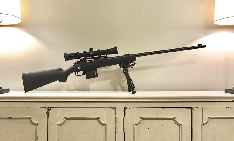

I just received my conversion back from Elrod. Haven't had a chance to shoot it yet, but I have never been more excited about a gun than I am this one.
Cant wait to get some rounds through it!
Will be sending Jonathan another barreled action this wee for the conversion.

Shot mine at a local match last weekend. The format is 43 targets in 5 minutes. You can fire 50 shots. Targets were biathlon type from 60-225 yards. It's a real speed test.
I was running the bolt as hard and fast as I do on any slick feeding bolt gun...pretty fast. I had one hiccup with ejection that probably cost me the win (empty got stuck on the far side of the receiver requiring the mag to come out to clear it). Aside from that bit of bad luck, the thing runs as fast as anything I've shot. In fact, it seems to feed better the harder you work it.
Its far and away my favorite rifle.
Oh, cone breach, EPS reamer.

The rifle that won again this year is an Elrod repeater using the same reamer and cone breech as Tims.
