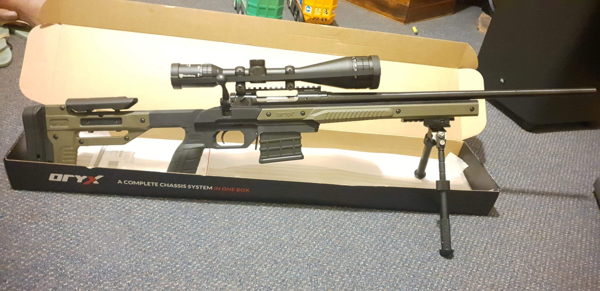

No idea since I've never tried the Oryx. But an RPR stock won't fit a savage so I'd go with something else one way or the other. But that's all beside the point now. Ordered one last week, came today. Quick change over, other than trying to get the blind box off the action. Magazine goes up too far, catches the bolt and won't let it go forward. So when you insert the mag you have to make sure to pull it back down to the catch. No big deal. Seems to feel good, raised the cheekpiece and added 2 shims in the buttstock, think I'm ready to go try it out. Just wish I could have gotten it in a different color (without having to order extra panels!), don't care for ODG, but oh well.

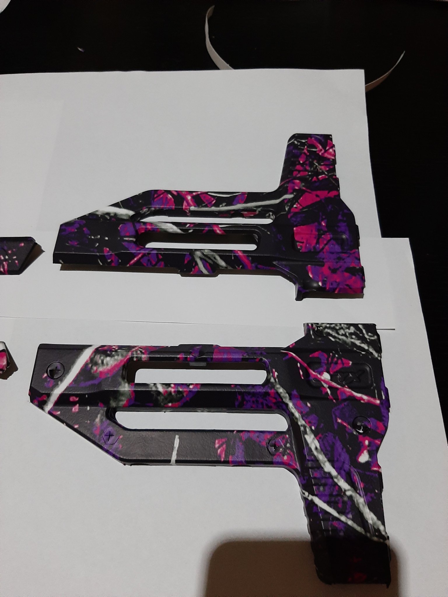

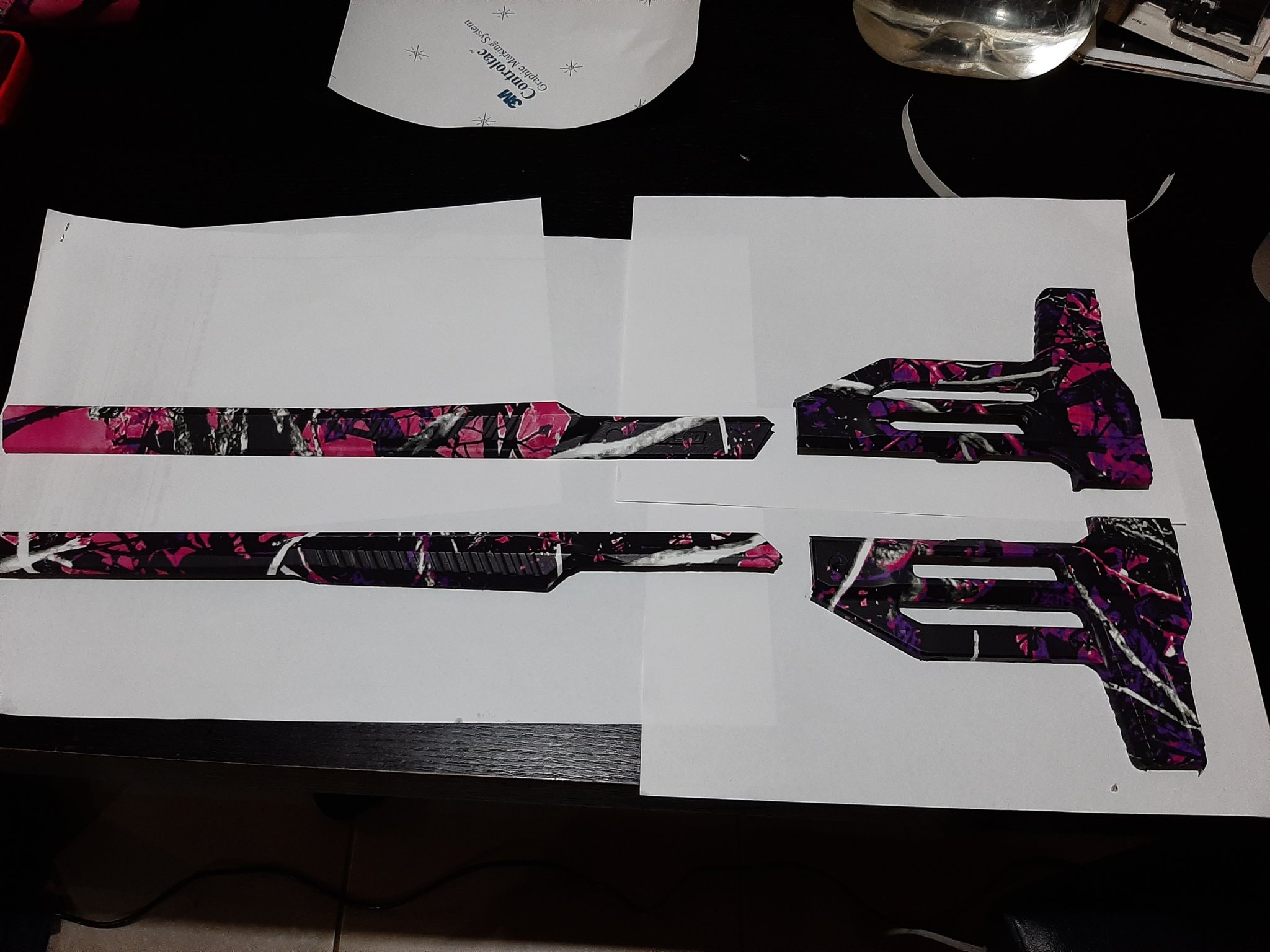

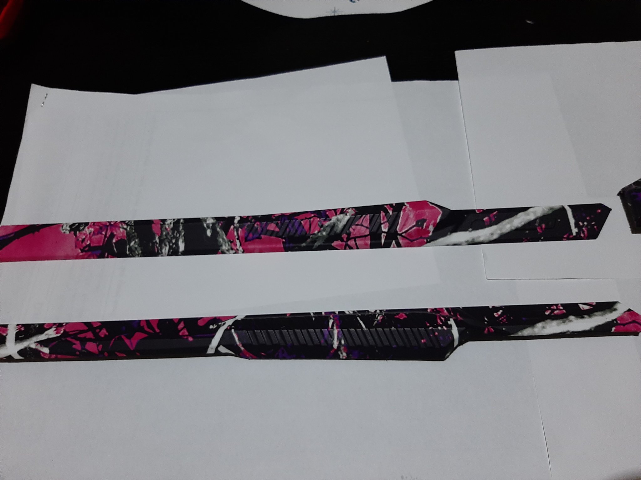

This Is my wife's Stevens 200 (Savage 10) .223
It was torturous trying to find a new stock then we would the MDT Oryx. It gave it a full make over and she loves it. She didn't like the OD Green so i wrapped the panels.

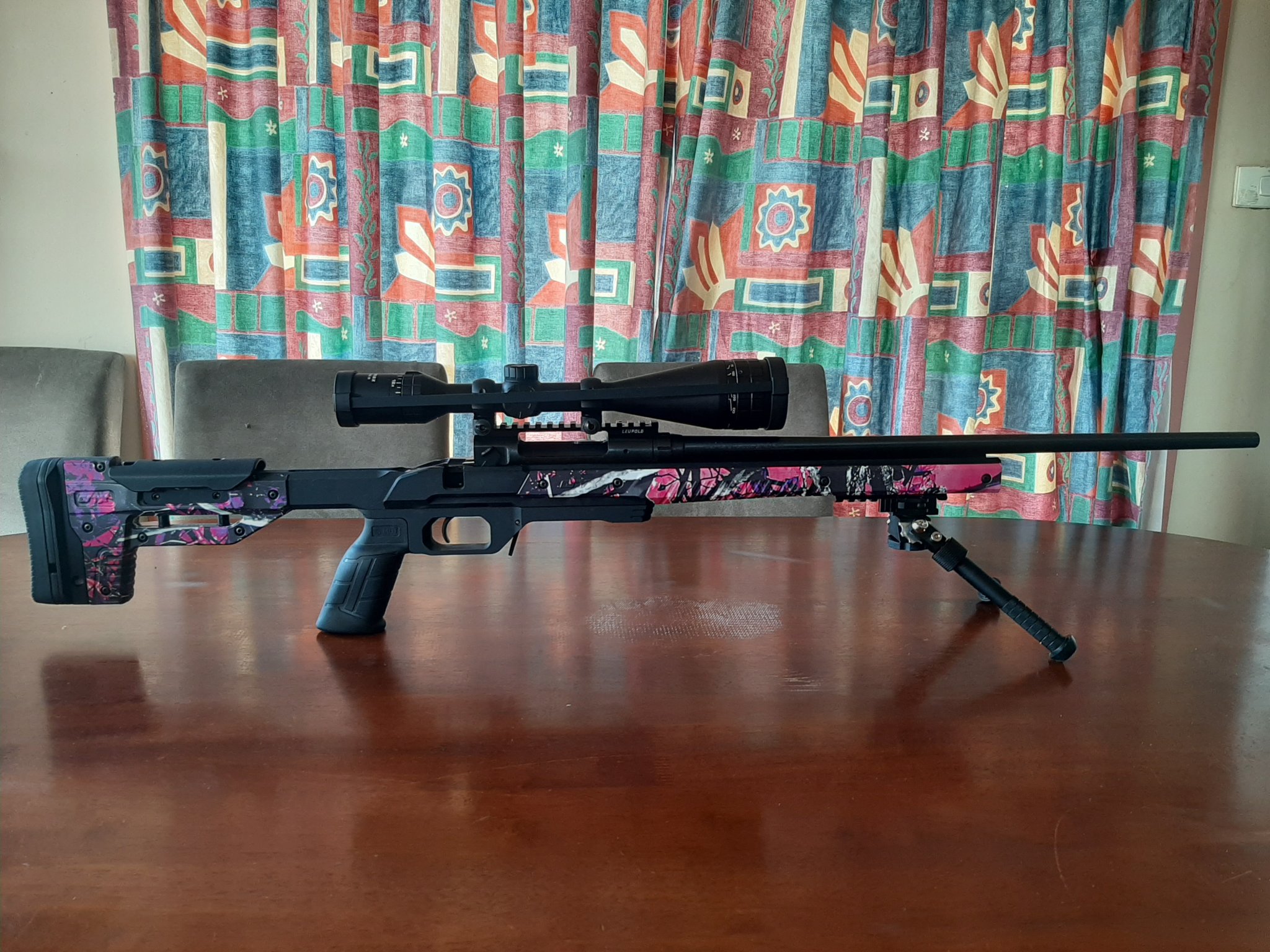

Hey @jackomasonmy my wife is about 5'11" and she needs a LOP spacer kit it's about 1.5" short for her. It might be perfect size straight out of the box although there is 1x 1/4" spacer already installed which can be removed.
Just put it together it looks amazing
