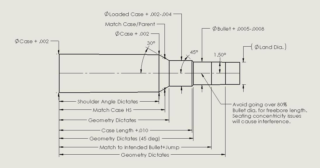

Y'all can do whatever you want. This is where I start.
One reason to disclose the dimensions is for folks who are having custom dies made, too.
There's also this for reference.
We have no problem supporting people getting custom dies made. We work directly with the die maker for questions as well.
As a general rule:
Bodies are SAAMI/CIP. I don't modify those dimensions at all for sizing die reasons. I pay very careful attention to the "neck forward". I've told many people this in emails, phone calls and posted it on this forum.
