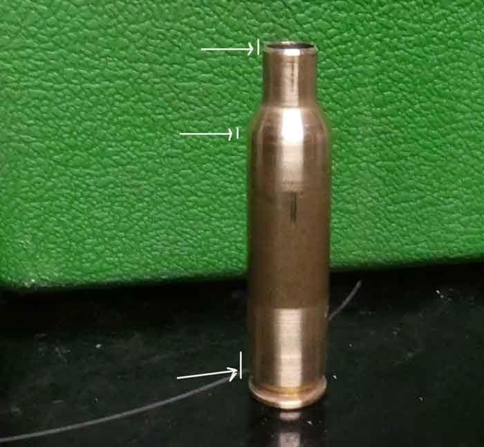

For a test, you can tear down 3x of the handloads and run them through a shoulder bump (9 thou) and a small base die, and see if that fixes the issue.
ETA: Someone can correct me if im wrong, but AFAIK, a 'comparator' is not accurately a measurement device in relation to saami spec. its only useful for a/b testing. So it will give you reasonable estimates of variance between two cases, but won't accurately tell you where those cases fit within spec of the chamber, etc.
Sacrifice a case.
Take a case and trim the case length at the neck. Check fit.
Probably not the issue.
Bump just a little more.
Headspace could be tight.
Next, sand down the body diameter near the base to see if fit improves.
Probably IS the issue.
Sand down the shoulder/ body junction in case the shoulder has swelled.
Usually only an issue when seating a bullet, not with a sized empty case.
Normal sizing dies will take care of most everything else.
I did this one just as an example.
I used a drill and a fine file to remove brass in indicated areas. 2 minute job.
Note that case will now be trash.
If you find where the case doesn't fit then seat a bullet and try again.
Reactions: bradworley
Sacrifice a case.
