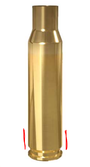

Ask @powdahound76 how he got his used BR brass to fit his chamber
It was just a little fat for about .125” above the rim.
Had good measurement on the brass everywhere else.
Tried a 6.5 manbun (hornady match) die and it didnt cut it.
Tried an old RCBS FL .308 sizer with no decap pin or expander and worked like a charm.
And of course, once they were fired in the chamber, easy and light pass in the Whidden 6BR die and they drop into the chamber with ease.

Ok, without sounding like a complete ass that doesn't know jack, what is the "web"?
Headspace, shoulder, neck, datum... These measurements I'm familiar with.
Brad,
I highly recommend you purchase something like the Hornady reloading manual.
The actual book, not the online app.
Sit down and read it from the very beginning.
Read the description and how to and why sections. It will answer most, if not all of your questions. You'll learn what all of the definitions are and the book provides picture references to go along with the descriptions.
To answer one of your questions, the .200 line is .200" from the base of the brass.
The measurement there will show you the diameter and after firing and sizing, it will show how much expansion you're getting and how much sizing down happens with your dies.

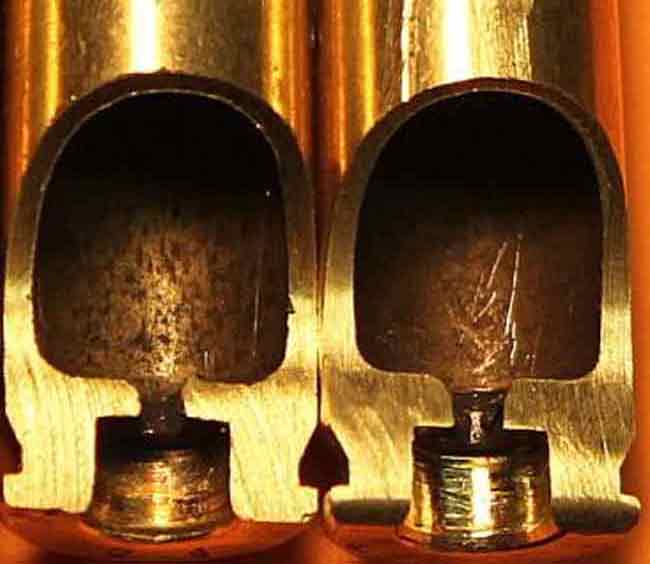

I had a tight chambered rifle that would not chamber any cases that had a case web diameter of .469"+. I had a lot of once fired brass, fired from other Rifles, I wanted to use for that rifle. The problem was most of the brass had web diameters of .469"+. My regular sizing dies wouldn't get the web smaller than .469". New factory ammo or brass would chamber fine.
I had to buy Redding Small Base Body Die. That die was able to get the web sized to .468" and corrected the issue.
I took my calipers and set them to .468", locked them and was able to use the calipers as a go-no go gauge for the resized case webs.
It took me a while to figure out the issue since i thought it was a shoulder bump issue. When I shoulder bumped cases .005" below SAAMI minimum and they didn't chamber, I then went to the case web and that was the issue.
Most of the time when a factory rifle won't chamber resized brass, it is a shoulder bump / length issue, but on rare occasions, it can be a case web issue. It can also be a case length issue, but that's also rare and can be measured easily.
I've only have had this issue of the case web once. All of the other chambering issues I've had were shoulder bump issues. I reload for a lot of rifles.
Most of us will take cases fired out of our Rifles and measure the brass in three places: Length. shoulder datum length and case web diameter. Those measurements are written down. That gives a base line when setting up our sizing dies. You can use your rifle's chamber as a gauge.
My Tikka T3 270 Win. has a maximum shoulder bump length of 2.040". 2.0385" chambers with a moderate crush fit and 2.037" chambers easily, no resistance. No case web issues.
