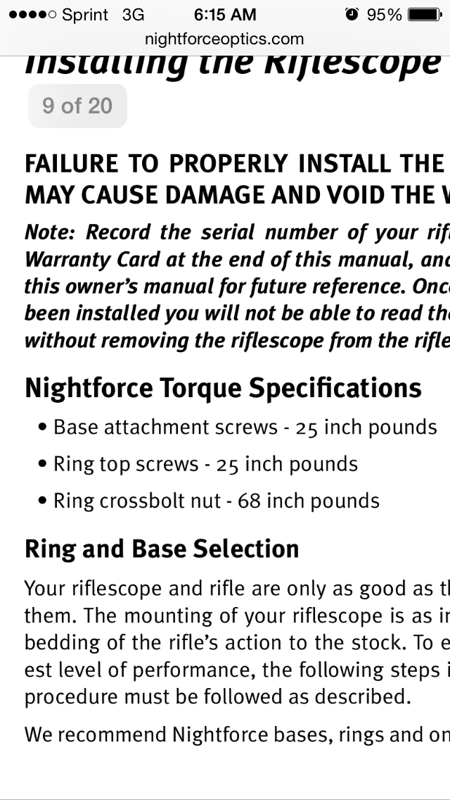

For the record, Nightforce product literature for NF Ultralite rings state no more than 68 in/lbs for the cross bolts (I've always torqued mine to 65 in/lbs, no issues) and 25 in/lbs on the ring cap screws (Again I've always torqued mine to 15 in/lbs with no issues).

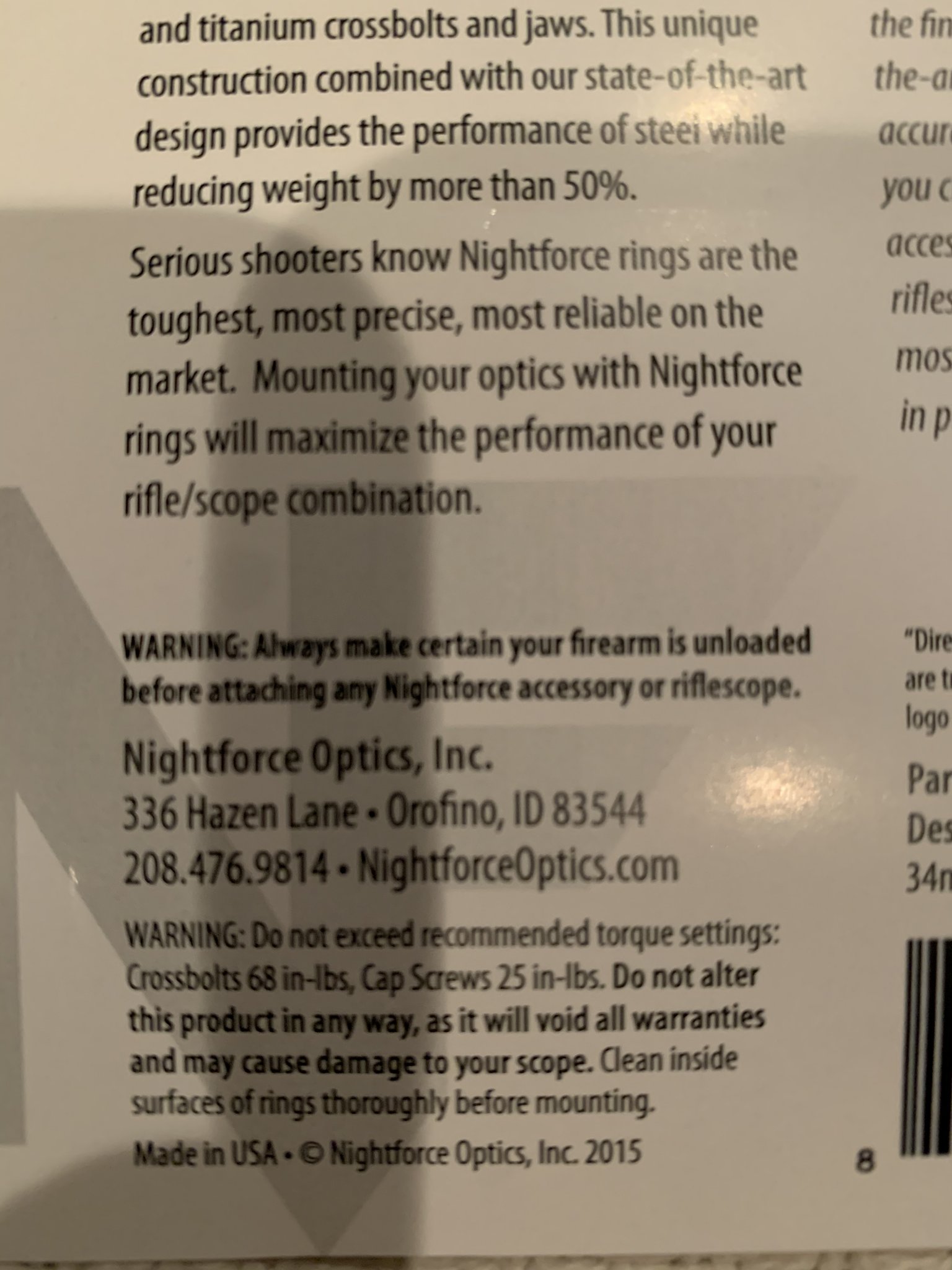

Where did you find that. I have a pair and it says 15 inch lbs on the package. The 25 inch lbs is for the steel rings.

Here is what I have for reference for Nightforce
