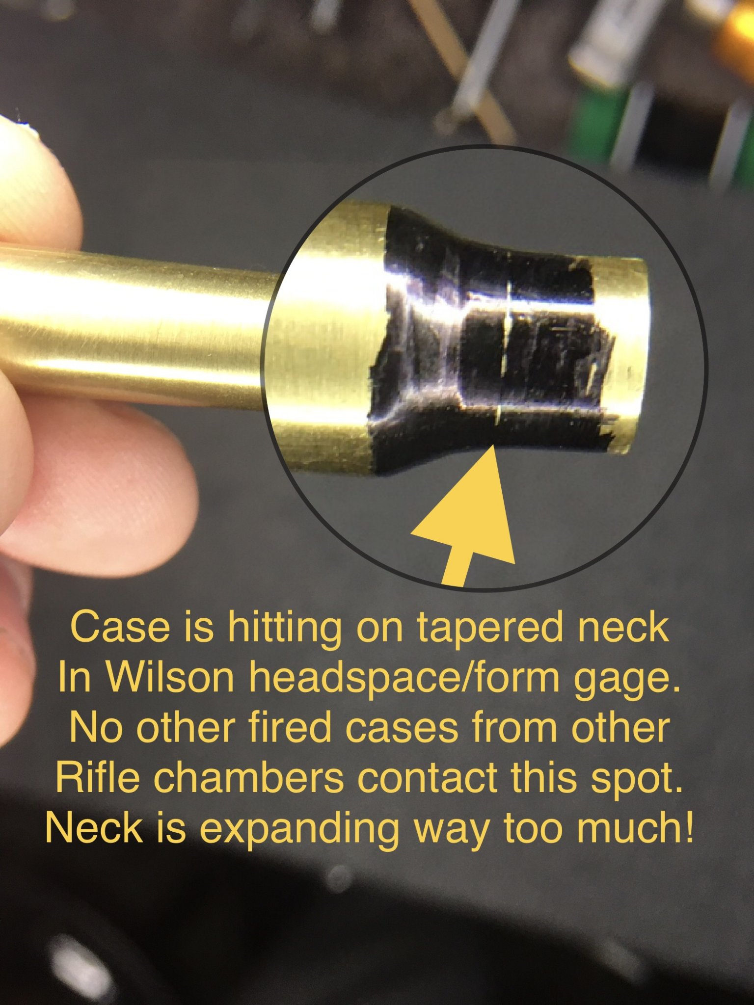

Oversized 5.56 cases after firing

The problem is he doesn’t see a need to send me a replacement because he says there is nothing wrong with the one I sent him. I told him to show my cases to someone there that actually reloads their own ammo and see if they see what all of us do!

Then why would they not plainly see what I am talking about? They are the experts, no??
You'd think so, but sometimes the "experts" really aren't. I don't know about DD, haven't used them or worked with them, but have seen way too many times where so called experts either wouldn't take the time to understand and look at the problem area, or just didn't actually know anything beyond the armorer level checks they were taught.

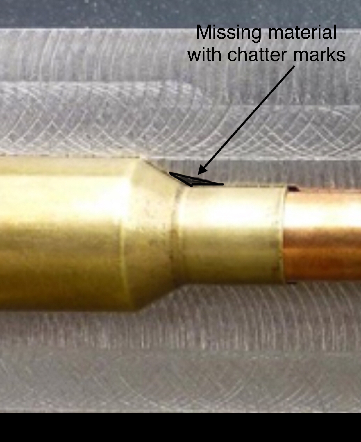

The whole situation is too bad, especially for a supposedly high end upper. Their refusal to admit that the fired case is showing a chamber defect is a huge red flag against them IMO; either they think you're stupid enough to believe them, or the people you're dealing with genuinely don't know what they're looking at.
Yeah, the customer service rep told me that his guy has more qualifications than me and my internet buddies.
Ok.... Lol.
If his "guy" can't literally see the issue at hand... then maybe the next guy at DD is more qualified.
Maybe they could show you the "spec" that says that is "normal"
I'd take them up on the refund.
New barrel installed, test fired and sending 5 as formed cases back with the upper. Now I wait for fed Ex to deliver.

I had to send the following pictures to get their attention
Reactions: supercorndogs
View attachment 7593304View attachment 7593305
I'm glad this got resolved. If it were my company, the AAR would definitely have something like, "when no problem is found, have tech involve another expert and if still not found, contact customer directly (bypass CS) for more more detailed discussion."
