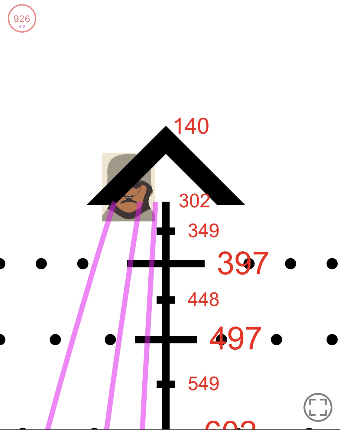

Update on the PLX 1-8 Compact:
I ran the River Bend Run'n'gun 10K a few weeks ago with the PLX 1-8 Griffin Mil. It was mounted to my 12.5" 5.56 AR with a Turbo K suppressor.
Stages were 3-~500 yards. A single stage had ~200, ~300, and 500 yard targets while everything else was ~150 and in.
The good:
-The scope is very easy to use and get behind up to ~6.5X.
-Mil grids are great for for UKD. See splash? Adjust and move on.
The not good:
-This is not a red dot
-The reticle is good for short range generous targets and OK for long range, but NOT intermediate ranges on low power. ~100 yard distance on, for example, a plate rack, sucks because of the large donut.
-VTAC board was difficult with the large donut. Maybe it's a me thing but it's easier to hold off a defined dot than a huge circle. Targets float in the circle without a good horizontal/vertical reference.
I found myself wanting an offset red dot many times during the match. The FFP LPVO just wasn't easy to use in certain situations.
My next step is to try a piggyback red dot. I have a lot of time with one on my NXS 2.5-10. It makes that scope much more usable for <100 yard targets.
With a 12:00 MRDS I'll probably use the PLX for 200+. Seems like a bit of a waste, but maybe it'll work out.
