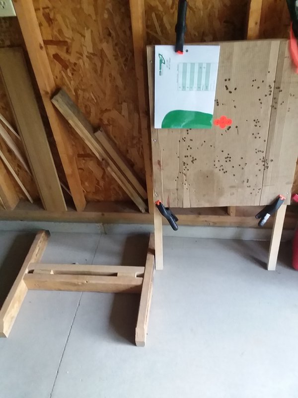

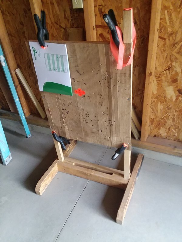

    Here's what works for me. I clamp my targets to the frame for easy installation, and it's highly portable and breaks down easily to make it easy to carry. Have used it in 20 mph wind without a problem.
