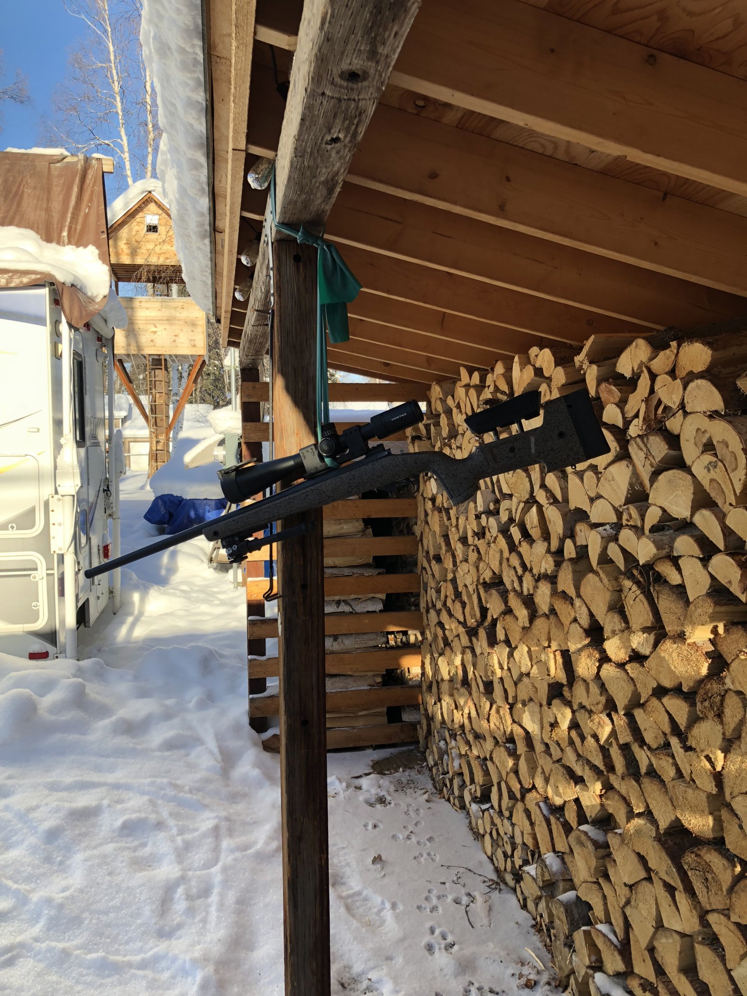

I’ve been second guessing my reticle focus. I’ve noticed occasional eye strain also sometimes difficulty dialing in parallax. Just hung the rifle and scoped the sky. I was able to fine tune focus a little clearer. It’s worth a check.
