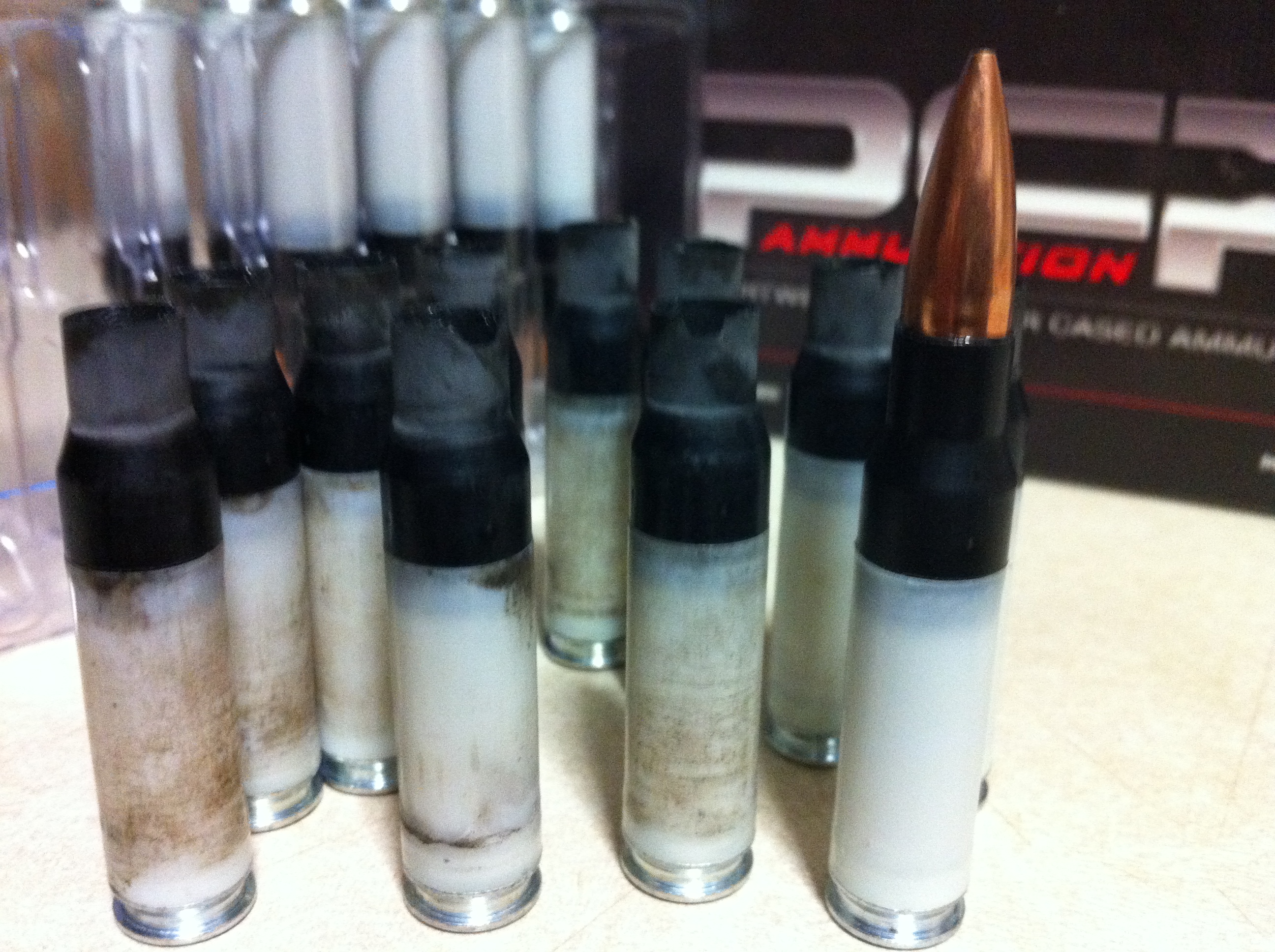

If 30cal had issues in a bolt gun, I could only imagine what my Amalite Super SASS would do to that ammo when cycling. At this time for $40.00 a box I think I will wait until it has been further tested and evaluated.
How is bullet pull being addressed? Several years ago similar cases were introduced, they used a "film" and heat seating, as the plastic, being lubricous, needed to be "glued" (pardon the phrase) to the neck. Has any testing been done regarding any gas or deadly by products associated with plastics being burned at high temp. In short will these cases be "EPA" safe in an indoor range? If heat is being used to seat the bullet, is some of the "melted" plastic being carried by the projectile into the bore? If so, how long between cleanings, and what special chemicals are recommended to remove the melted plastic?
Sir I am extremely sorry you experienced issues during your use of our product. I am going to send you a private message so that we may further discuss the issue and get to the bottom of it.
I am shipping the ammo back to PCP, plus 10 spent shells (FGMM) from the same gun fired today and they will investigate the issue and report their findings. I will wait for them to tell you their findings. I have talked to them 3 different times and they are sending me a return label and a full refund. They were very nice and accommodating.

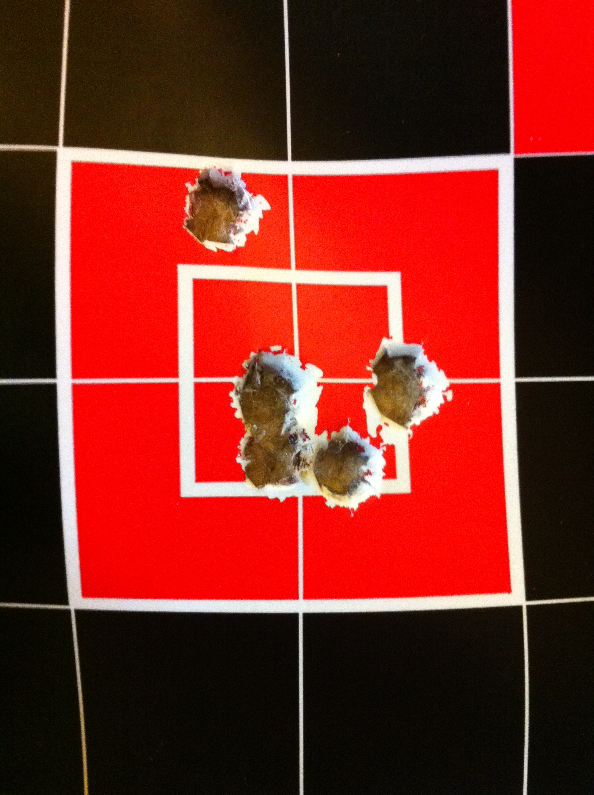

006.JPG009.JPGI got to try this out yesterday. I had no feed, fire or ejection issues out of a 5 round AICS mag. I used a Magnetospeed to get an average of 2509 fps, with a SD of 13. I shot out of a Rem. 700 SF Var. 26 in. with a 1-12 twist. Temp was 55, altitude 50ft. Shot a ok group, but not great off a front rest and rear bag.
View attachment 25328View attachment 25329I got to try this out yesterday. I had no feed, fire or ejection issues out of a 5 round AICS mag. I used a Magnetospeed to get an average of 2509 fps, with a SD of 13. I shot out of a Rem. 700 SF Var. 26 in. with a 1-12 twist. Temp was 55, altitude 50ft. Shot a ok group, but not great off a front rest and rear bag.
Holy shit.....are the necks melted on those? Kinda looks like it.

I tried these rounds in a Remington 700 and only got light primer strikes so I tried them in my sass the out come was not good at all the guys at pcp were very interested in the issue and want the remaining ammo back and some brass cases out of my rifle they are giving me a full refund they were great guys to deal with on the phone i don't know about posting pics of the spent rounds if they say it's ok I'll post the pics of the empty cases.
You don't know about posting photos of ammo that you own? You bought the ammo so their feelings on you posting photos of the spent shell casings is irrelevant.
Mark me down as someone that was excited about this, because a polymer case would be significantly cheaper than a brass case, until I saw the price. Just picked up a box of 200 FGMM 175s for $240 shipped about a week ago. I'm interested in how this ammo develops if the price comes down though.
Uh...wow talk about case failure. Almost reminds me of an unsupported casehead issue that they were getting with the 17hm2 and 17hmr 10/22 conversions
