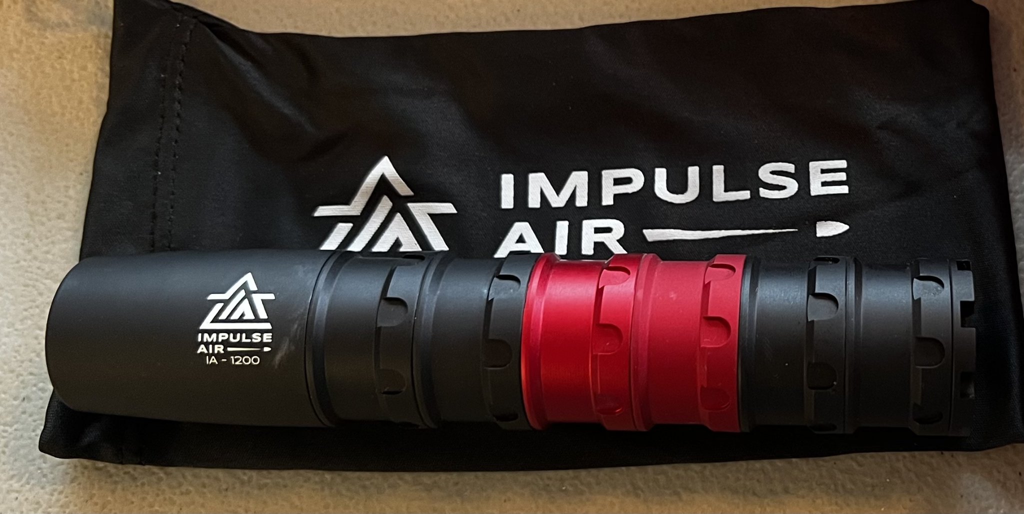

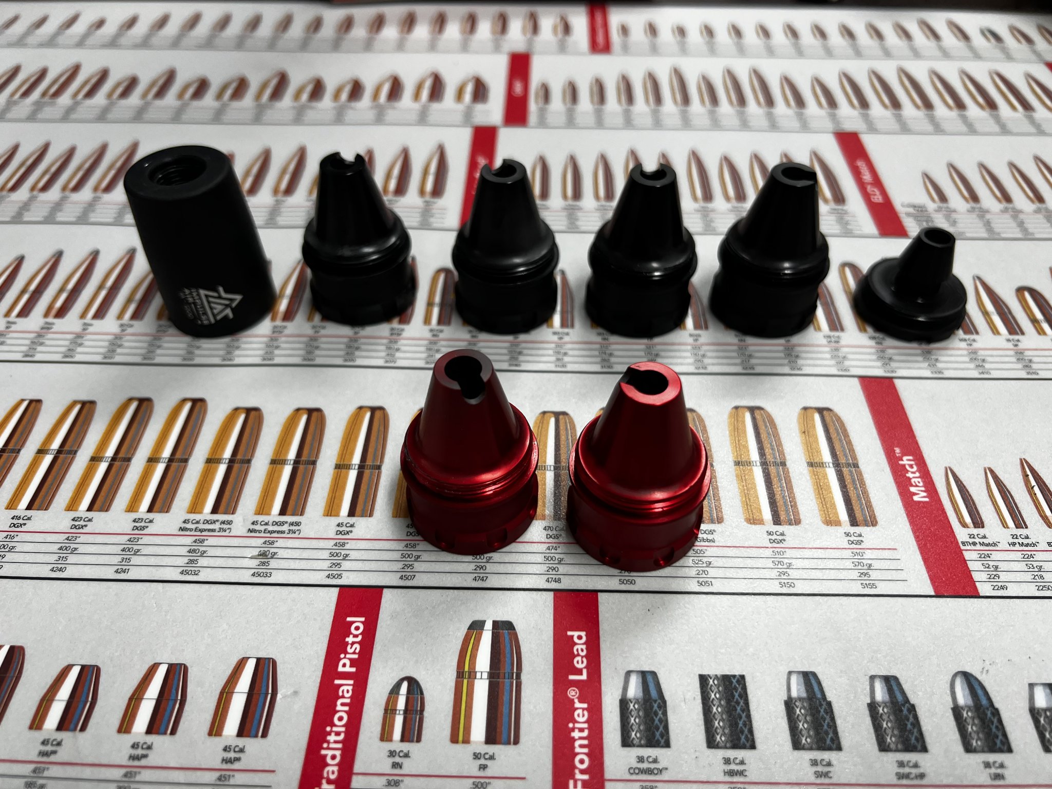

I have Donny FL and Impulse Air. I prefer the Impulse Air over any Donny FL.

Huggett is another brand to look at, but I have the Impusle Air 1200 and 1350 and really like them both.

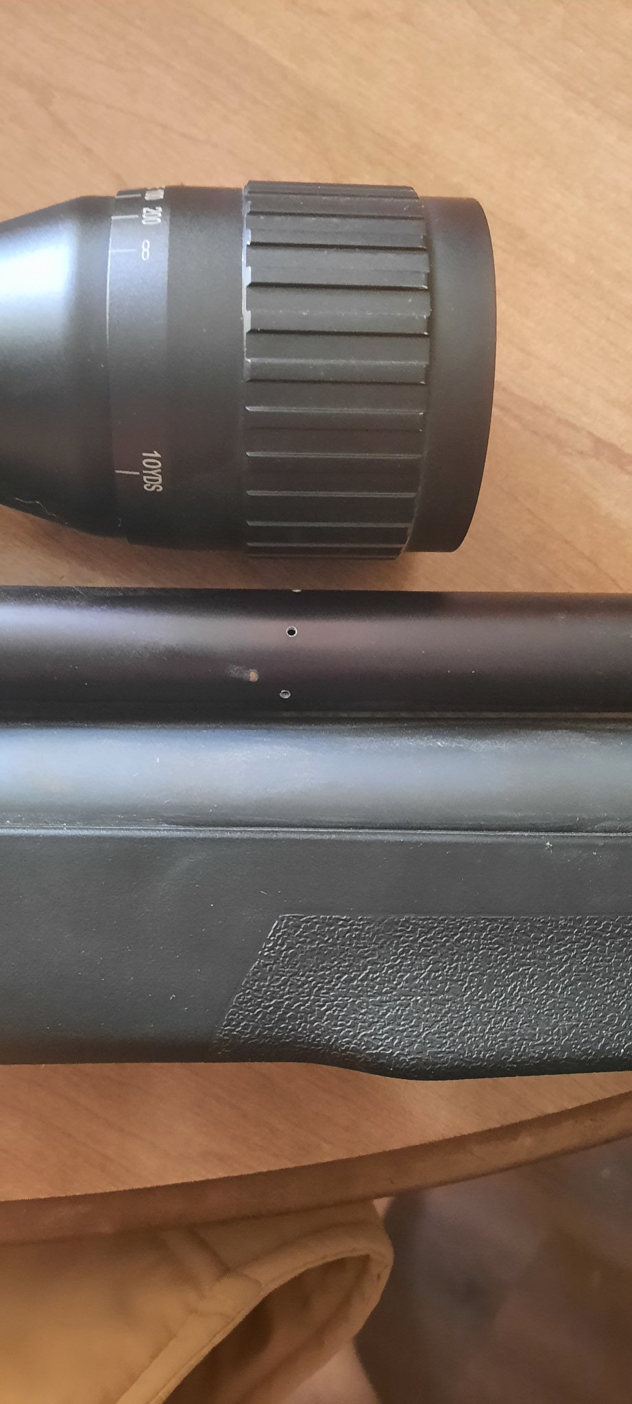

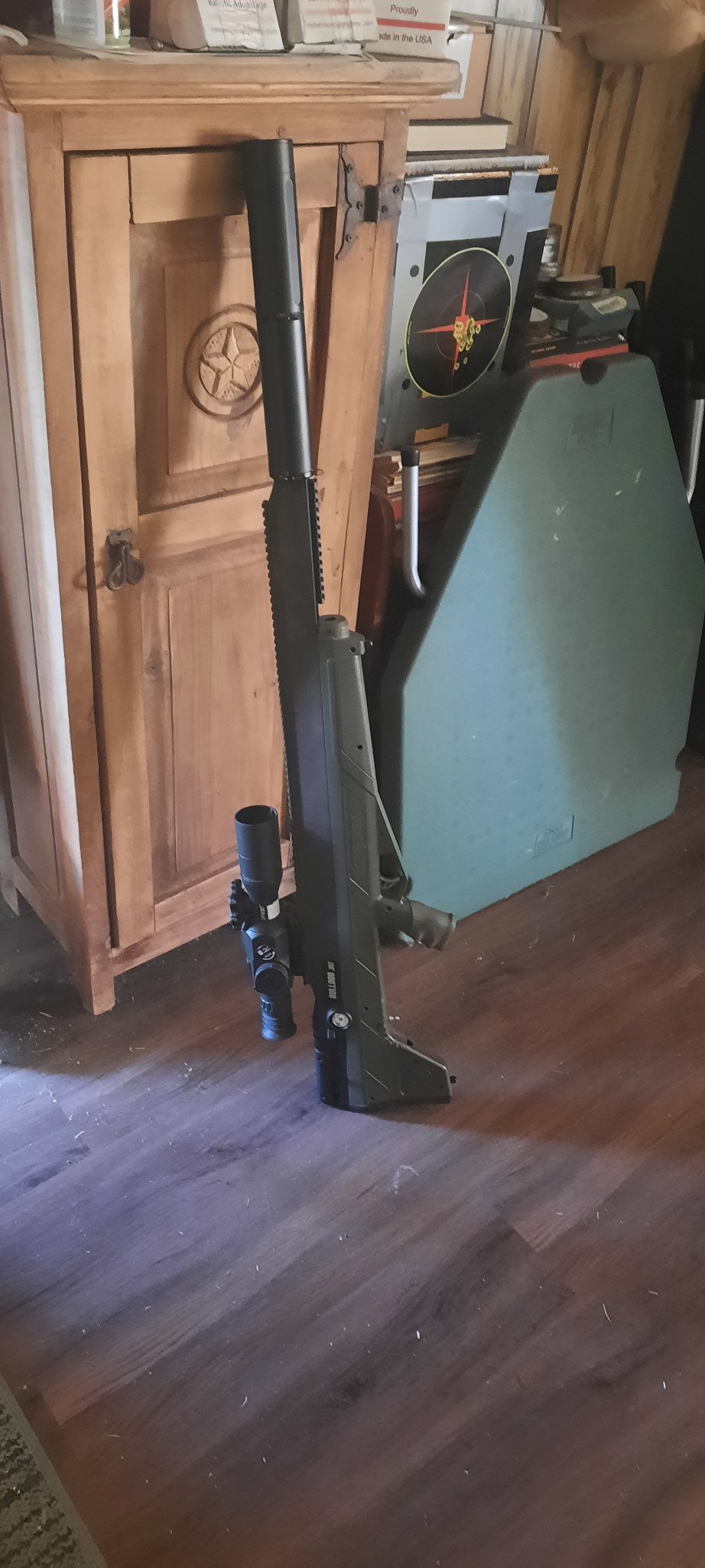

I have 2 marauder 25 cal. PCP's neither of witch have moderators, I did install some better co es or baffles whitch helped some also drilled four small holes at the breech end of the tube with some 3m scowering pad wrapped around the barrel at that point seems to help, also have a Benjamin bulldog that's modified to shoot at over 225fbs with a donnyFL Ronin and extension and the sound of the slug hitting the target at 35yds is louder than the report of the airgun it does make the gun longer by about 10 inches but for my type of hunting/ shooting its not a problem ,
