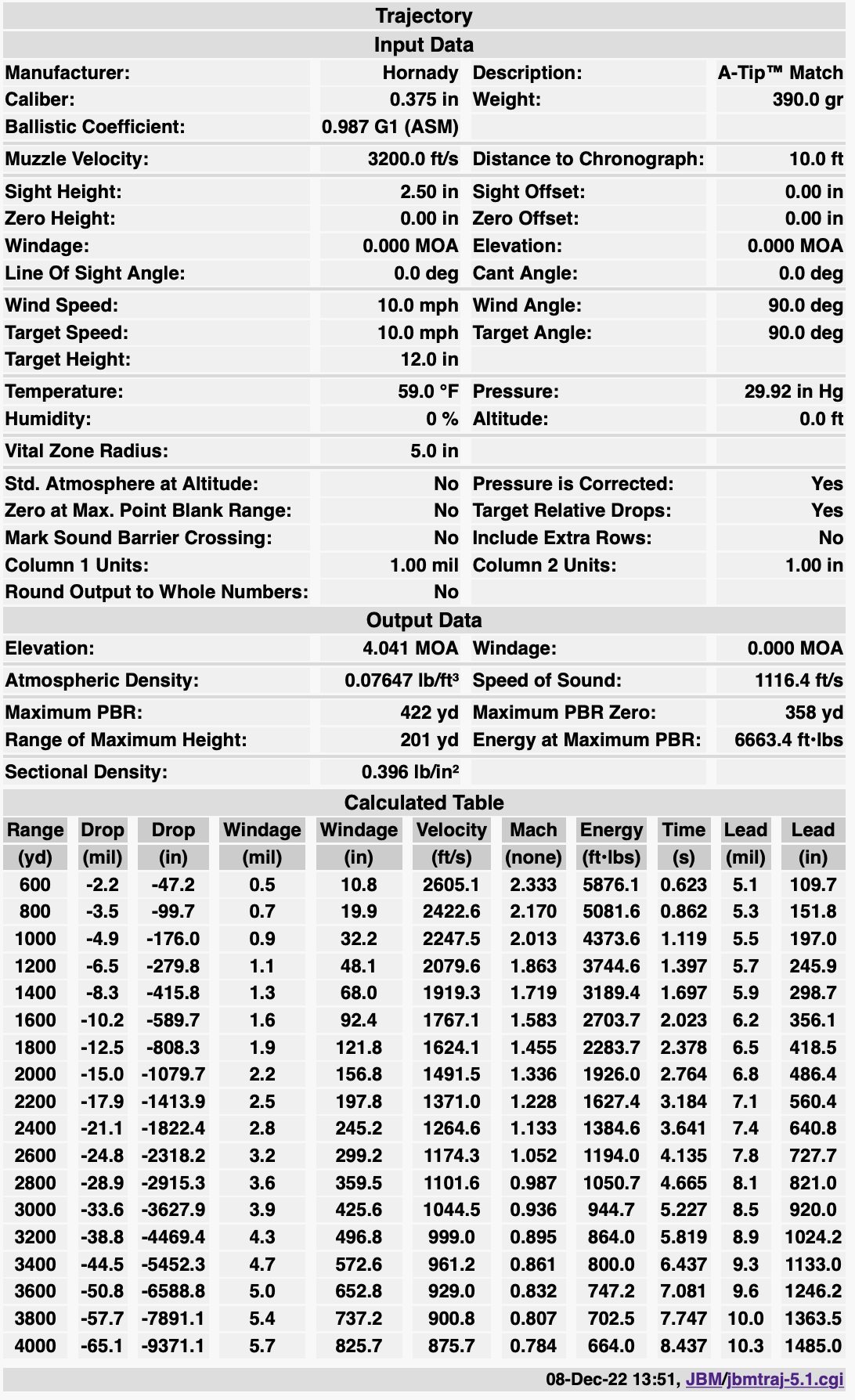

Here is something close, 375, 3200fps 4000 yards
9371 Inches from 100, 65MILS so you can use that as a reference
