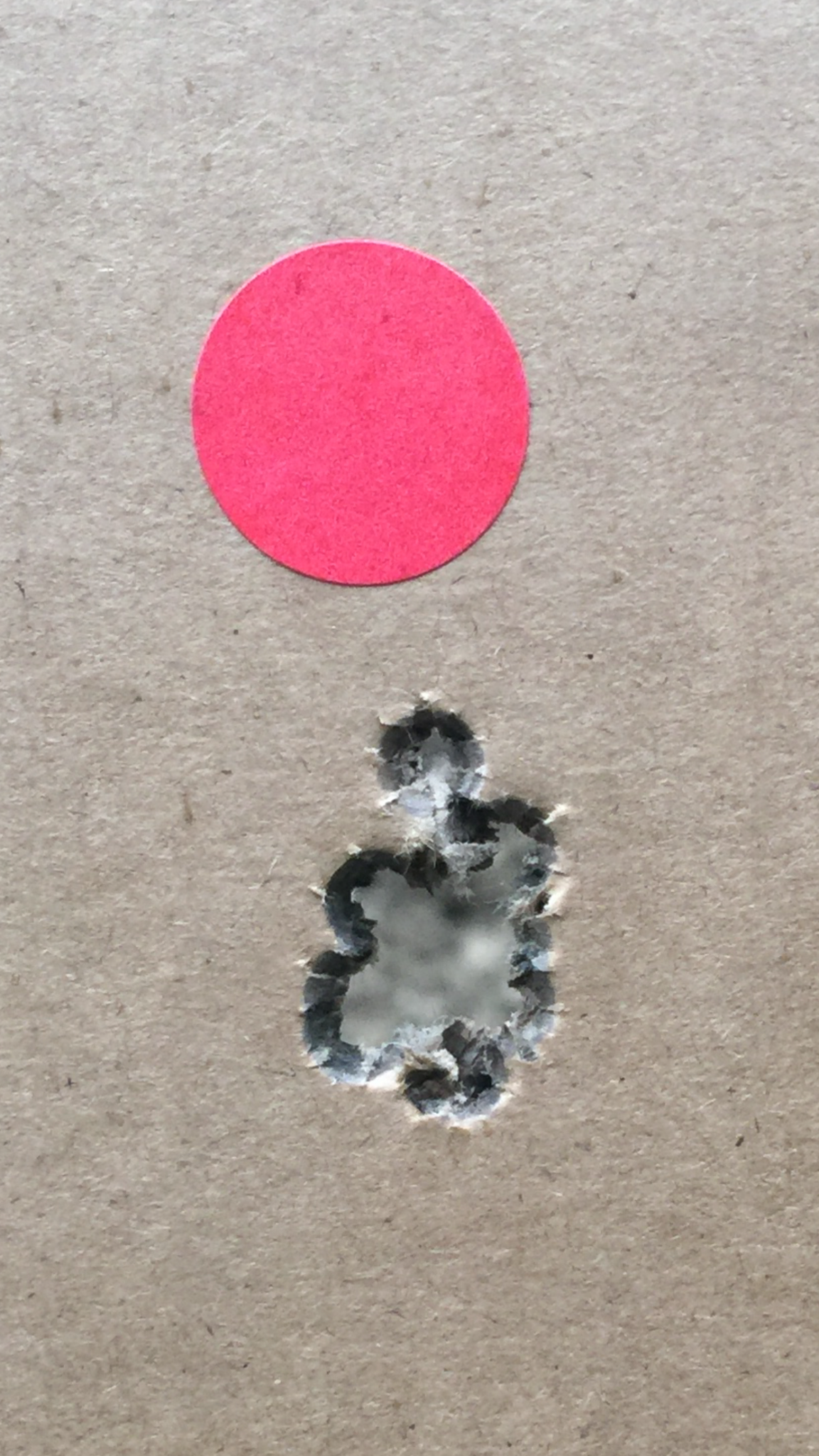

This is 10 shots from 100 yards from a savage.... gasp, using Peterson brass. That circle is 3/4” for reference.
