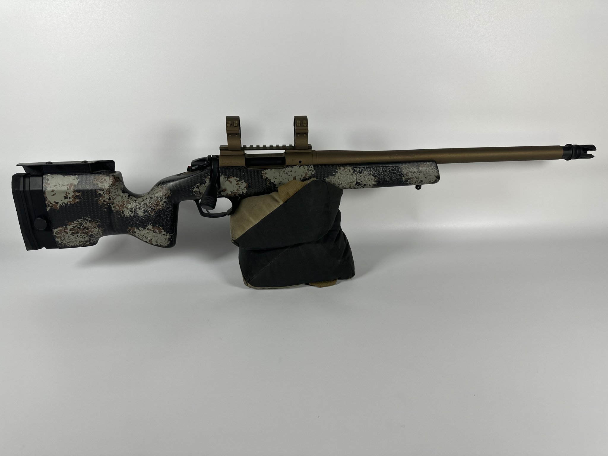

Here’s a 788 we built up pretty nice. Had to fully inlet a flat top Mcmillan game warden for it. Then did our camp pattern on it.
I should’ve gotten better pictures of it. It’s gotta be one of the nicest 788s in the world lol. BRUX barrel chambered in 6.5creedmoor. Feeds like the magazines were made for 6.5creed. Came out great. There are some concerns I have about those 788 actions but I think this one will be sweet rifle.

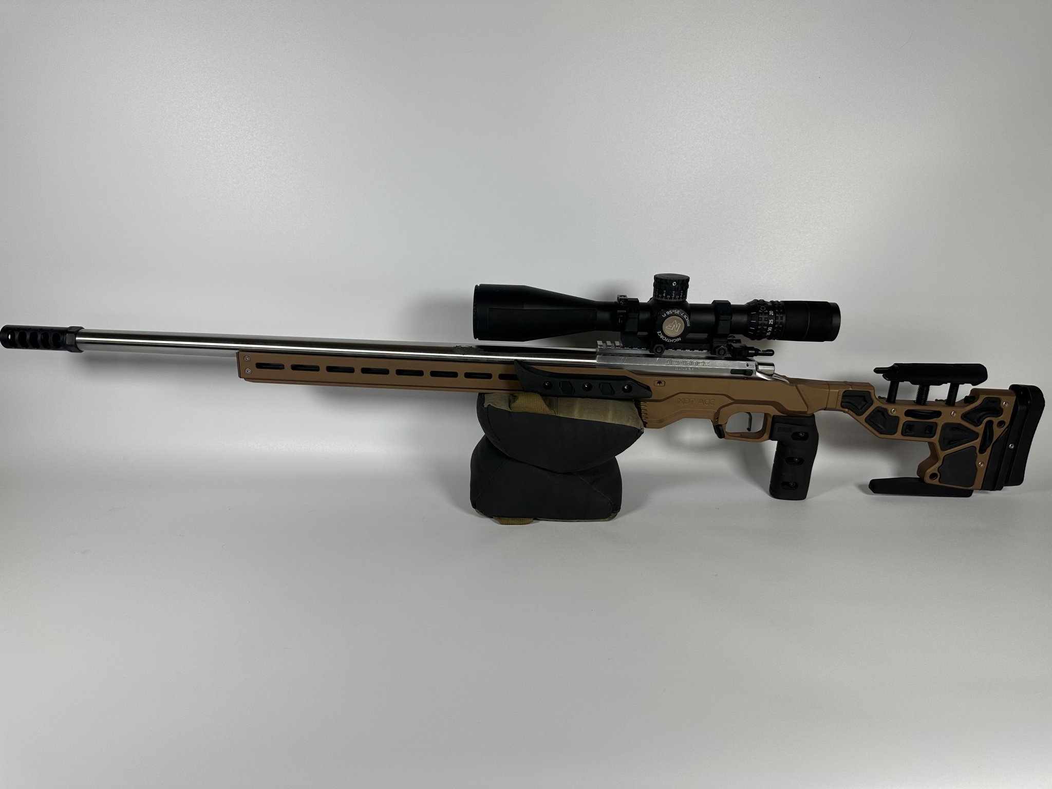

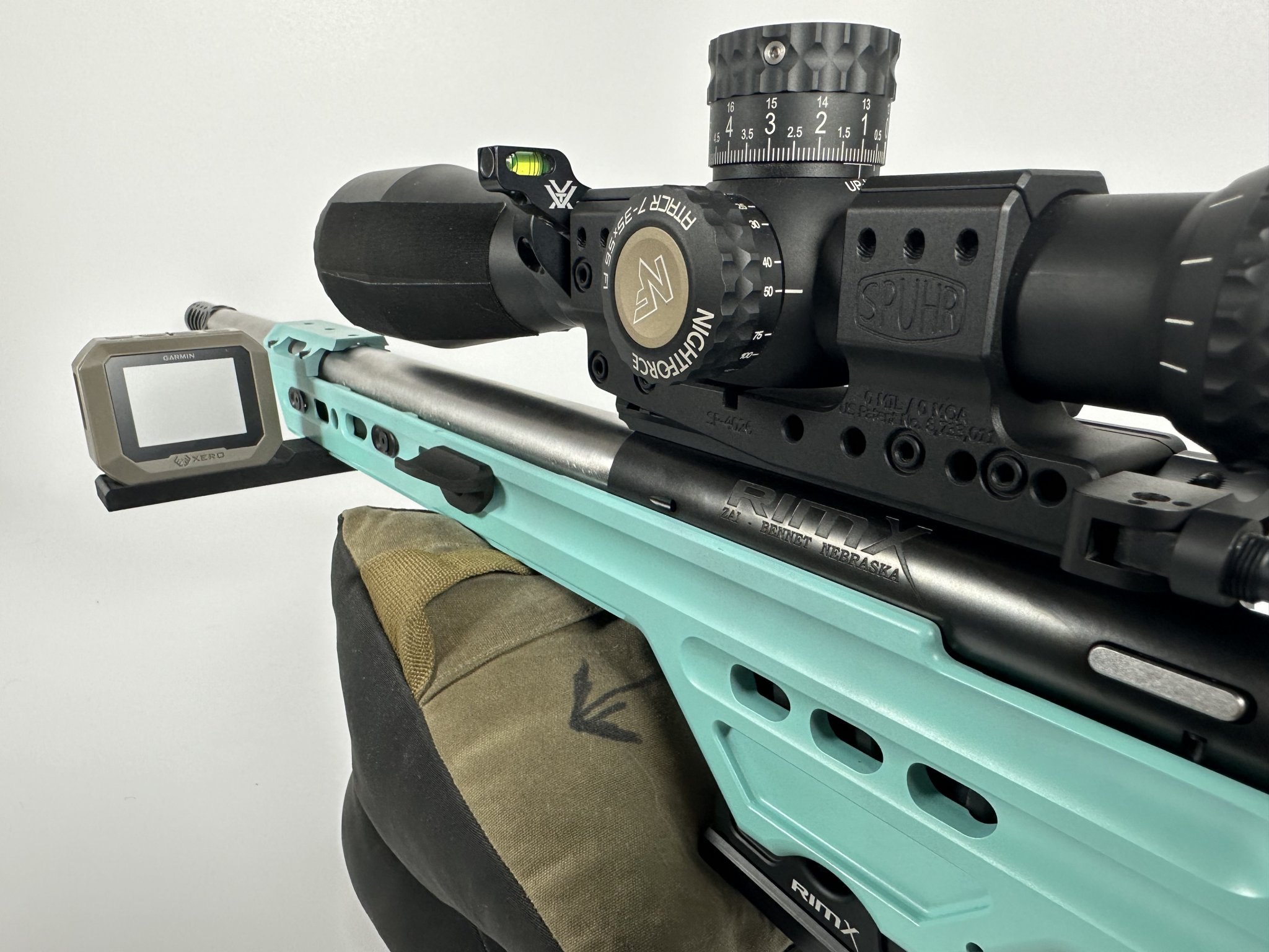

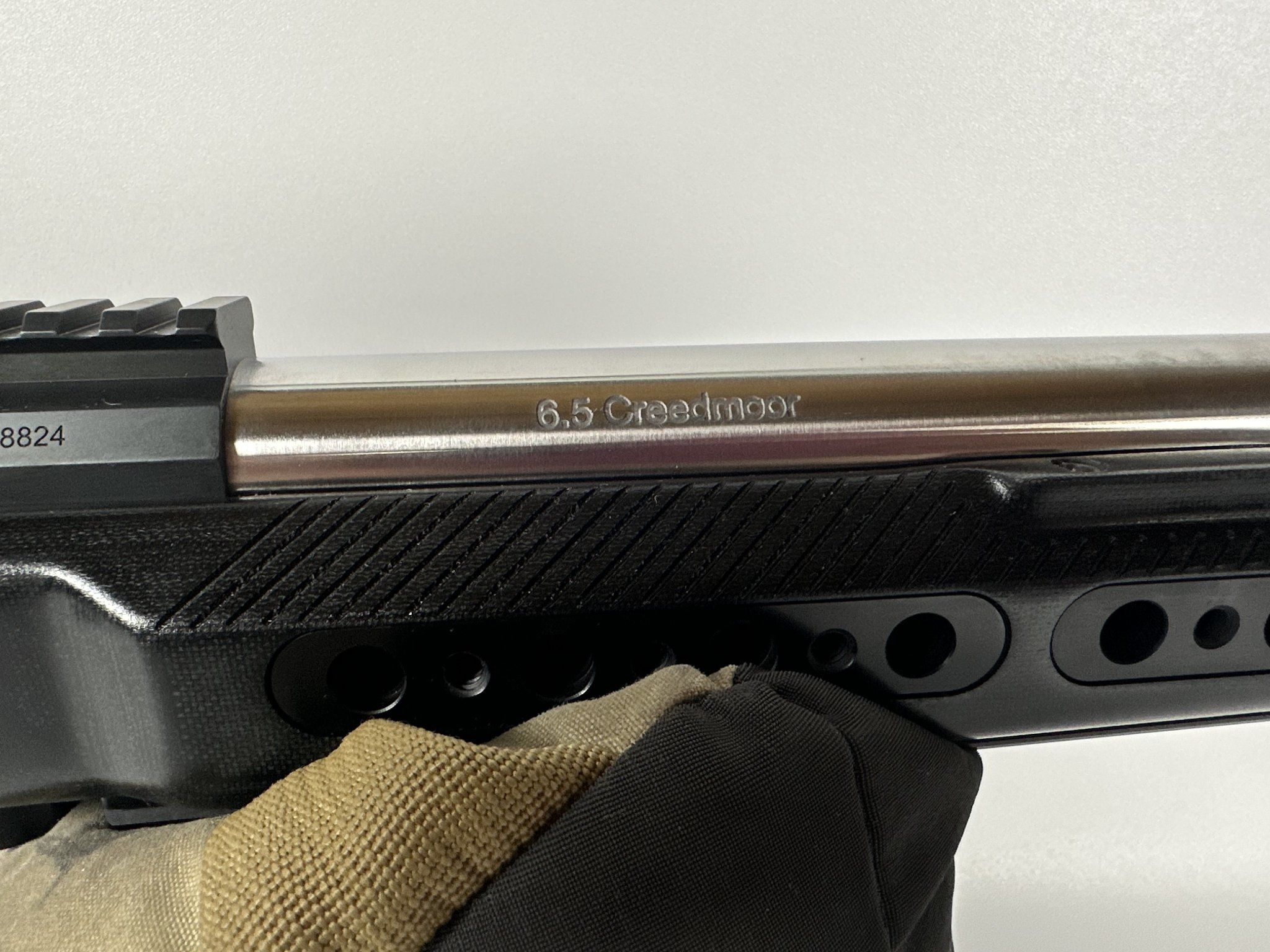

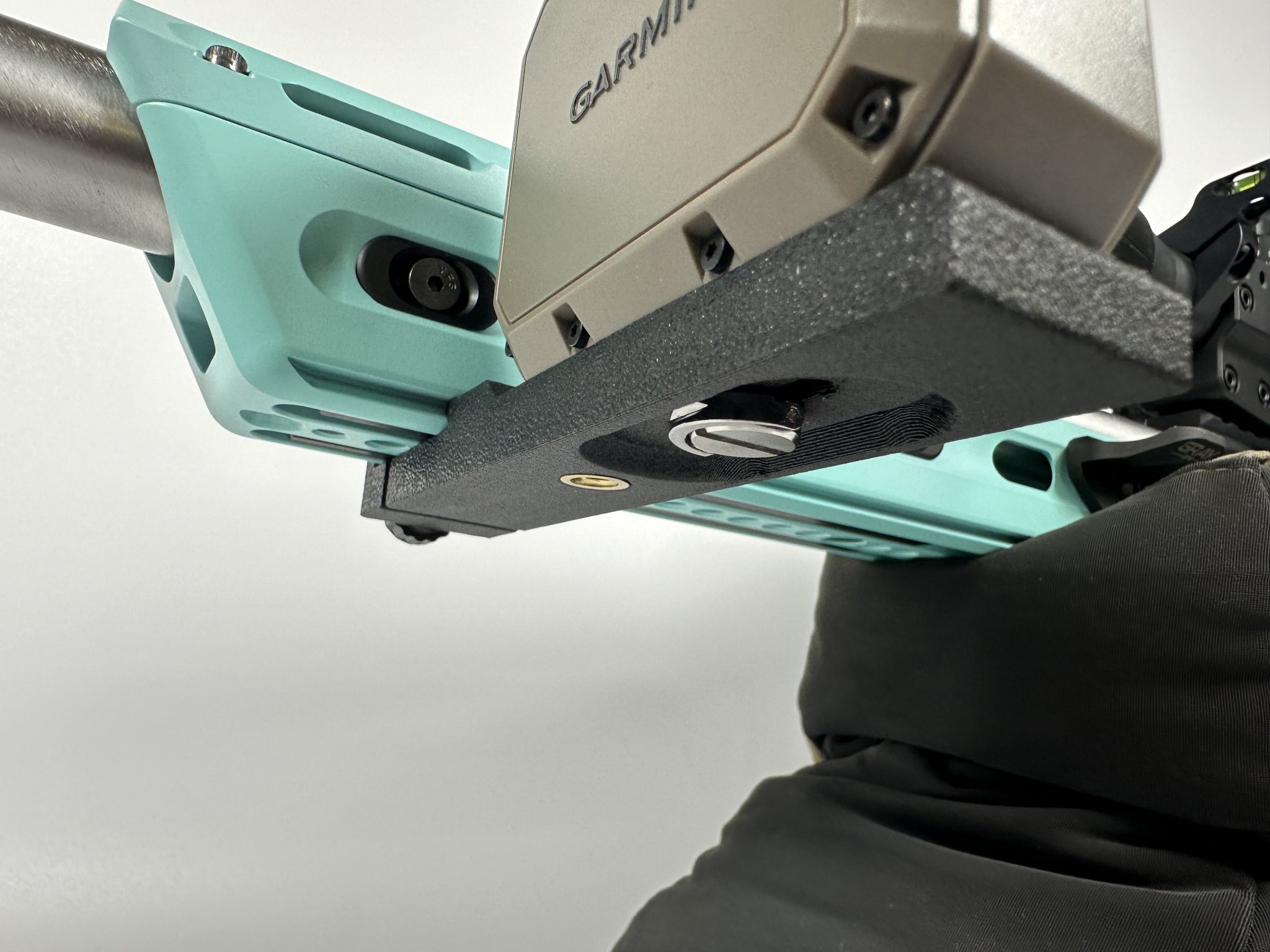

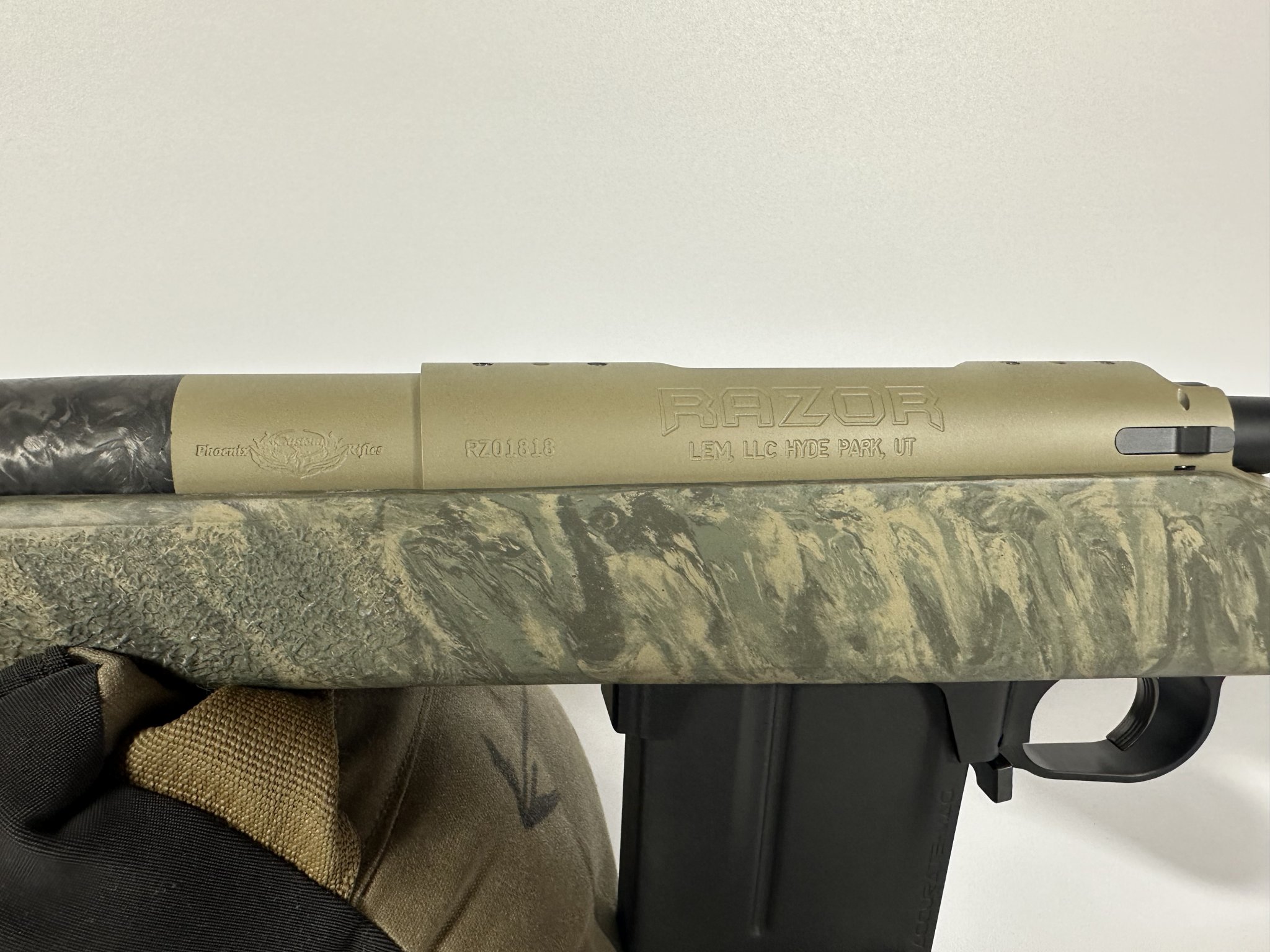

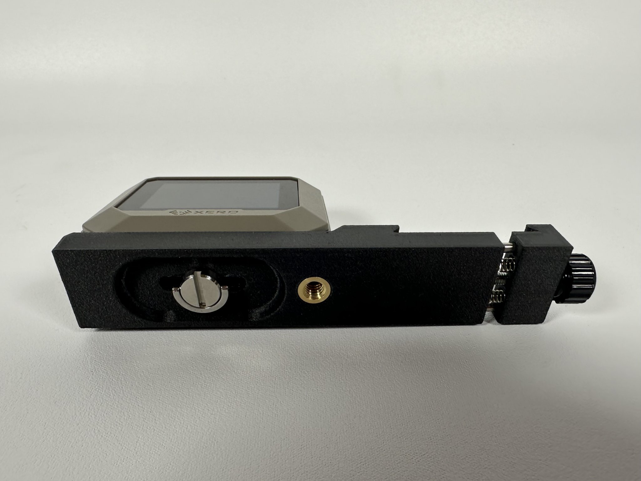

Been a while since I’ve posted anything. Building some great rifles and have some new products.
Nice 6.5PRC

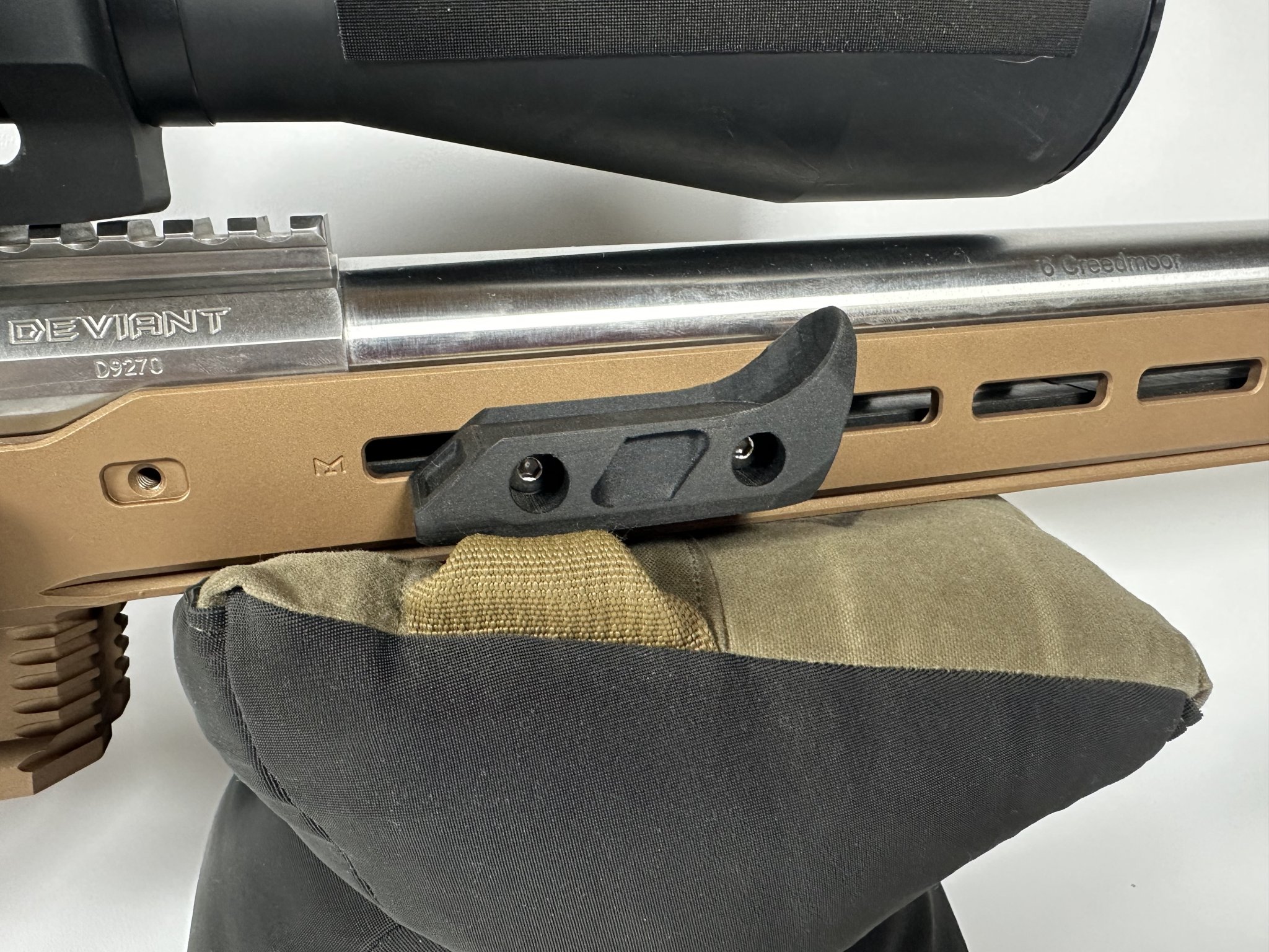

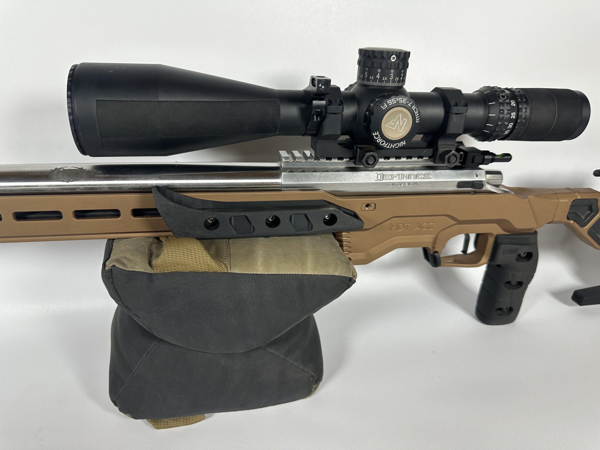

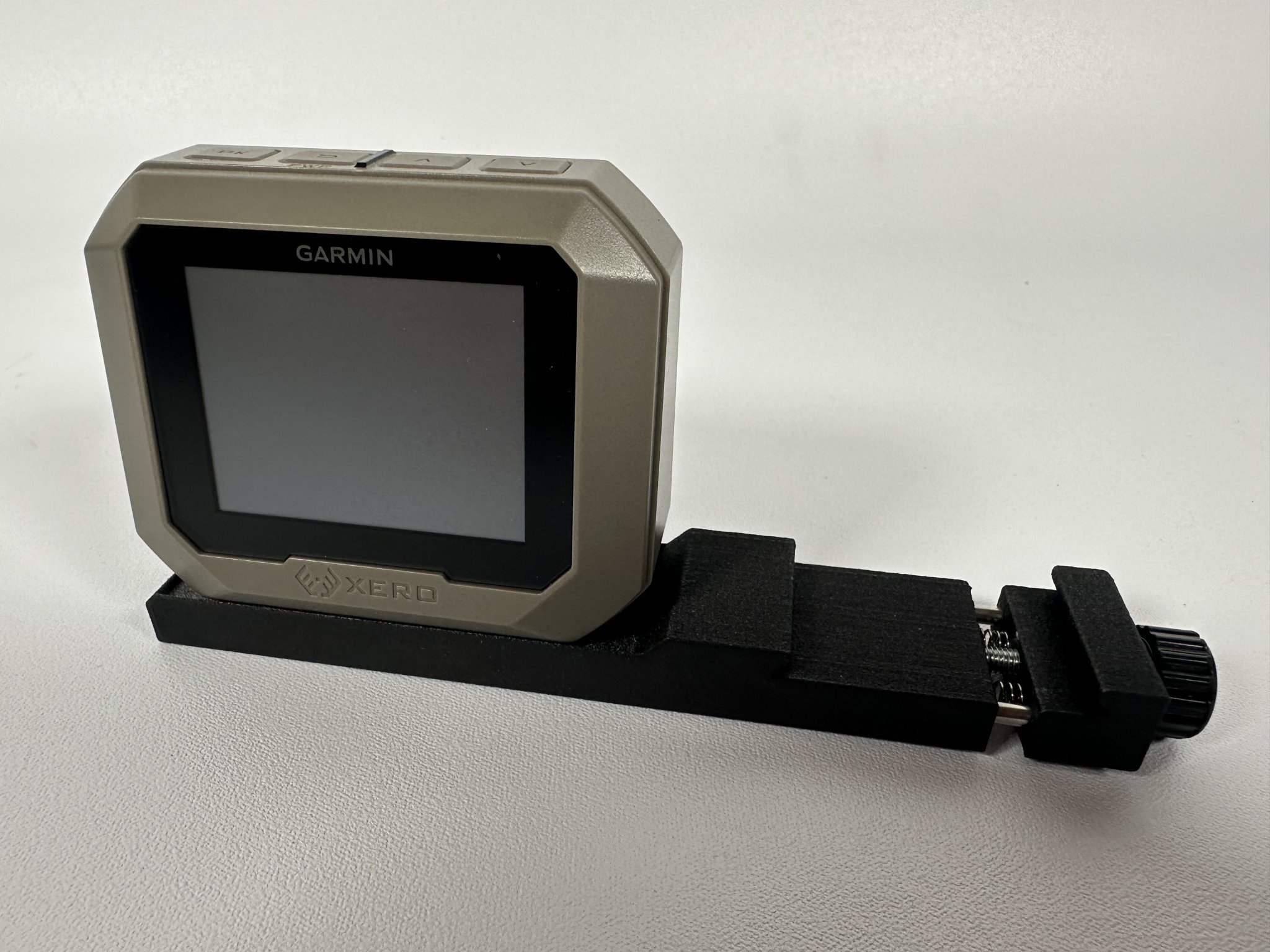

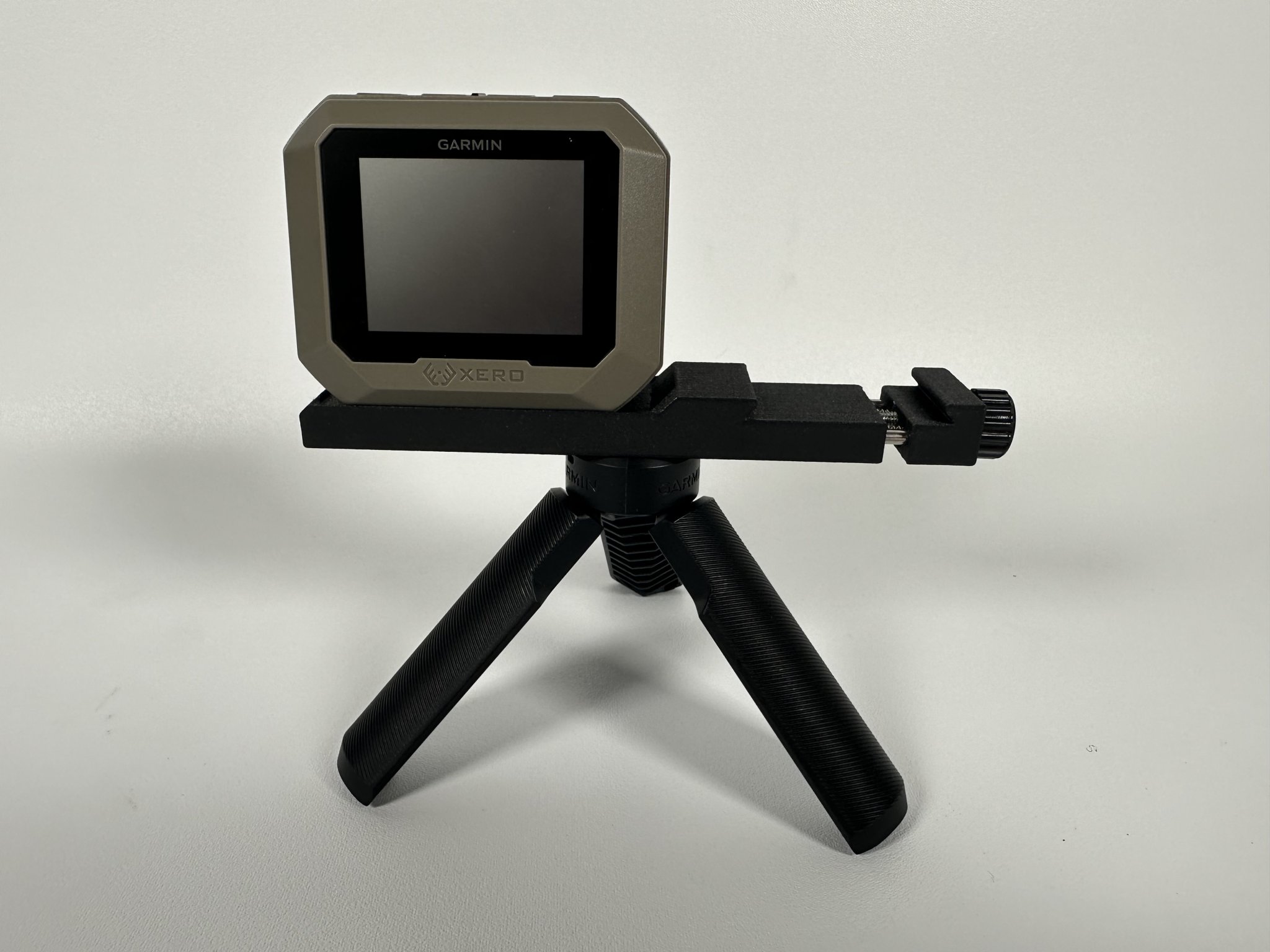

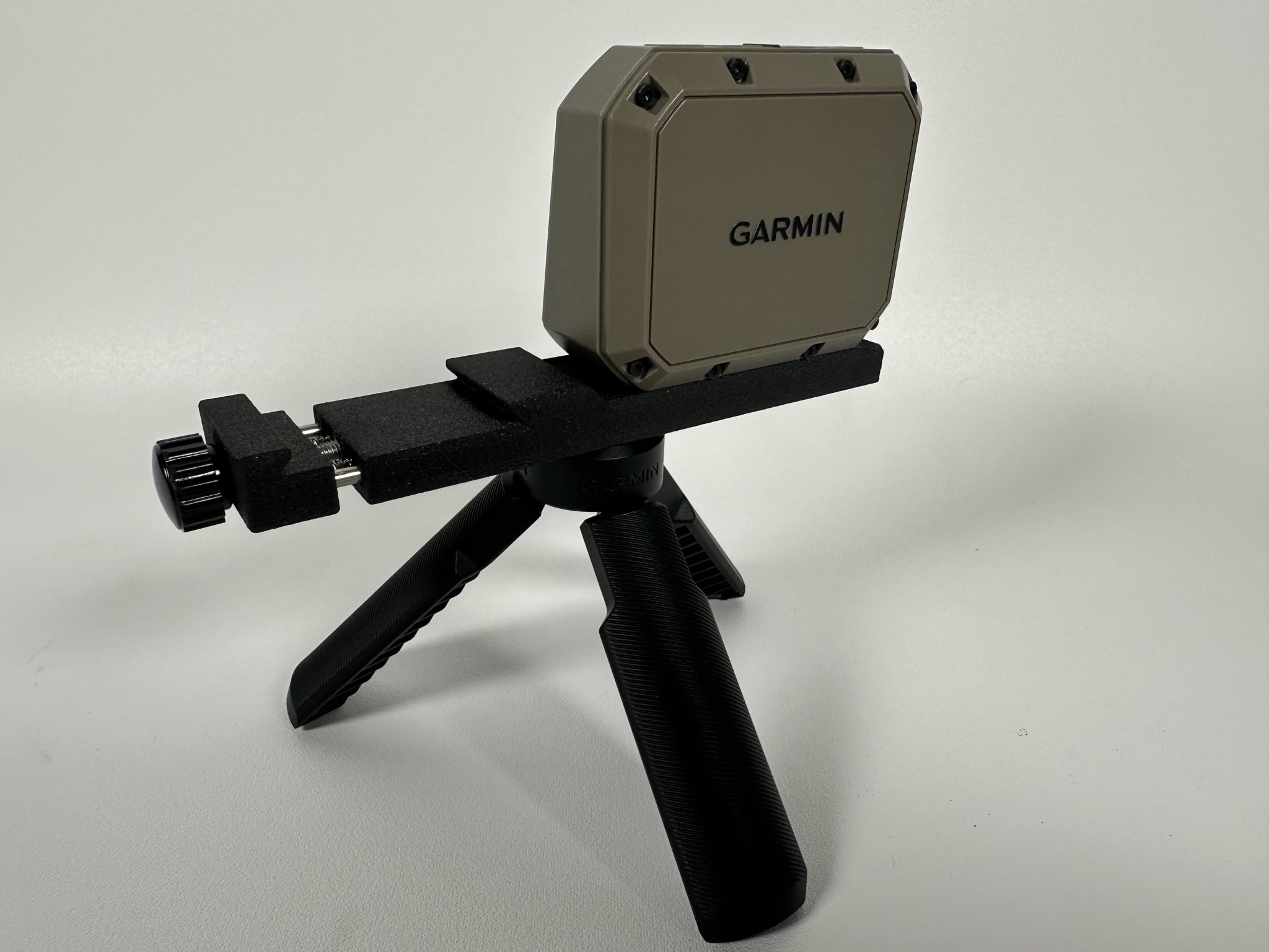

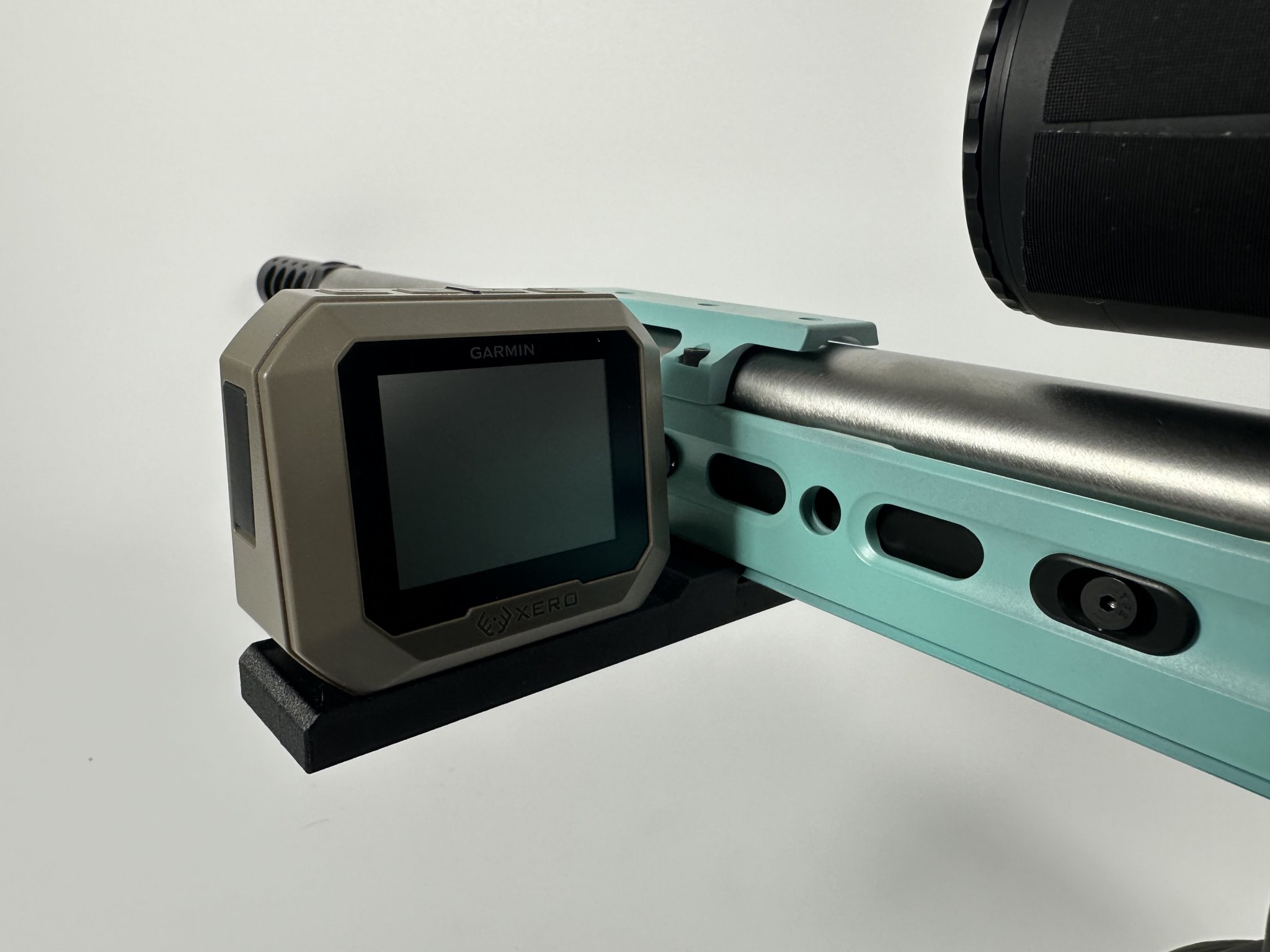

New Garmin Chrono tripod/rifle mounts

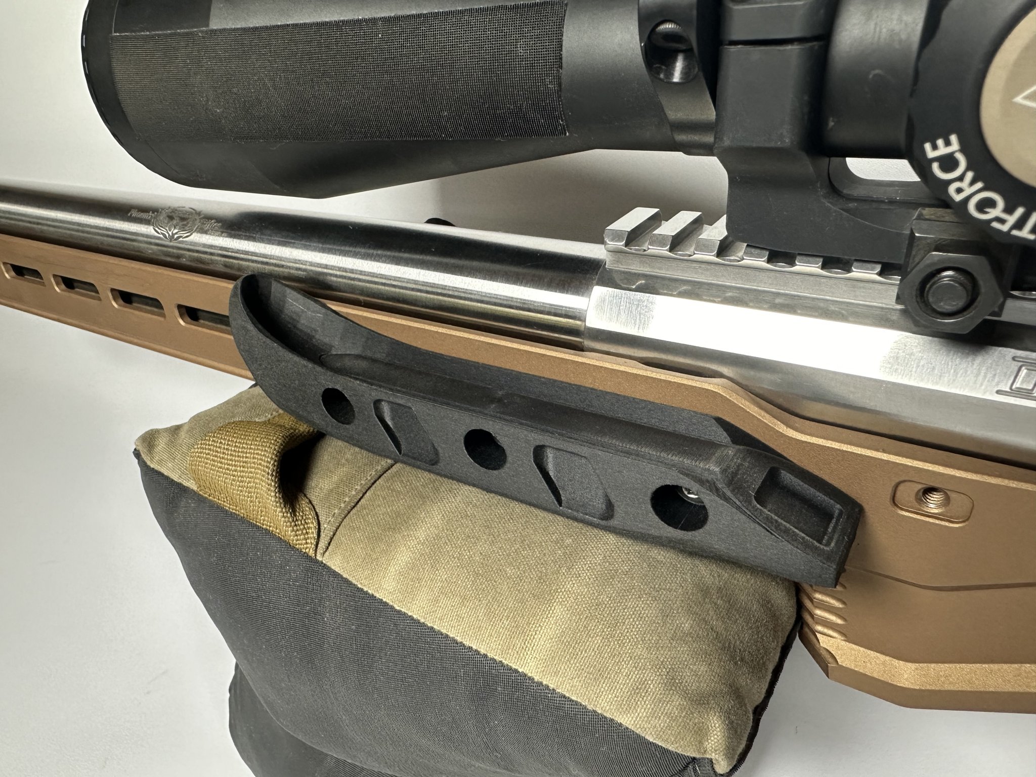

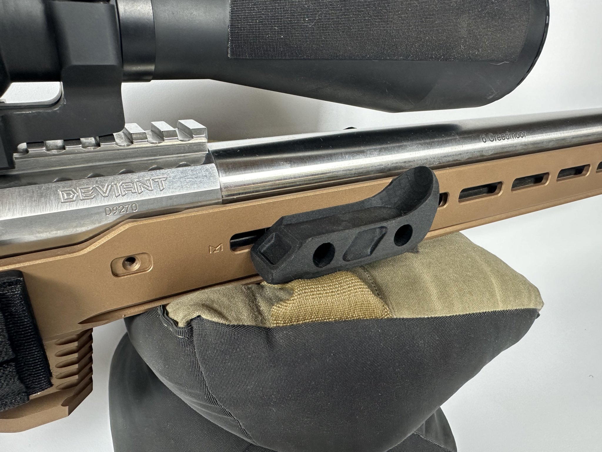

And some thumb rests / side rails that have been working great
Thanks for checkin it out.

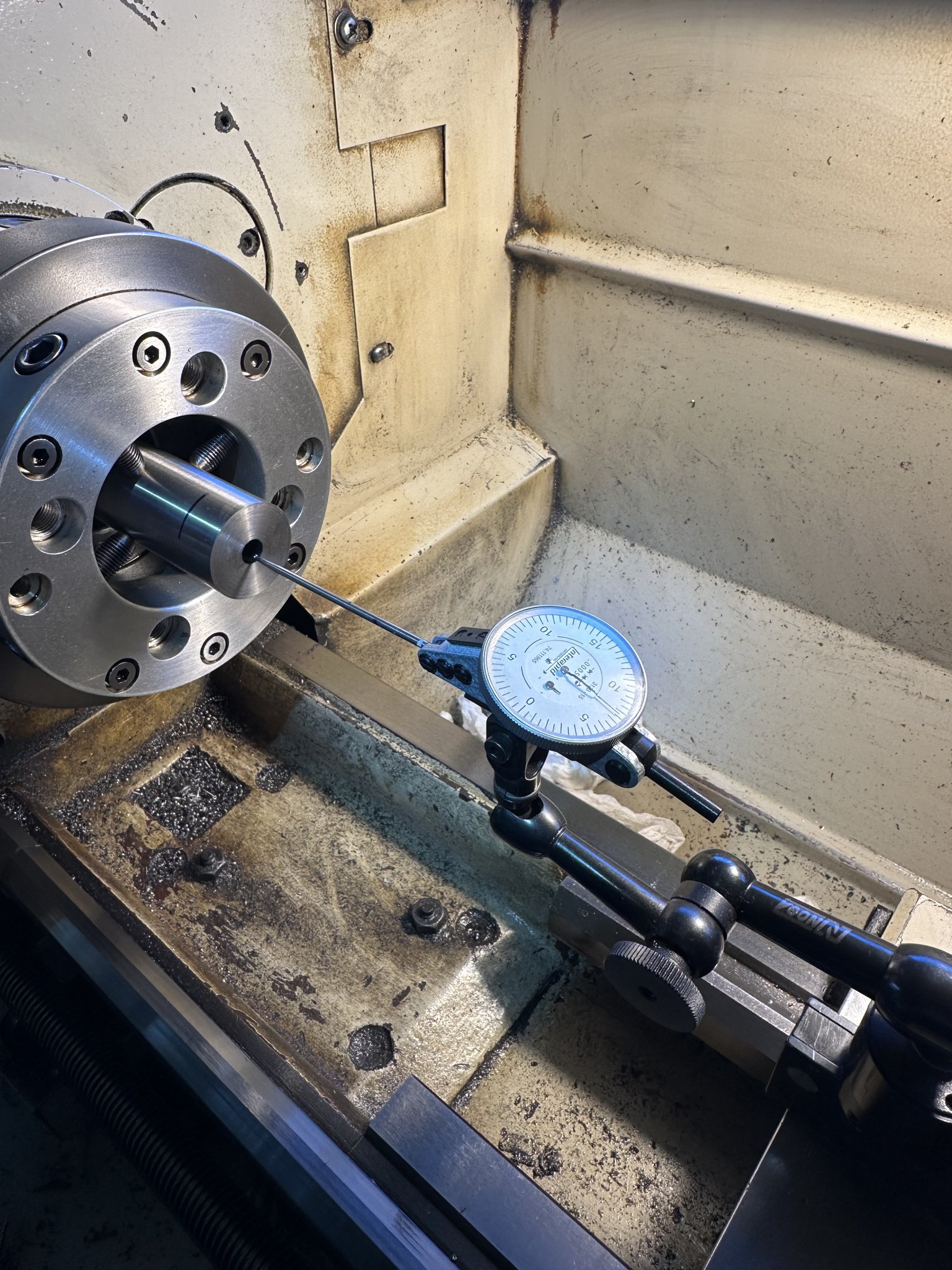

Question:
When you time the barrel runout does this mean that prior to threading and chambering you first determine the high and low in the center of the barrel radially then index the high or low to 6 or 12 O'clock with the receiver.
As an exaggerated example, the large majority of rifle barrels are like a jump rope with more runout in the center of the barrel vs the breech and muzzle end.
With barrel on centers determine the high and low in the center of the blank. Transfer that information to the breech end via marking method, set up once again thru the headstock dialed on both ends, thread and chamber indexing the high, low mark to 6 and 12 to the receiver.
I find this interesting and just want to ensure I'm understanding what you mean by "timing runout".
Reactions: Keith Johns
Ya pretty much. Runout doesn’t always make a jump rope or rainbow shape though, sometimes it makes a ski ramp, and sometimes it seems to corkscrew through the barrel. But yes the goal result is for the end of the bore being worked on to be indicated in so it is as straight as that bore will allow(without bending/flexing the barrel obviously). Sometimes bores are very straight and simply indicating the last few inches of the working end is enough… sometimes there’s enough runout that I have to focus only on the throat area, then pre-bore the first 1-1.5” with a boring bar.
I use a 2.625” long stem indicator to measure the bore, but have dual piloted range rods if needed. I trust the indicator more.
Using an indicator also shows me the exact shape of the grooves, and allows me to read off the lands or grooves as needed(or both).
Then of course the muzzle end of the barrel gets timed so it’ll be at 12:00 when on the receiver.
I also use JGS and PTG floating reamer holders(mostly the JGS holder now). I don’t believe in RIGID reamer set-ups… to be honest I think it’s absolutely insane.
All reamers are from JGS, carbide preferably but if it’s a reamer I don’t think I’ll use a lot I’ll buy HSS… I get talked into buying some dumb reamers sometimes lol.
Oh it’s probably worth mentioning what I find in terms of runout.
Bartlein barrels I must say have been the straightest. BRUX is a very close second and I’m really splitting hairs here. Proof goes through periods of being impressively straight, and periods of being not so straight but still acceptable. These seem to be the best three brands from my experience.
For numbers… I’d say a good barrel has less than .010 deviation from Z axis when measured at muzzle. Average is .010 to .020.
“Bad” barrels to me have .030” or more of runout and in some situations I’ll pull the barrel and send it back when it’s more than .030”.
But, I have to add trying to describe bore curvature with one number like that is a little dumb. As I said I see different shaped, drill movement/curvature/runout, whatever we want to call it. I’ll admit I’ve had curvature that I couldn’t make sense of. I was still obviously able to get the throat area straight, and the muzzle at 12:00 center, but what the rest of the bore was doing was quite puzzling to me. I’ve been through that a few times. I guess what matters, is what matters, and not what you can’t control.
Buy only the best barrels. It is the last component to ever save money on or refuse to wait for the right one.
Button pulled barrels(usually cheaper than cut rifled) seem pretty atrocious in terms of both runout and bore size consistency at the bore ends. I’ve work with some great button pulled barrels but overwhelmingly the cut rifled barrels are better in every way.

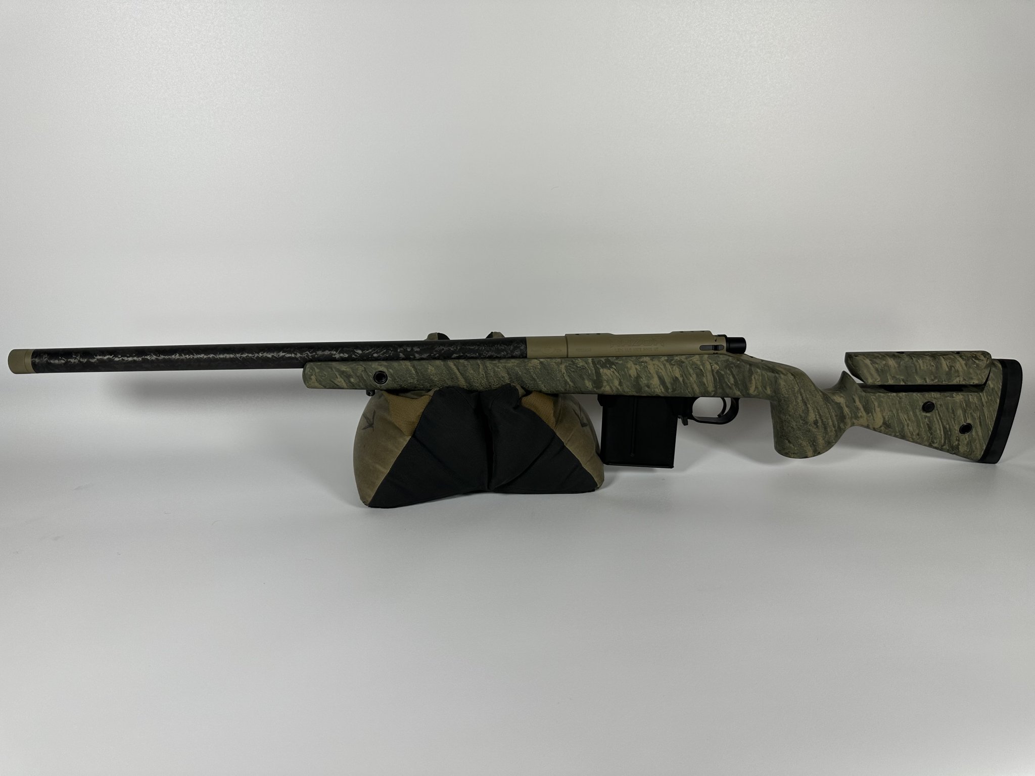

Been wanting to build a M24(ish) clone for a while. I don't think I'll ever go pre-fit again!

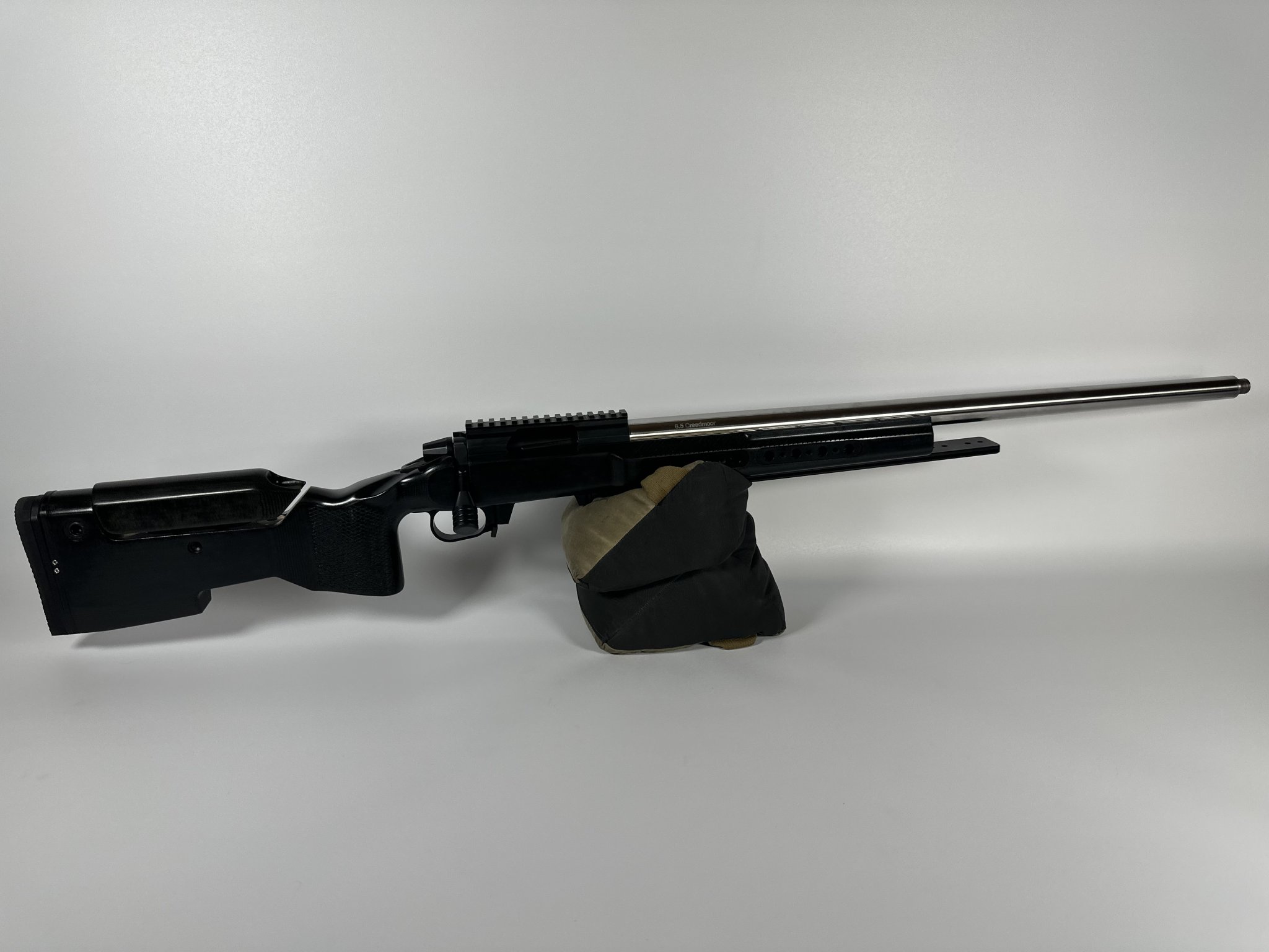

Remington 700 SA/ Proof 24” M24 contour in .308 Blueprinted and spun by PCR
TriggerTech Special (flat)
Custom PCR bolt knob
HS Precision stock inletted for Hawkins M5 DBM/M24 contour and cerakoted by PCR
Nightforce NX8 2.5-20X50 in NF rings

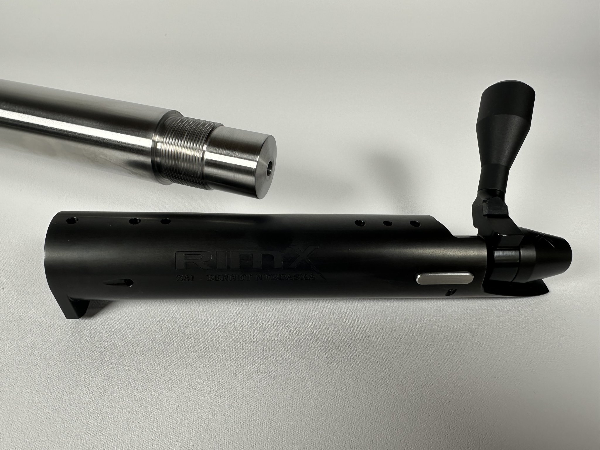

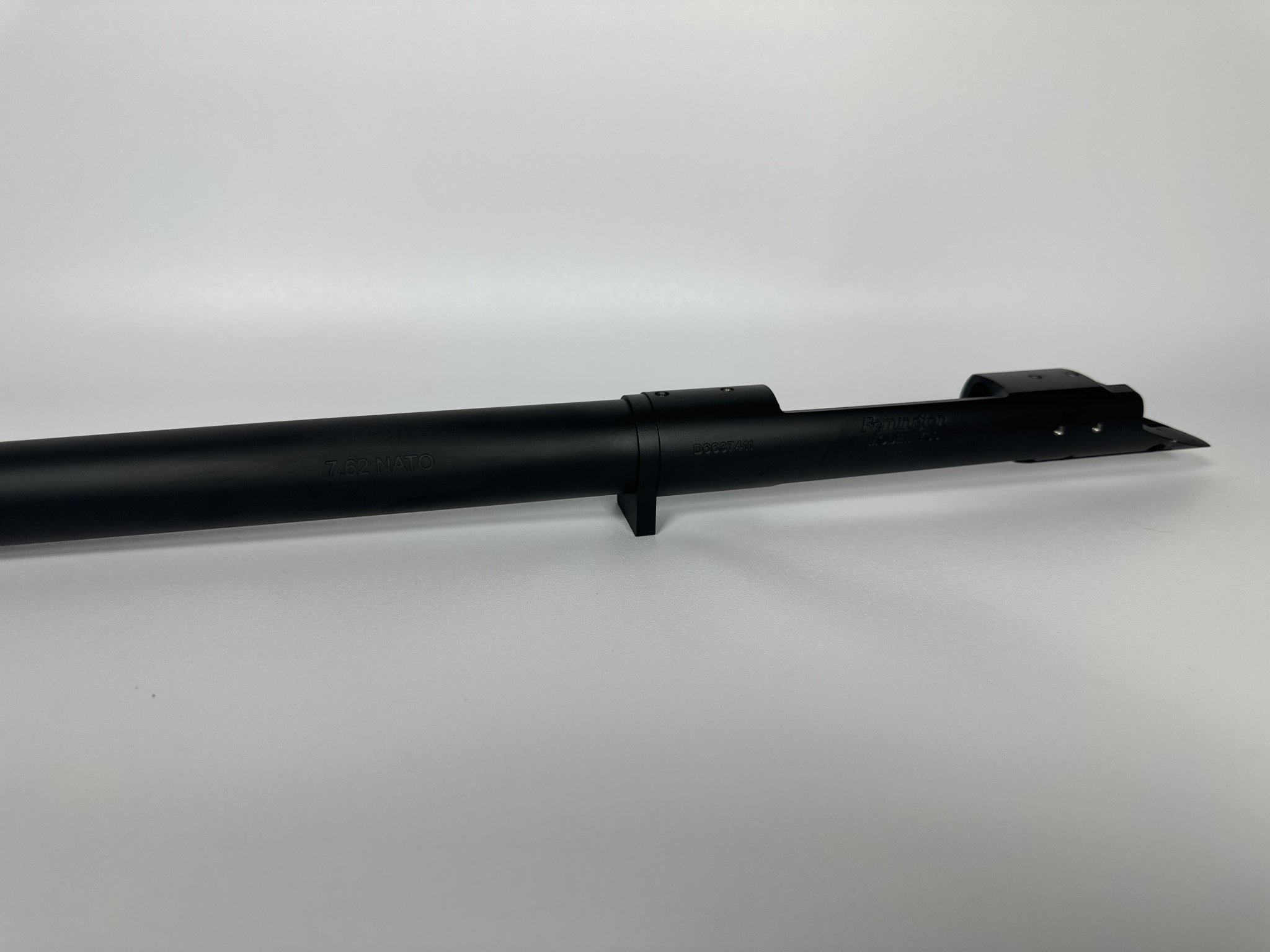

We are now offering prefits for RimX actions.
Chambers are cut with JGS Match 22 Rimfire reamer. Barrels are BRUX M24 contour 1-16 stainless, which ill be leaving 24” after chambering so guys can specify barrel length and muzzle threads(if any) when ordering so they get exactly what they want, with no wait time. I’d expect to ship prefits within 48 hours of order being placed.
We’re building rifles as they come in the door guys… almost no wait time.
BRUX barrels in stock too, from 22rimfire to 338 bore sizes.

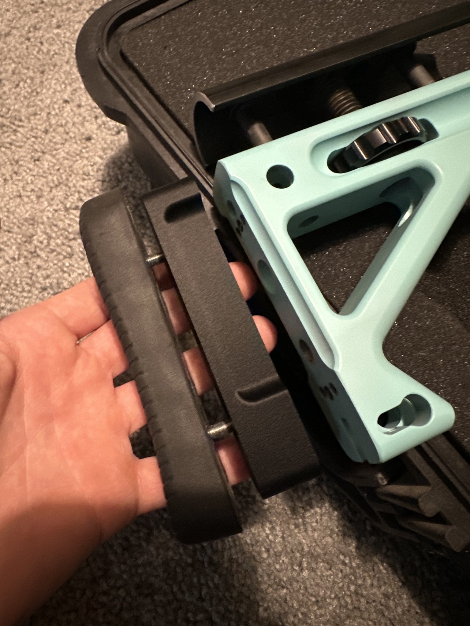

If anyone needs anything for their rifle, that can be 3D printed, I’m happy to give it a go.
Made this recoil pad spacer for my wife’s youth MPA comp chassis. Things like this are perfect to print, rather than making one from aluminum.

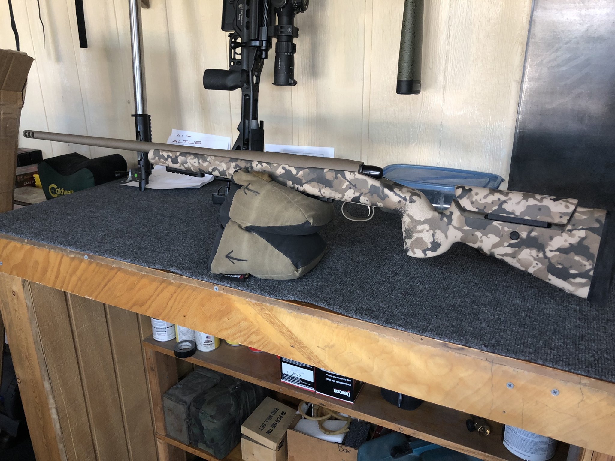

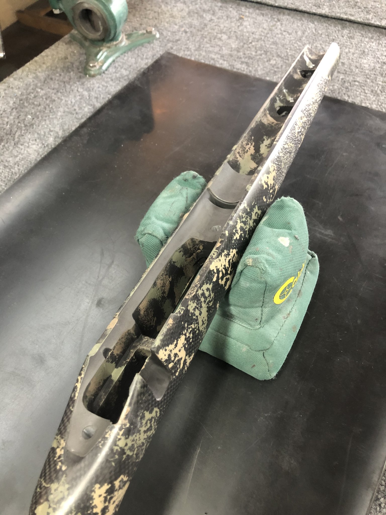

When we bed Tikka T3s, and CZ 22s, both of which have that loose recoil lug that is nearly useless the way it comes from the factory…. We make a new lug from A2 tool steel and replace the factory lug with that. It fits the lug slot on the action perfectly and comes out beautifully with perfect lug positioning.
We just had two CZ22 bed jobs leave the shop that I wish I had gotten some good pics of, but man are they beautifully done.

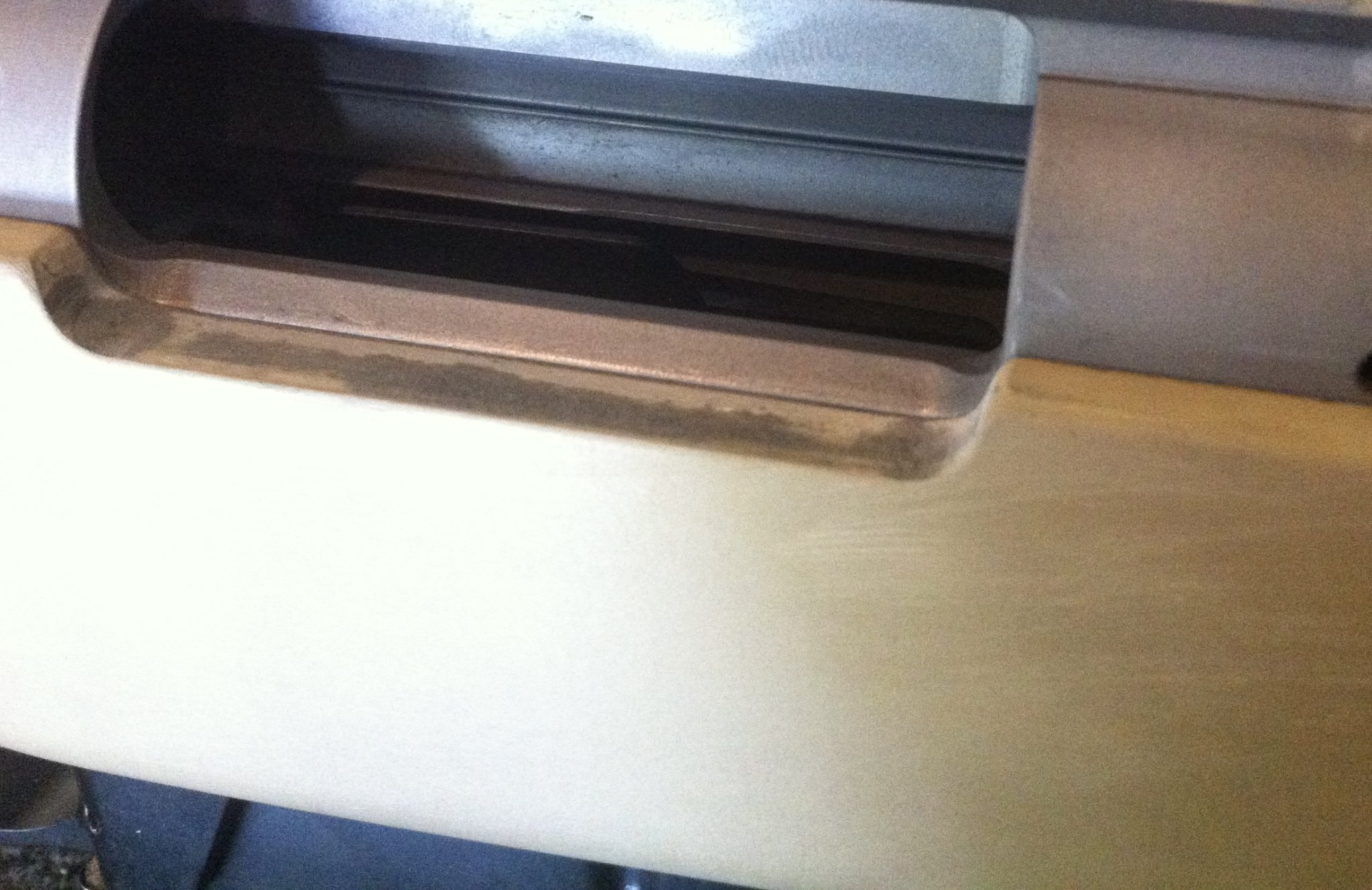

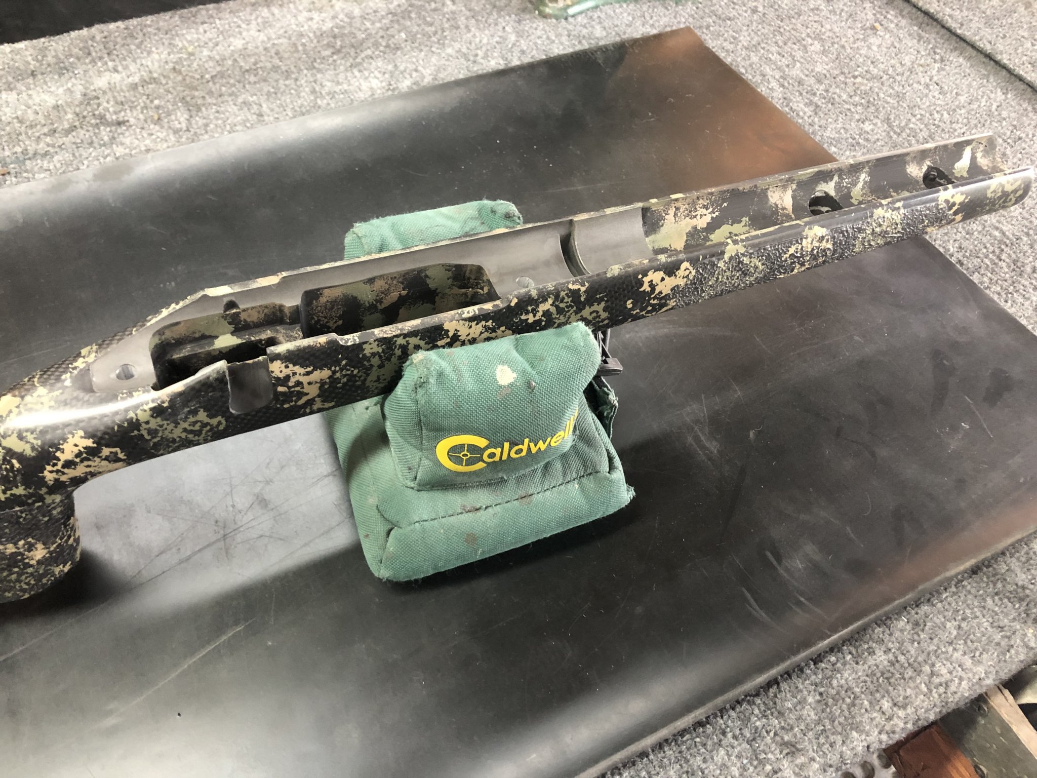

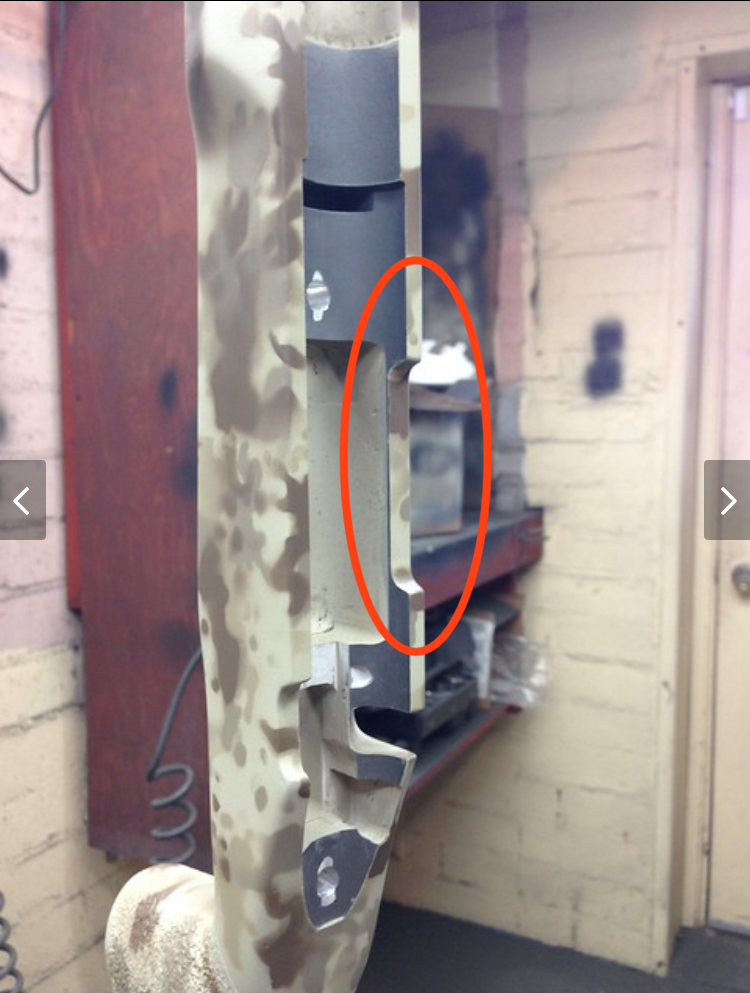

Of all my bedding jobs my PCR looks the best. It’s flawless. Look at the area circled. Even that skinny sliver of stock is bedded.
Everyone talks about “tolerance stacking” well the same goes for ALL the little details, they add up too.

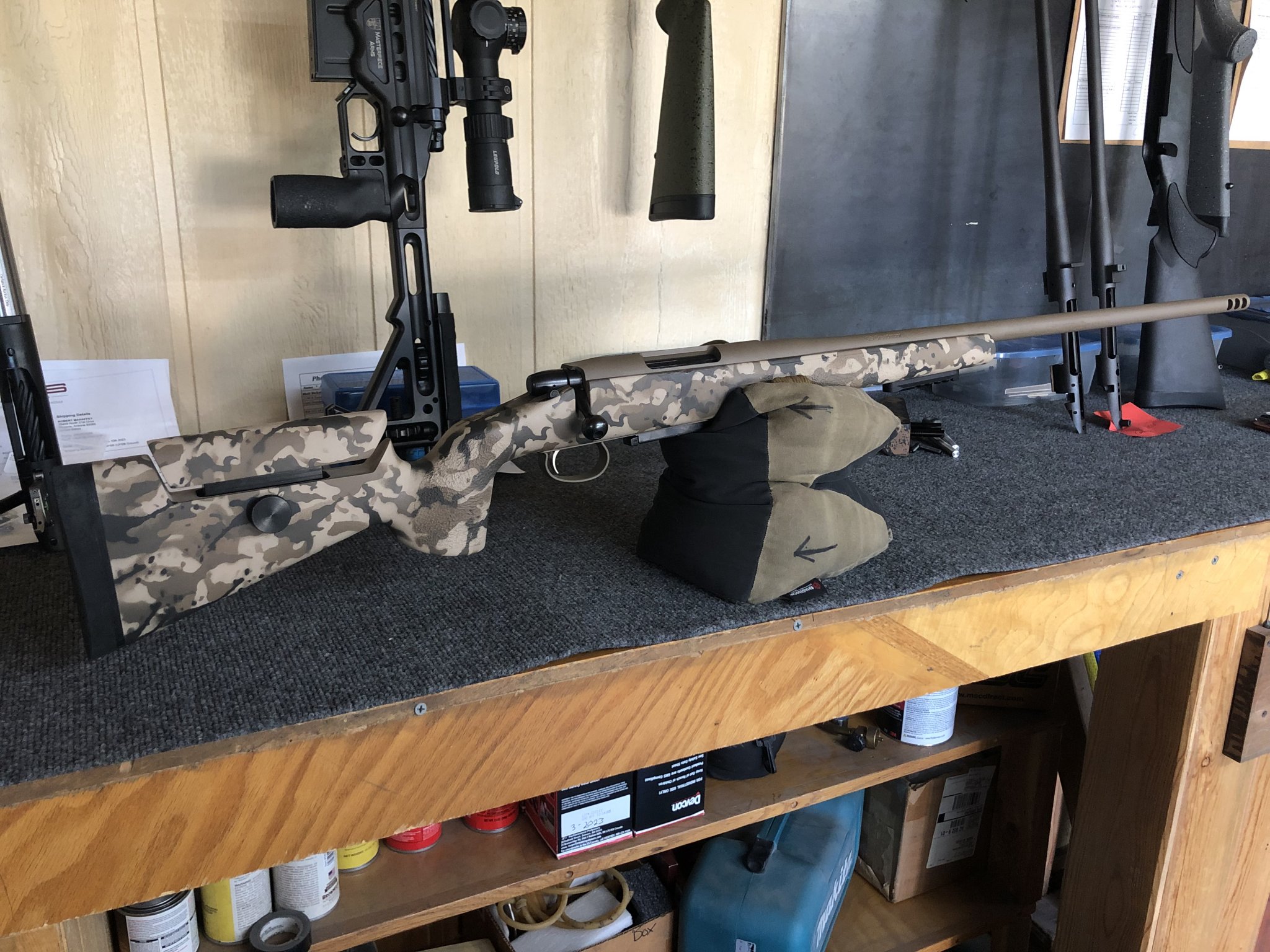

Several years ago Keith did this on my CZ457. Work was impeccable as always.
Took my PCR out, never disappoints me.
I had to look up the build date……it’s been a decade already! I found some old pics of this build. @Keith Johns let me drop in and see how it was progressing. The thing I remember most was all the finishing that went into the stock. The beading, profiling the flat top, pillars, barrel channel, magazine well. All of it cut out by a man and a machine. No computers. I was amazed.
