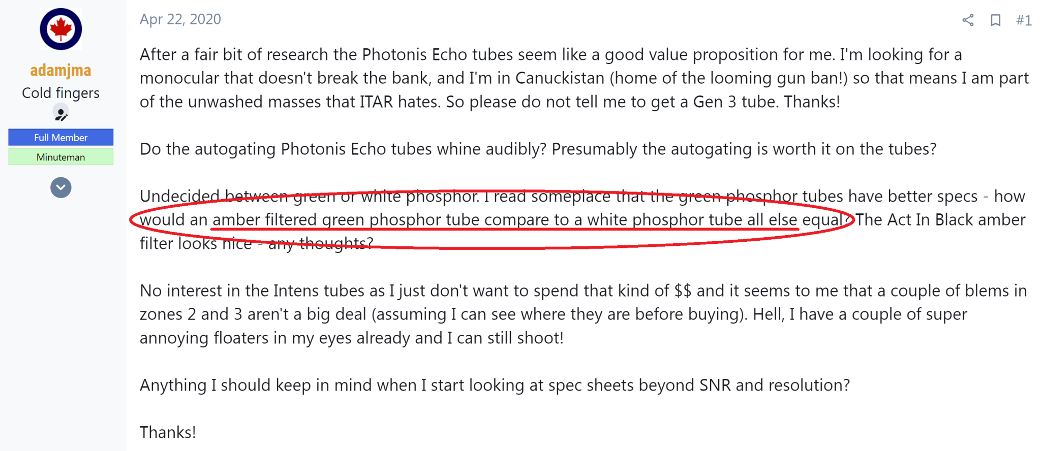

After a fair bit of research the Photonis Echo tubes seem like a good value proposition for me. I'm looking for a monocular that doesn't break the bank, and I'm in Canuckistan (home of the looming gun ban!) so that means I am part of the unwashed masses that ITAR hates. So please do not tell me to get a Gen 3 tube. Thanks!
Do the autogating Photonis Echo tubes whine audibly? Presumably the autogating is worth it on the tubes?
Undecided between green or white phosphor. I read someplace that the green phosphor tubes have better specs - how would an amber filtered green phosphor tube compare to a white phosphor tube all else equal? The Act In Black amber filter looks nice - any thoughts?
No interest in the Intens tubes as I just don't want to spend that kind of $$ and it seems to me that a couple of blems in zones 2 and 3 aren't a big deal (assuming I can see where they are before buying). Hell, I have a couple of super annoying floaters in my eyes already and I can still shoot!
Anything I should keep in mind when I start looking at spec sheets beyond SNR and resolution?
Thanks!
