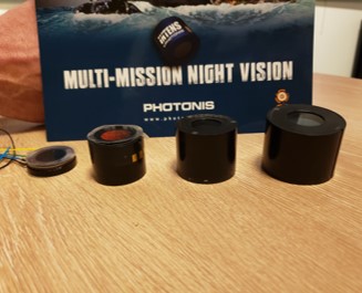

Sure, however, better to judge for yourself. Here it is (edited: photo removed). This is the Photonis Ultimate 5G thin tube, mated to a CMOS (chosen by the government, not us), and held with an aluminum housing. It has a 72 degree FOV GRIN optic lens. As I noted, the performance is incredible. Left to right 18mm Ultimate, 16mm 4G, 18mm 4G Hybrid (on our PD-PRO-Q), and 18mm 4G (or industry standard 18mm size).

Sure, however, better to judge for yourself. Here it is. This is the Photonis Ultimate 5G thin tube, mated to a CMOS (chosen by the government, not us), and held with an aluminum housing. It has a 72 degree FOV GRIN optic lens. As I noted, the performance is incredible.
That’s legit…
