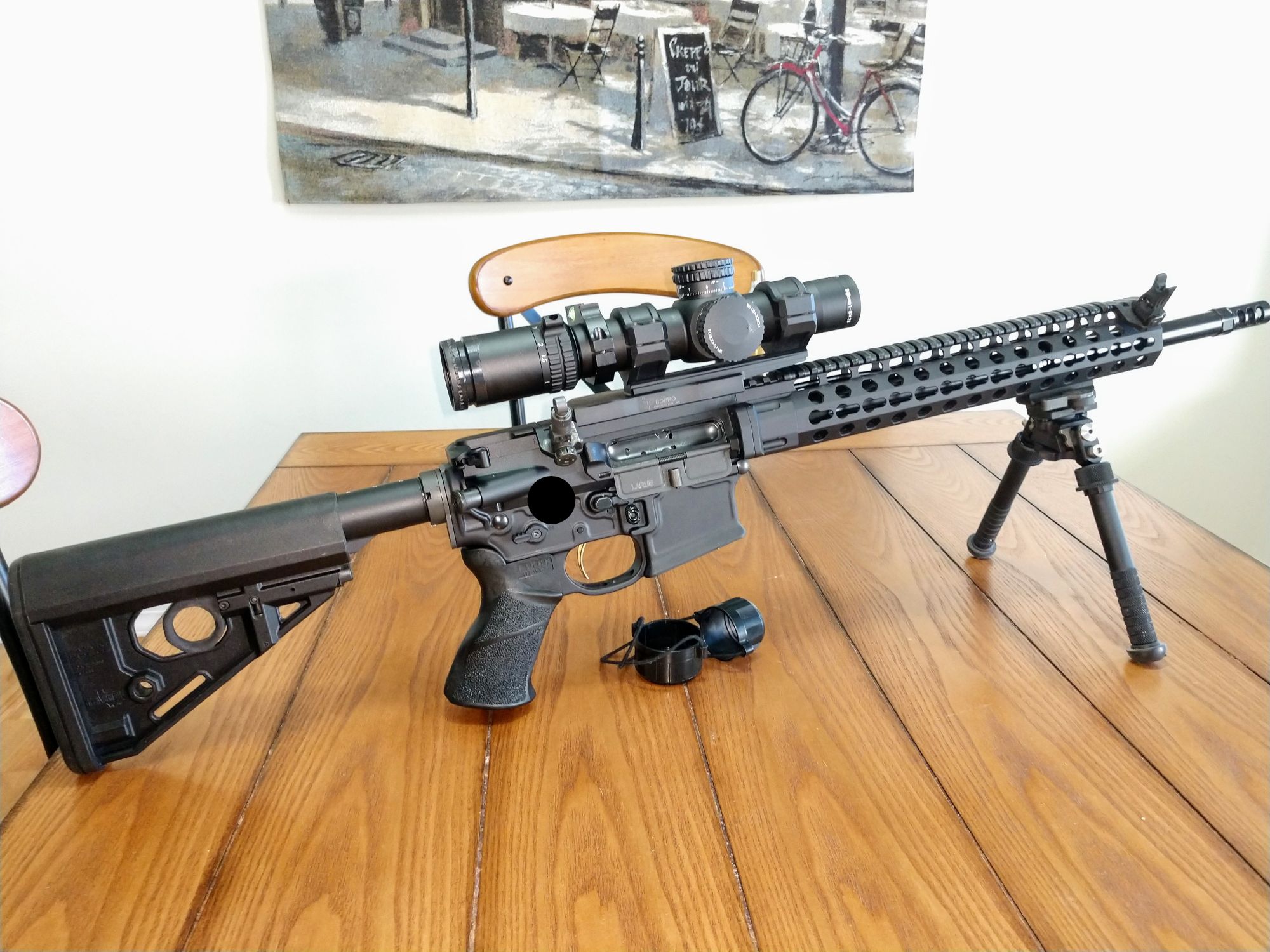

    So I've recently put together a Precision Recce Rifle .25-.5 MOA easy and because she is so accurate I feel she deserves to have a bit more magnification for doing Precision work.
    I was actually pretty happy with the Triji, with the exception of the center crosshairs being too large for shooting groups. I almost switched it out for the Nightforce ATACR 1-8, but even the center dot at 100yrds is 1.25" so still no good for Target Shooting.
    Right now I'm about to buy the new Leupold Mark 5 3.6-18 with H59.
    So here's my question to you all, am I missing a better option?
    If you have some recommendations that fall under these exact criteria please let me know.
