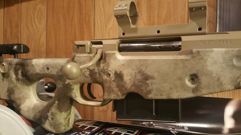

So, here I am with my awesome AI AW .338 Lapua Magnum rifle and ... I could sure use a user's manual. I mean, seriously. I can not for the life of me even figure out how to get the bolt back in the darn thing...does anyone have any video instructions to suggest, or better yet, a link to a user's manual for this rifle?
Thanks very much.

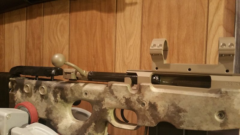

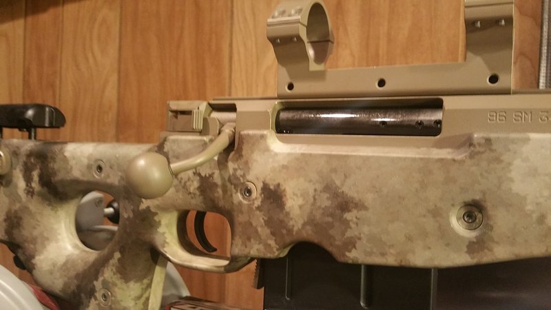

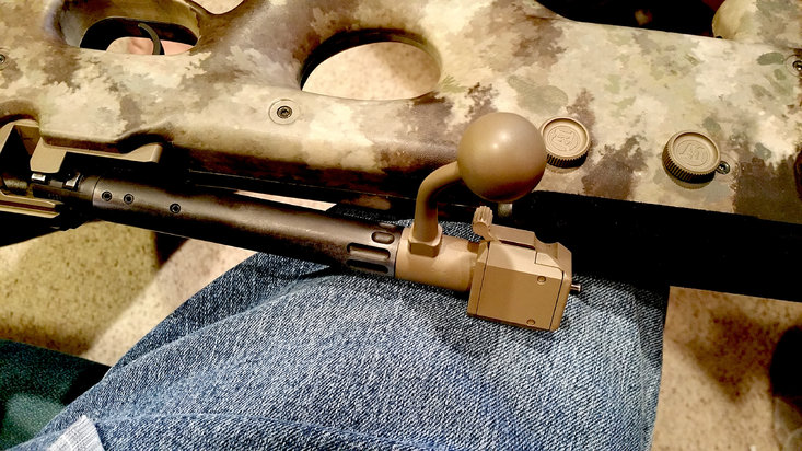

Problem is that the rifle came with the bolt out and I'll be darned if I can get it back in again....
See the photo below for what I am experiencing..can't get it past the cheek piece.
Have you tried removeing the cheek piece?
http://www.accuracyinternational.co...manager/AI-15590-02A USER MANUAL, AT-0i5m.pdf
FIXED CHASSIS MODEL: Loosen the cheek piece retaining screws and remove the cheek piece as described in section 4.3.
4.3 CHEEK PIECE ADJUSTMENTS
The AT308 rifle is fitted with a cheek piece that can be adjusted for height and lateral position.
CHEEK PIECE HEIGHT ADJUSTMENT SCREWS
CHEEKPIECE LATERAL ADJUSTMENT SCREWS
To adjust the height of the cheek piece, or to remove the cheekpiece:
  •  Loosen the cheek piece adjustment screws
  •  Adjust the height of the cheek piece to the desired position, or remove as required.
  •  Tighten the cheek piece adjustment screws.
    To adjust the lateral position of the cheek piece (left and right):
  •  Loosen the vertical adjustment screws and remove the cheekpiece / platform assembly
    from the butt sub-frame.
  •  Loosen the screws holding the cheekpiece on platform, adjust and retighten the screws.
  •  Replace cheekpiece platform assembly in the butt sub-frame, adjust the cheekpiece
    height as desired and retighten screws.
The new AIAT is pretty similar to the AW family of rifles with the exception of the quick lock barrel change. The manuals should be very similar between the two, or you could call AI and have them send you a copy.
Get the cheek piece out and you can get the bolt back in. On the folding chassis, you'd simply fold the stock away but in your case, you have to do the former. It's only a minor inconvenience. Luckily, the bolt rarely needs to come out. Enjoy the rifle!
Is the bolt still cocked or has the firing pin dropped?
If the bolt is still cocked as shown in your picture then indeed remove cheek piece by loosening the 2 thumb screws and pulling out, start bolt into receiver while depressing bolt release.
Something I learned is if you are going to remove the bolt and the design allows it, is to place the safety on. In the AT's case, the mid position. If the firing pin drops, for example while trying to field strip the bolt in the incorrect way, re-cocking the bolt while it is out of the receiver can be a little tricky. Don't ask how I know.
Breaking News!!
I successfully removed the "thumb screws" by "unscrewing" them...the last guy torqued them down with a pneumatic wrench apparently, a pair of pliers later and ... poof ... cheed piece off, bolt easily back in and ... holy cats ... there is no lube on it and it feels glassy smooth and the trigger is awesome!
Oh my...this is one awesome rifle.
Thanks for help and for patiently abiding this fool, and for pitying him.
Photographic evidence of the awesome overcoming of abject stupidity (at least in this one single instance).
The bolt is nestled safely back in place.
