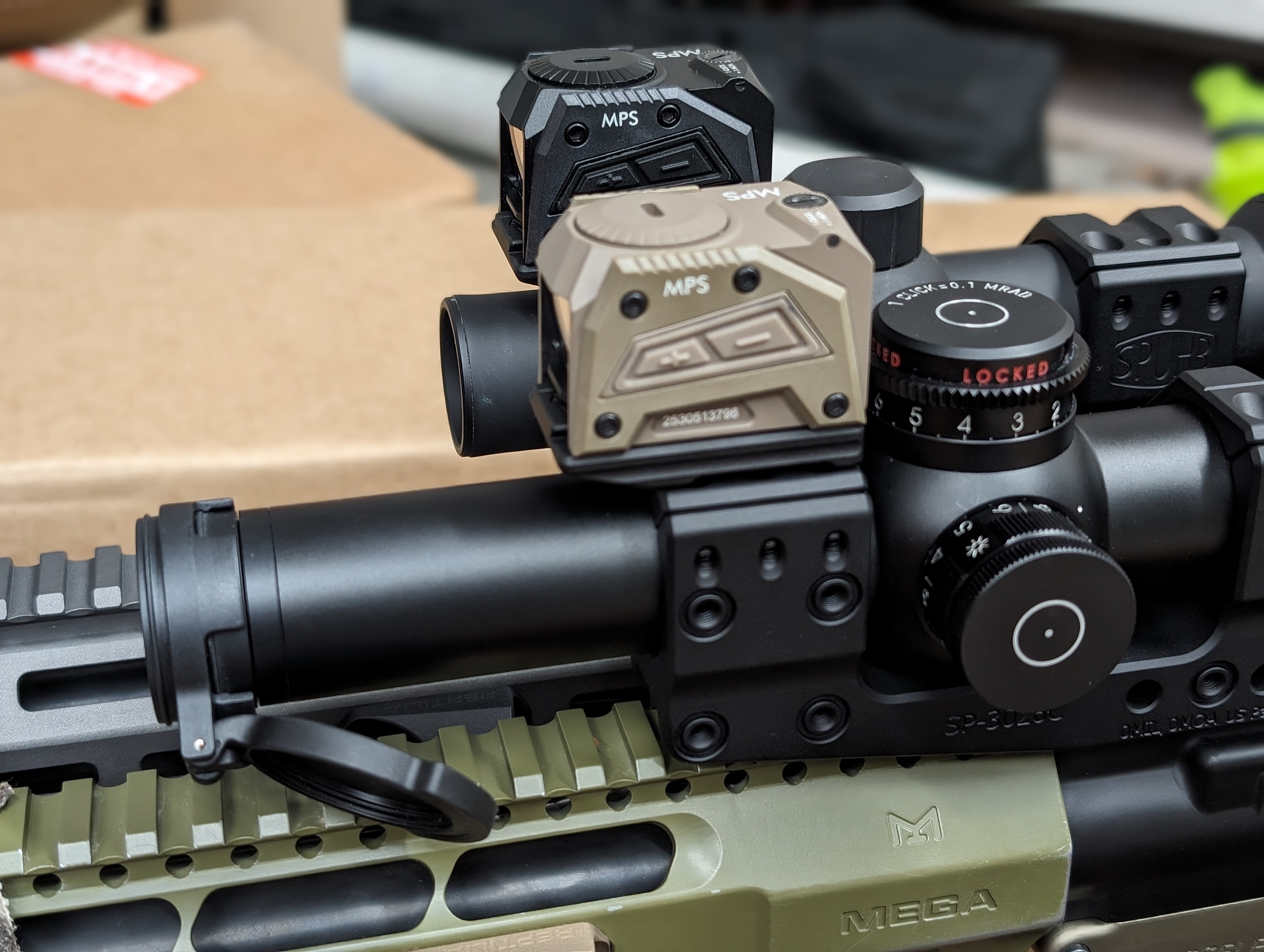

I am not "trying" to sell you anything, but Ive got a new in box 36mm forward cantilever Spuhr mount. I bought it for the ZCO 2-10, but never bought the scope, just thought about it when I read this post. Wasn't really looking to move it because I like to keep mounts on hand in all tube sizes, but I don't foresee using it anytime soon either. (spuhr makes top halves for red dots, a couple pics of mine below:

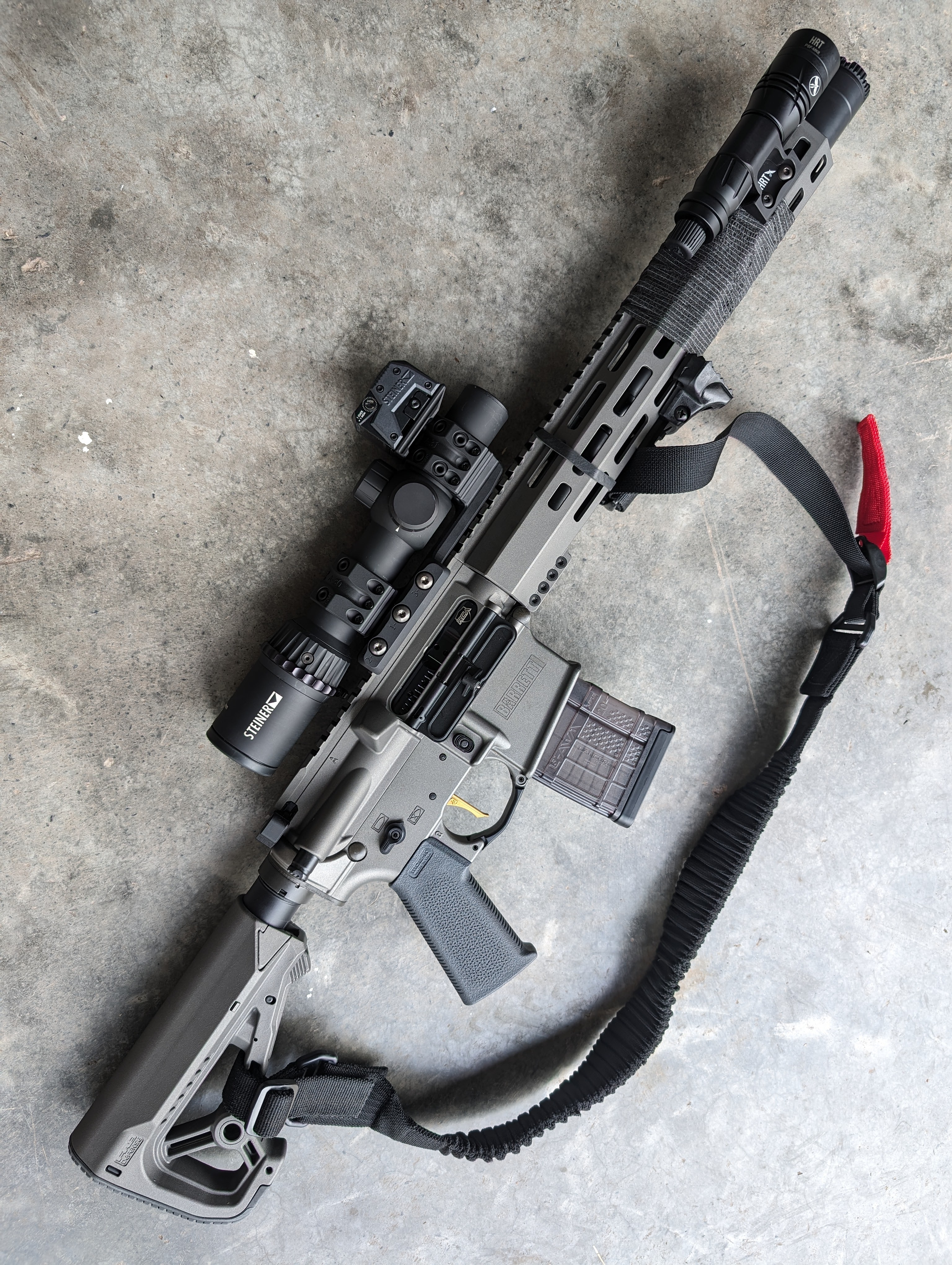

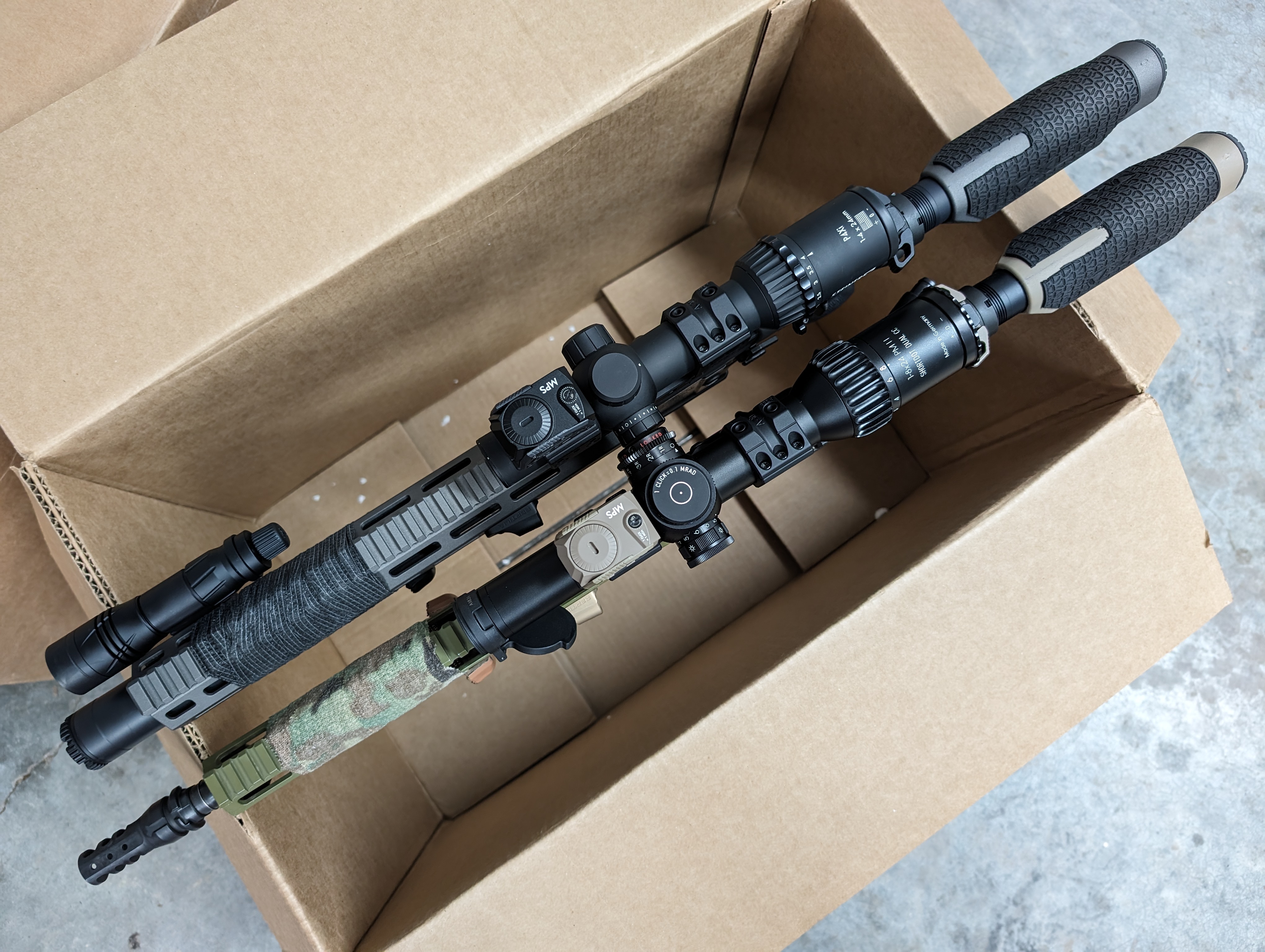

Gotcha. Not sure I would put a Holosun on top of a ZCO just for the sake of principle but if you are looking for an enclosed dot with a circle reticle your options may be limited a bit. As you can see I'm partial to the Steiner MPS as it's lighter and less obtrusive than the ACRO though maximum brightness is about one-half setting lower than the ACRO if that is of concern.

This is why I recommended the Spuhr, its a 2.25 height forward cantilever with a single mount atop the top ring. The Steiner EPS mounts low over the top. 4.0" HOB.
