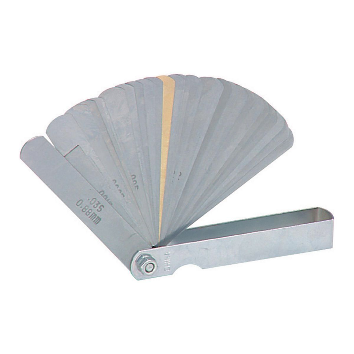

If your rifle has a full length picatinny rail and your scope has a flat on the bottom of the center turret, you don't need plum line nor do you need to level your rifle. You just need one of these:
You stack the feeler gauge blades as needed in between the rail and scope bottom and tighten the rings down. The reticle will level with any quality scope. It's so easy its almost silly.
A 32 blade feeler gauge View attachment 8507068
This is a good method for leveling a scope physically to a rail, but shouldn't solely be relied on for alignment to gravity.
Remember, one should always confirm actual with a tall target test like the video below and adjust accordingly. Otherwise you're leveling just for esthetic reasons (which might be fine depending on application).
