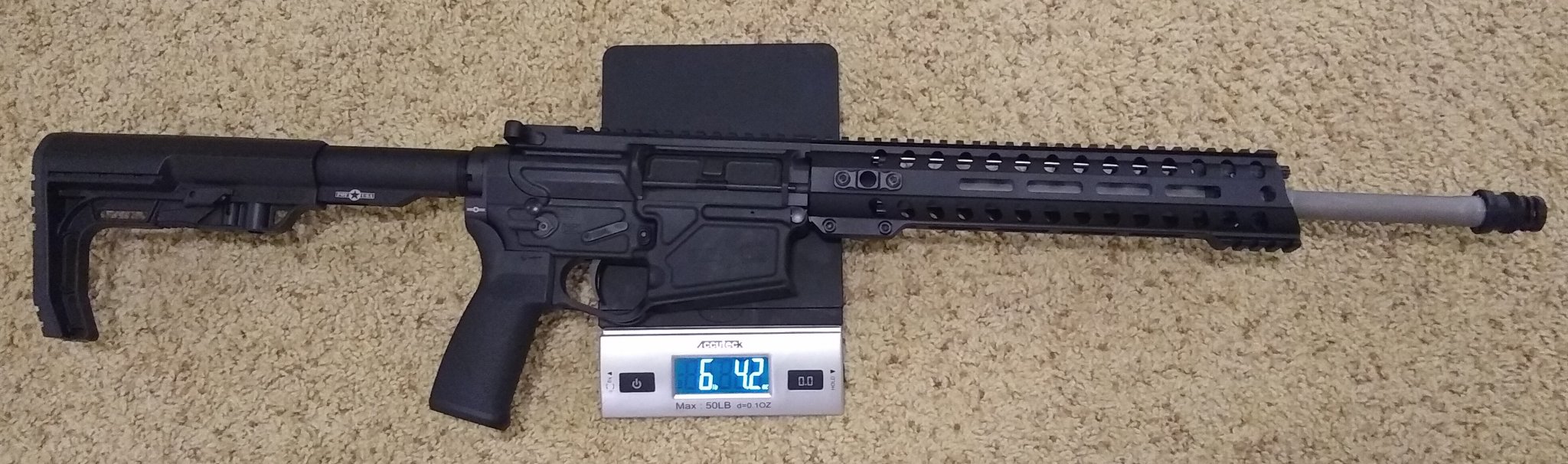

I got my Rogue a few weeks ago, I've played with a few parts and running function tests but haven't gotten my scope yet to start load development (should be here today).
I tried a Superlative Arms gas block first (the cheapo stock block is a real bitch to get off), but I don't think the SA can bleed off quite enough gas to get where I wanted with my Nomad mounted. It ran fine in all cases, but was a bit rough on brass. Now I've got it set up with a Dictator block and an H2 buffer, if my scope gets here today, I'm planning on running my first bit of load development tomorrow with 165gr TBT and 168gr ABLRs (it will be a hunting rifle).

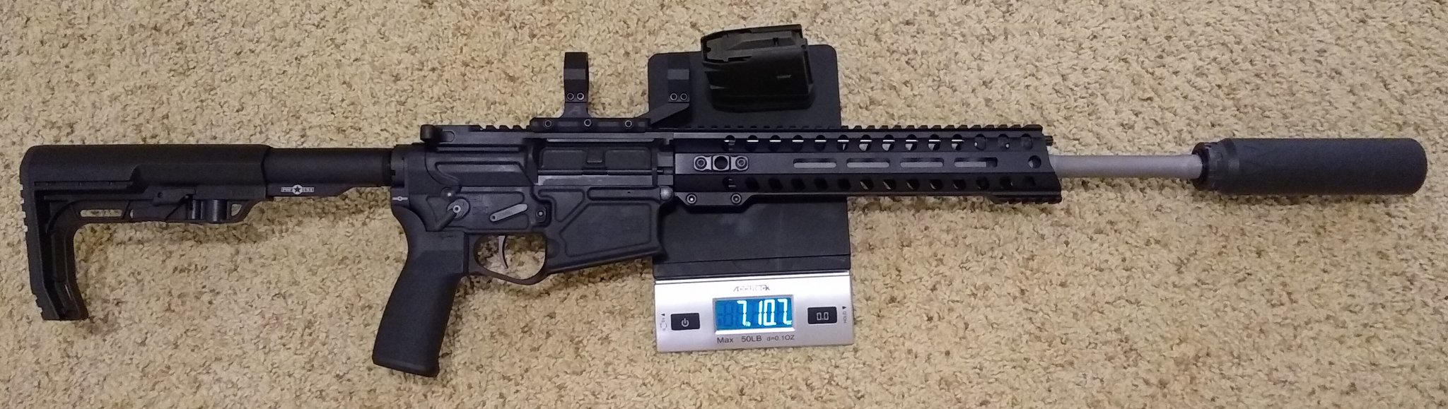

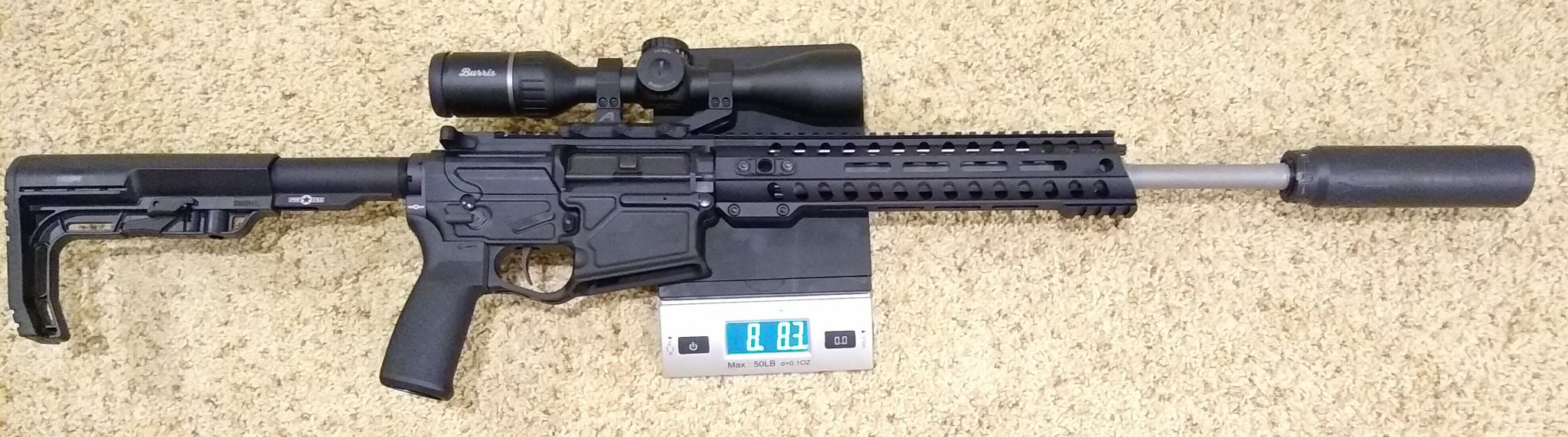

It gained about a quarter pound with my additions:
Should still be less than 9lb after I add my scope, but before bullets and sling:

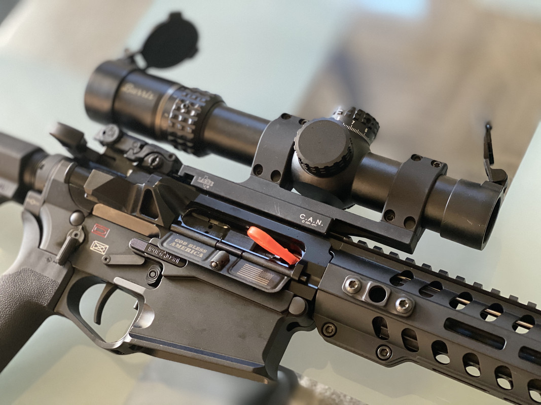

Sure enough, the POF was shipped and I went and picked it up just a bit ago. Gave it a good look before accepting but it's all there. A bit surprised it doesn't come with a hard case but I knew that before purchasing. Will be hitting the range this weekend despite my scope not being here. I'll take the 1-4x FFP off the AR15 or shoot with the Magpul Mbus sights I have lying around just to get used to the gun. It's operation thus far is super slick, much better than my low-tier but solid AR15 (Del-Ton).

Got out to the range this morning to shoot with the POF Revolution DI as well as my AR15. Needed to dial in a new 1-4X FFP LPVO scope on the little guy (Bushnell) and of course wanted to get down and dirty with the 308.

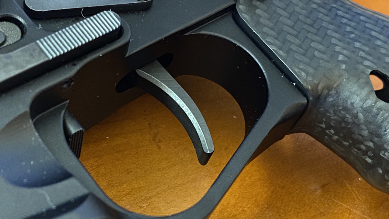

Trigger. The AR15 is just mil-spec but I don't have any problems with it and actually rather like it. The POF is significantly lighter in pull but I adapted quickly and I can see how it will/would make my shots more accurate. I know some replace the triggers but I can't see myself doing that until I gain substantially more experience. It does, at the very least, give me somewhat of an indication and reference between an ok/solid mil-spec and a much more precise trigger like the POF.

I finally caved and swapped the factory stock out on mine today. Had a spare Magpul CTR so going to run it for a while. I tried to get comfortable with the factory stock but it just did not feel natural for me. All I can figure is the curve at the bottom is causing the issue as other than that it and the CTR are pretty much the same.
I put the Calvin Elite trigger. I think its 1.5lbs?

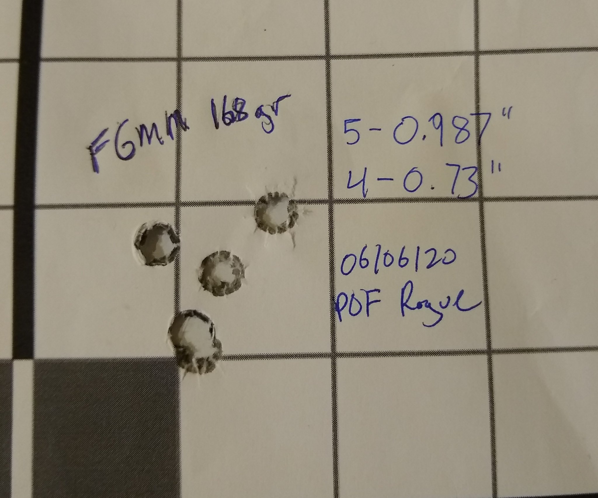

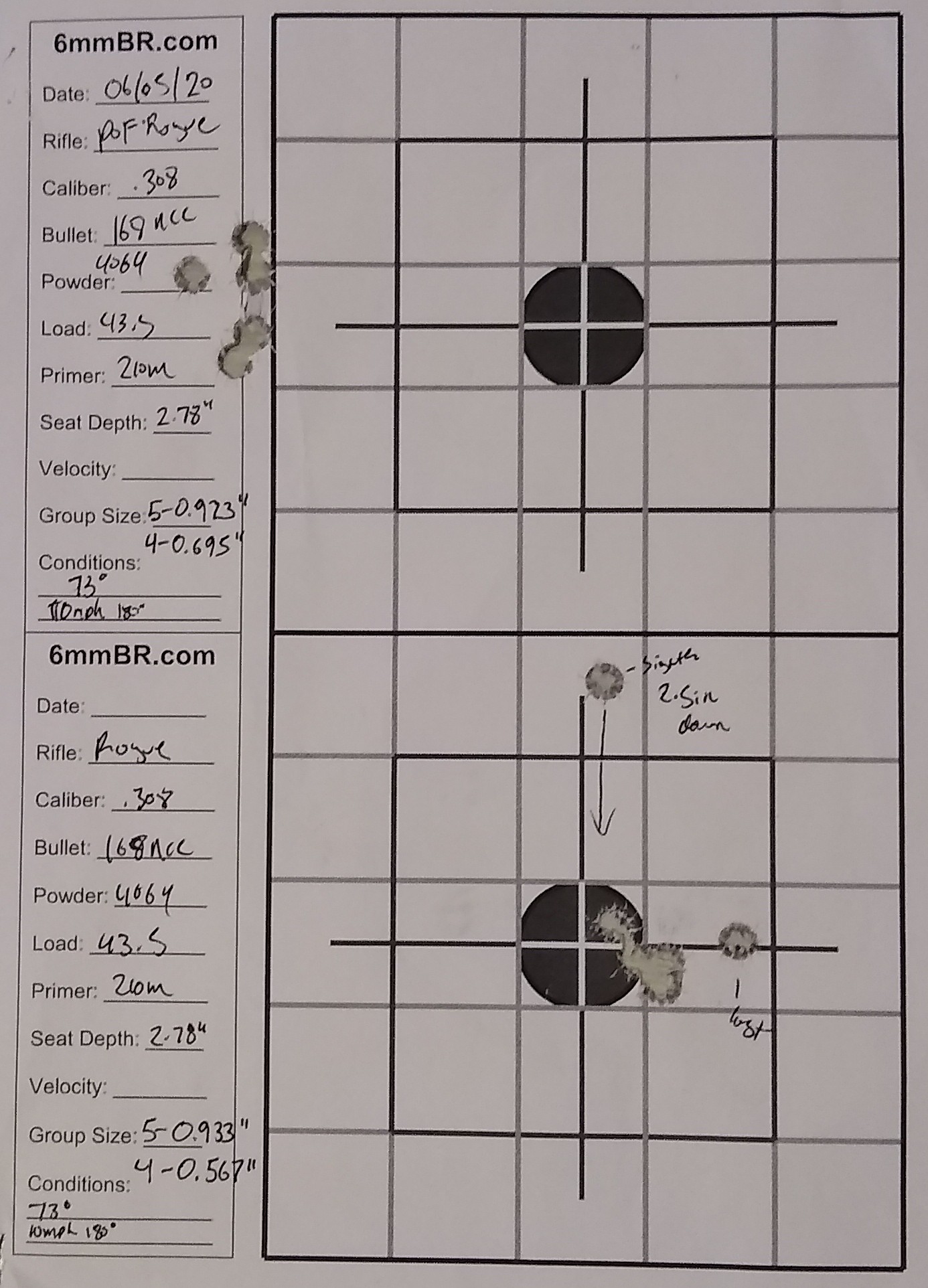

I've been loading for the Rogue a bit and I can say that I'm hitting pressure sooner than other .308s I've had. Brought some velocities back and with Quickload dialed in it looks like pressures were just too high, even though I was a grain and change below book max on some of the loads. I know that can happen, I've just never run into it like that. My Rogue is rough on brass with the can on, even factory FGMM and Federal 165gr Accubond get chewed up a bit with an H3 buffer and a Dictator gas block turned down. Might just be the nature of the beast.
It does seem to want to shoot though, especially for such a lightweight rig with a weirdo twist and a mediocre shooter driving it.
Factory FGMM 168gr.
This was just an FGMM clone load I made up for my last .308 shortened to fit in the mag. I quickly loaded up 25 just to use while tuning the GB because I knew they were on the lighter side, but it wound up liking them pretty well. Velocities were only about 2,420 fps on these, I'm hoping for about ~100 fps more with my 165gr/168gr hunting loads. (Changed the scope location between the top and bottom groups.)

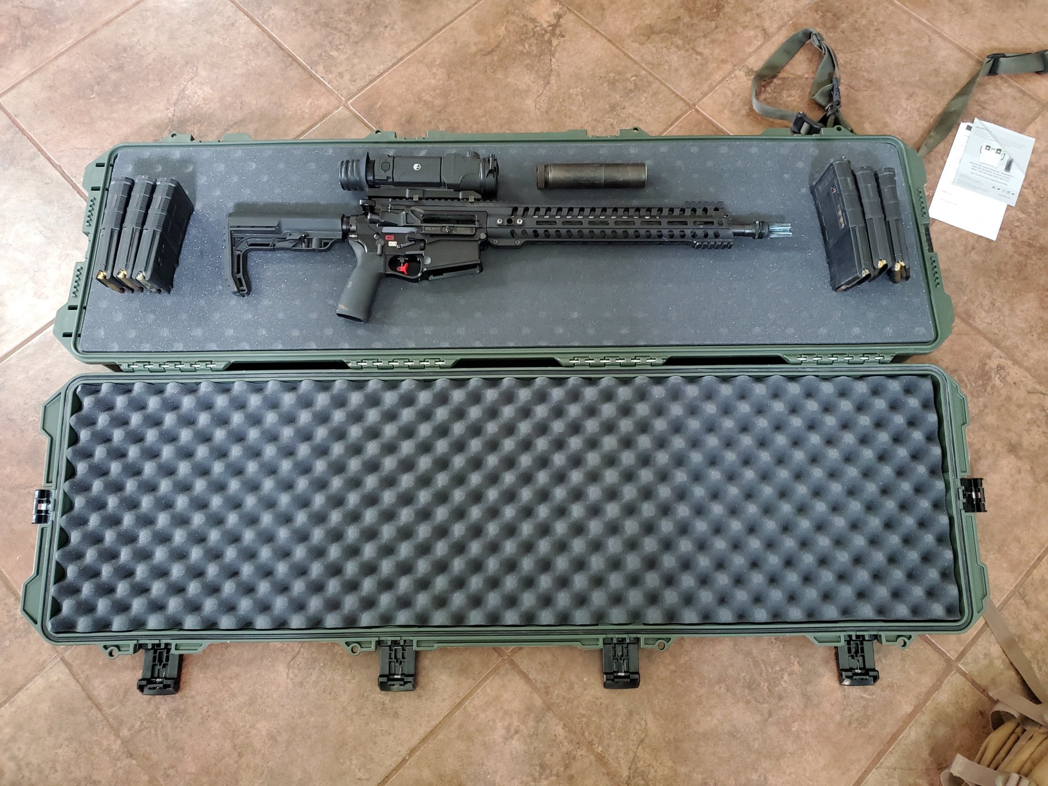

just got 12.5" Rogue pistol today . put cherry bomb on and silencerco Hybrid with plan B ( Trash Panda didn't put on tonight). shot great with and without can . it did crimp up necks on 2 of 5 casings. shot federal fusion msr 150 grain . just took out to see if would cycle with can. i have dictator block in also , may wait till after hog hunt to put on and fight that staked battle. a very light pistol . i have a 10" 300 blkout i built that i currently use since is 5.2 lbs without hardware . boy it doesnt kick anything like the rogue though!!! will have to sight with Pulsar thermion XP50 Thermal this weekend
https://lh3.googleusercontent.com/Q...fvVogDsEOW-oLSjZmrDg=w1250-h937-no?authuser=0

I've now had two rounds at the range with the Revolution DI and the Burris 1-8x24 FFP. First round was a nightmare trying to figure out which way to go with the scope to dial it in. Wasted a lot of ammo. I purchased a laser bore sighter (Site Lite Mag) which had me on paper immediately, first shot, on my second visit to the range.
The first time out with the gun/scope, I noticed strange marks on the bottom of the casings which I learned was "smear" and it'll apparently disappear as I use the rifle more. I did not make any adjustments to the gas on my initial outing. Some suggested it was due to hot rounds and I was over gassed but these are "factory" rounds and not what I'd consider hot. Ambient temps were in the 90 degree range that day but I was in the shade. I've reached out to POF but haven't received a reply yet. Going by the experience of others, it appears this is normal and will go away as the gun breaks in. Here's a photo, can see the marks at approximately the 3 and 9 o'clock positions on the right and middle casing. Sometimes there's a physical burr that you can feel where I think the extractor has dug in. It's a little less pronounced now and most it's just a superficial mark, can't feel it with my finger.
Anyway...first thing I did was go through the process of dialing in the adjustable gas block which I did not do the first time out. One round in the mag, firing, closing the gas block one notch per round until the bolt locked open. I added one more click and watched for ejection which was at 4 o'clock. Left it there for now.
Dialed her in at 50 yards and could practically put the rounds on top of one and other once I dialed in elevation and windage. Moved out to 100 yards, a bit more of a challenge but could still produce small groupings with PMC Bronze 147gr ammo. The PMC was the least expensive "decent" ammo I could find and I think, with shipping, it was around .50 cents a round.

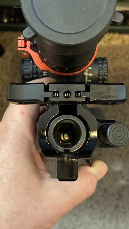

One thing I've noticed is the eye box gets very small at 8x on the Burris. It's really a learning process to get into the right position quickly. I like the reticle and as much as I "think" I'd like (and wanted) the Primary Arms ACSS reticle, I'm pretty darn happy with the Burris and it has a lifetime warranty on both the electronics and the mechanicals. Plus it's reticle is very similar to the Bushnell 1-4x FFP on my AR15. I'd convinced myself to move up to the PA PLx 1-8x24 but being out of stock for the foreseeable future, the Burris was a no-brainer with Japanese glass (I consider high end Japanese glass/coatings better than German, controversy!) at a less expensive price to boot. But I wonder if I'm under-scoped for deer hunting out to 300 yards? Probably just need more practice with the 1-8x. I did notice the glass was susceptible to flaring but this is almost unavoidable without a shade. I lost a it of contrast but everything was still perfectly legible. Oh and I did try the illumination and both the Burris and the Bushnell were daylight bright.
This was literally, my fourth time at the range with any rifle so pretty happy. I know I still have a lot to learn and while I was able to knock off six to eight rounds quickly and on target (within 4 inches) I know I'll get better with more range time. The POF was consistent the entire time. I went through 60 rounds pretty quickly after dialing everything in and it didn't seem to change as the barrel heated up. Shoots like butter and easily more on target than my AR15 shooting rapidly. Recoil feels almost identical between the two. Using a 1-4x FFP Bushnell on the AR and it's a bit more nebulous at 100 yards with the lower magnification. Again, probably comes down to practice, practice practice.
One thing I realized this time out is I now HATE the AR15's trigger. I don't know if it's become spongy with use or what but it was far less predictable where the POF's trigger was telepathic, maybe even touch too light given my experience level. Will most likely swap in a POF trigger on the AR to keep them consistent rifle to rifle.

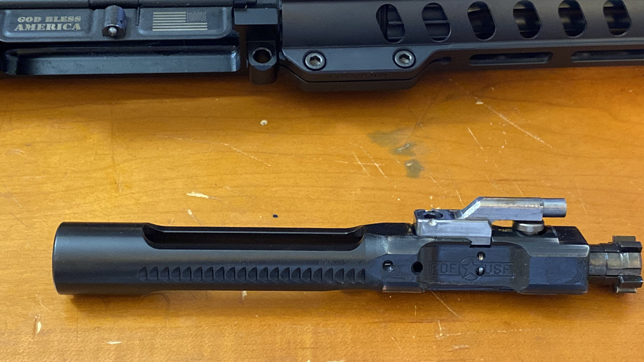

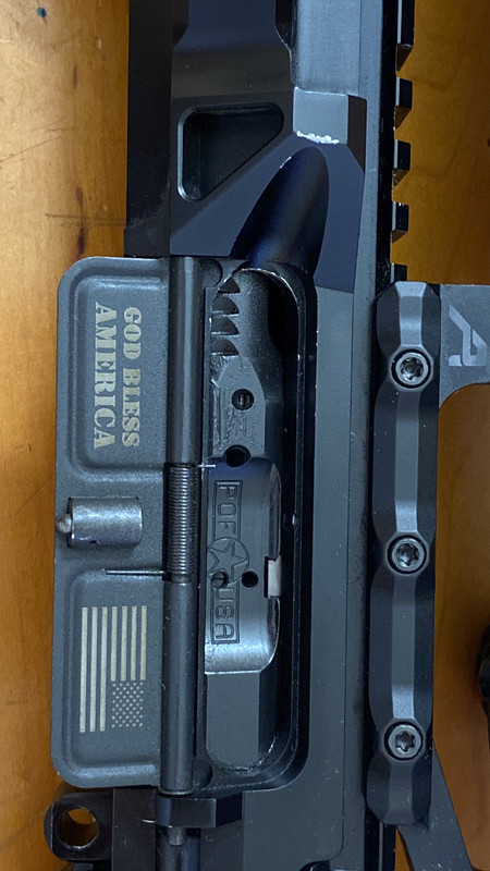

Yeah, my Rouge doesn't run at all, sent it back on my dime, New barrel. Still doesn't extract at all, tears up brass. They suggest a 500rd break in and that they likely won't do anything if I send it back. Seems to be tuned to only run wolf and not quality ammo. Also not impressed with the poor machine work on every part.
Neat idea, poor execution.

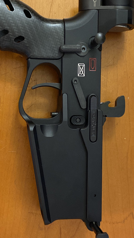

Kinda surprised on the poor machining comment. I stripped my Revolution DI down and I was actually quite impressed with the machining and precision of everything. To date, I have zero failures to extract and it shoots everything I throw at it save for some heavy Remington rounds. I've actually never shot steel case, just brass case, PMC bronze being the cheapest and it was pretty darn accurate. Major difference between the two is the barrel, hand guard and adjustable gas block. Can't see the ambi-controls having any sort of effect in that regard. But very sorry to hear your experience, hope they straighten it out.
Sorry you’re having issues with the rifle...I know that can get frustrating.
Could you elaborate (pics would be great) on the poor machine work you’ve noticed on your gun? When POF came out of the gate, they quickly developed a reputation for absolutely *impeccable* machine work. That solid reputation was still accurate at the time of my last POF purchase, a 2018 Revolution which truly is a machinist’s dream, and even looks great under a jeweler’s loupe.

They were less than stellar when I purchased two of their piston rifles, one in .556 and one in .308. Both had bad head spacing and my .308 got a round stuck in the chamber. Could not get a call back or any response from their customer service over at least 4 weeks of calling them, and leaving messages and also emailing them. My local gunsmith just happened to be going to Arizona for a match and he was kind enough to drop them off at their door. Kinda soured me on POF. You spend that kinda money on a rifle, you expect it to work, and at the very least for them to remedy their mistake. The only plus side was this was during the last gun ban scare and I immediately sold both rifles as soon as they were fixed and actually got more than I paid for both. The rouge looks interesting to me and all, but I’m pretty skeptical when I hear POF. The machining looked fantastic on the three I have owned, but it’s a gun, not wall art, first and foremost it should function reliably. Not gonna pay that kinda money for a 50/50 chance at getting a good one personally. I can forgive mistakes, but it’s how they handled the issue or actually the lack of handling it that gets to me.
Finally getting back to this. Today's testing didn't go great. Steel case extracts, like they claimed, pmc bronze doesn't have to be mortared, but won't extract, and any hunting load I've found needs to be mortared, and there are deep marks on the rims of every case from the extractor yanking on a stuck case. Great. The outside of the rifle looks fine besides burrs and sharp edges on the trigger and what appears to file marks below the anodizing, so that's strange. Inside is when things go down hill. Many steps from either poor programing, tool offset, or fixturing. Burrs on the bolt carrier. Chatter on every part, even the feed ramps. On the surface, these seem like minor things, but it's a lack of effort, or a "good enough" mentality. These are also cutting issues, so unless they're putting every single part through a cmm (unlikely on large scale production) they're measuring a limited number of features on each part, and the tools likely aren't cutting consistently around the parts. It just adds concern. The gun is also beating itself to death and rolling a burr on the ejection port, and gouging the cam pin. This gun with 60rd looks rougher than my ar15 with 5k.
Man, have to say that sucks. You must have received a Monday gun or they're cutting back on QC for the Rogue to get it at that price point.
I now have about 1K rounds through my Revolution DI with only one self-induced hiccup while I was testing something out. Brass wear has significantly reduced (very light smearing if at all now) and I mostly continue to run PMC Bronze. I'll be switching to a 150gr and a 167gr round shortly.
After reading your post I was pretty alarmed to say the least so I took a hard look at my rifle. Any dings on the gun I've done myself except of course for the case deflector and port door which has some marks from shooting. I didn't find the same issues you did and I'm guessing our rifles were probably made around the same time as mine was purchased a few months back.
