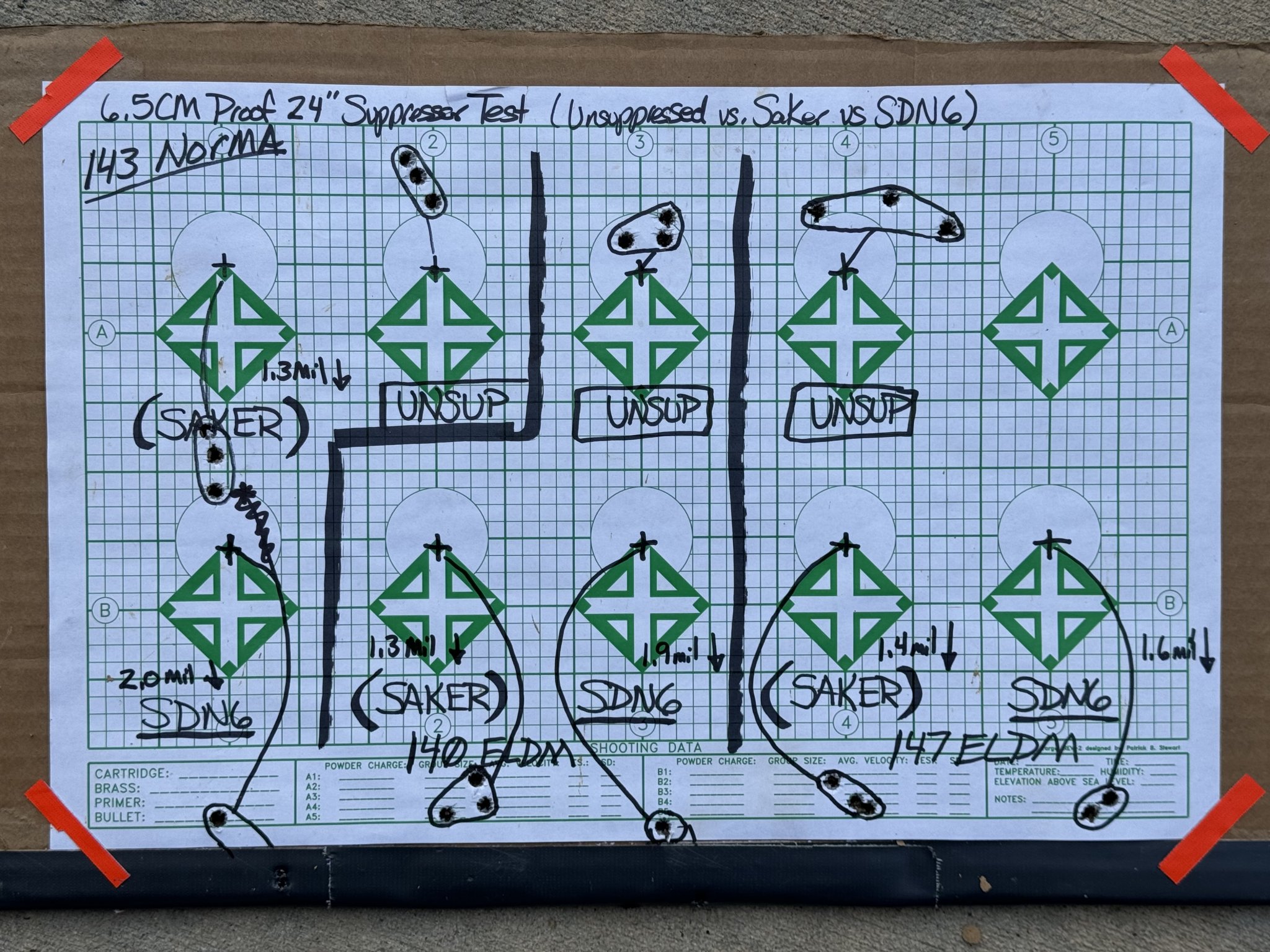

    I ran the same experiment with my 24” 6.5CM Proof CF barreled Aero AR10…
    AAC SDN6 that’s been Ecco’d with a Keymo HUB mount & Silencerco SAKER with a Keymo HUB mount.
    Basically 1.3 MIL shift down for the SAKER and 1.7-ish MILS for the SDN6!!!:LOL:
    Tested using 143 Norma, 140 ELDM & 147 ELDM factory ammo… the black sharpie cross is the POA.

    Interesting. I had my 7.62SD Ecco’d with the A419 Hellfire mount and it’s repeatably 1.3 MILS down with the suppressor on vs the brake. That was with a AR10 16” Faxon Gunner weight 308 barrel. Your results are very similar.
